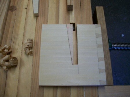

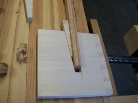

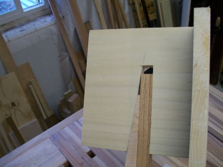

I made a birds mouth plane stop out of scrap today. Just wanted to try it out and first impressions are good.

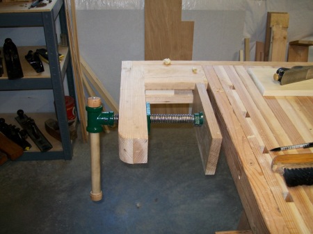

Very nice. I have a similar stop although it is not dovetailed. I use it everyday and seeing yours makes me want to upgrade. Also, looks like you have a shoulder vise. Is your bench homemade? I would love to see some pics.

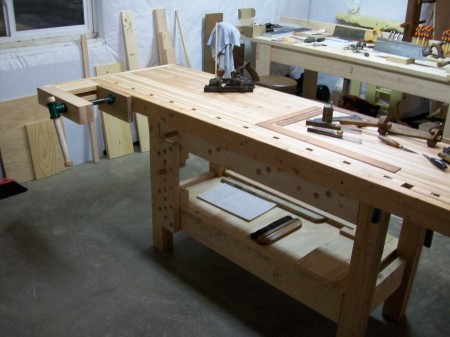

Adam I have a shop photo album on here that has some bench shots. My bench is homemade I loosely followed a plan from a woodsmith magazine and a few ideas from a Workbench book.

When I first saw your birdmouth, I was thinking that grain is going to split when you drive the piece in. But if you had made it so the grain was parallel to the work being inserted, it surely would split. How much pressure do you use to set the work piece, or do you just set it in and let dynamics take care of the rest?
John I just slide it in and add a little pressure with the wedge. the planeing action may tighten it up. I have seen examples with a couple dowels to add some strength that makes me think it can or has split on the maker. I like my bench hook I made; nice to be able to saw at the bench without risk of cutting the bench.

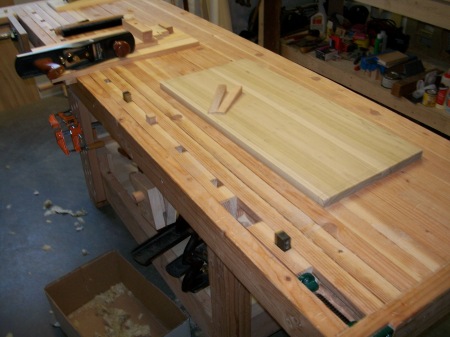

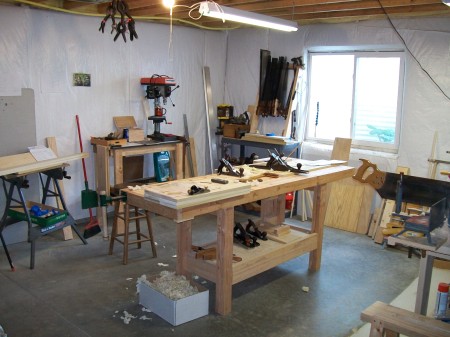

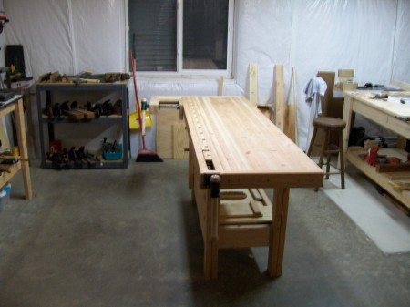

Adam, here are some bench shots.ning-bench3-32250-24.jpg?width=450ning-bench2-32250-28.jpg?width=450ning-bench1-32250-48.jpg?width=450

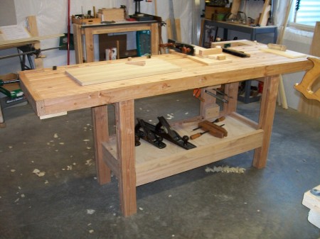

ning-bench6-32249-77.jpg?width=450ning-bench5-32249-79.jpg?width=450
ning-bench4-32249-7.jpg?width=450

That'll do quite nicely Mark, quite nicely indeed.41.gif I like your low angle Veritas sitting on the shooting board, nice plane.

ning-bench6-32247-70.jpg?width=450ning-bench5-32247-30.jpg?width=450
ning-bench4-32247-42.jpg?width=450

Very nice. I always love to see a bench in the center of a shop instead of a tablesaw. What is it made of?

Made it out of Borg wood. Spent a couple hours sorting through the 2 x 4 and 2 x 6s. spent three day going from store to store picked one then picked through there select lumber. I consider this my starter bench. So far after a couple years the only thing I would change beside wood type is adding a second dog hole in the shoulder vice.

Right on! I make most of mine from good old Southern Yellow Pine and I love the stuff. It seems to get harder as it gets older. It is cheap and is what is found in every home center here in VA. I would love to have a nice maple or ash bench, but that stuff is uber expensive here. Maybe one day... For a starter bench, I'd say you did a fine job. I wish that I had incorporated a wagon vise in my most recent bench like you have on yours. There's always next time.
