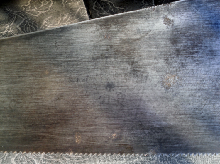

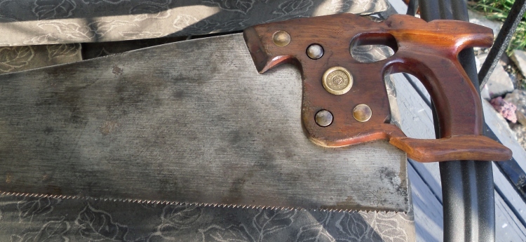

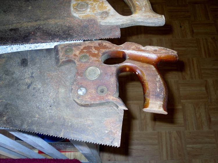

 That old rusty handsaw, with the broken handle, that costs a whopping $2?   Yep, just about back to work, from a "Re-hab".    A "Before" photo firstning-sdc12246-32224-61.jpg?width=750Ugly fellow, ain't he?    Right at the bottom corner of the blade, there is a stamped number, Disston did this to tell the ppi of the blade.   In this case " 5  1/2 ".    Needed a second saw to get a few extra sawnuts, as well.   Brass medallion say " DISSTON"  above a keystone, with U.S.A. below it.    And now the rest of the story:ning-sdc12259-32224-34.jpg?width=750with a glaze to cover the bare wood areas, awaiting a finish.  Blade shined up nicely, as well.    Teeth will be filed "Rip" as soon as I can.   You can almost see the keystone etch on the blade. another look at the etchning-sdc12260-32224-48.jpg?width=750DISSTON & SONS         D8       Ready for work......
Great restore looks like it is ready for another lifetime of work.

Hey Steve, you da man! That turned out really nice man! I love it! Great work on the handle and I don't remember but is that a Disston  medallion or an Eagle with Olive Branch?
Your work restoring these old tools Steve is admirable. Thanks for letting us follow along.
Disston Medallion, with the Keystone.     Both the medallion and the etch are the keystone.    I guess a shot of Gun Blue will bring out the etch better.    Working up on the "Donor Saw" next.     New, solid wood handle ( a glueup) and a pile of sawnuts.    The Broken Back saw handle supplied the add-on piece for  the Thumbhole repair.   The new handle for that backsaw is made from black Walnut.     waiting on the finish to cure out, then a photo or two of that one.      Grin.gif
