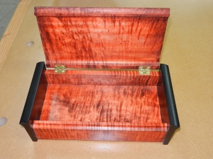

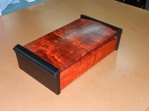

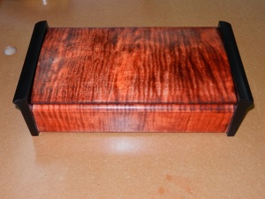

I finally finished the Curved Lid Jewelry Box that I made for my wife. It's curly maple that's dyed. The sides are dyed with India Ink and then 6 coats of semi-gloss lacquer and then 4 coats of wax. The plans are from Woodsmithshop.com. Thanks for viewing.ning-dscn0123-32007-52.jpg?width=300ning-dscn0124-32007-9.jpg?width=300ning-dscn0125-32007-32.jpg?width=300

What dye did you use for the tiger maple?

I used Trans Tint liquid dye, It's orange and reddish brown mixed in alcohol. You can mix it in water but the alcohol drys faster and doesn't raise the grain as much.

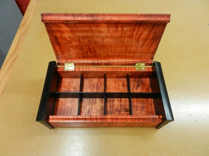

I felt something was missing so I added a final touch this afternoon. I think the dividers finish it off nicely.

Agreed!!

great job, Love the finish. I'm sure she will be proud of her new heirloom jewelry box.
