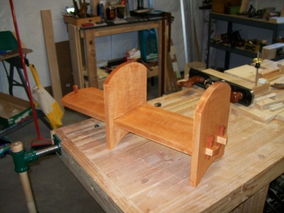

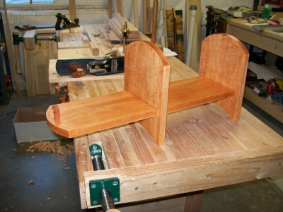

I needed a small book shelf (22") for my desk at work and declined the offers of we will buy you one.
This is what I came up with. It has a sliding book stop/leg that adjusts to the amount a books I have.

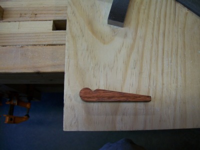

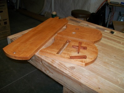

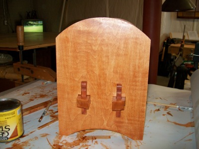

Wedges hold the right end on and the third wedge is a stop for the sliding leg. I used Maple and the wedges are Red Oak. Probably sand it again and do another coat of Minwax Gel.

Ok, the million dollar question, as we know your such a neanderthal when it comes to woodworking, is all by hand? And if so, how'd ya do the slots on the side? Great project Mark, and wonderful design. I love the adjust-ability of it to keep the books vertical.
Yup all hand work John. I made the slot that is kind of a sliding through mortise by drilling out the corners after knifIng the lines then removed most of the waste with my coping saw. Used a chisel for cleanup. Tuned the wedges on the shooting board. Cut them close with the coping saw first then the chisel.
