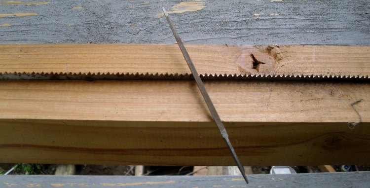

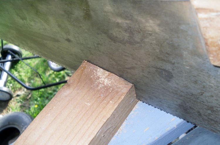

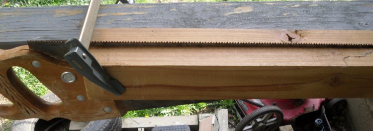

 Ok, I have a bunch of old saws collecting in the shop.   Some do need a bit of "dental" work.    I don't have a "store bought" saw vise to hold the saw blades while i file away at them snaggle teeth.    So, I picked up two 2x3" pine scraps, cut them to a saw blade length.   Didn't even measure it, just laid a saw on the scraps, marked to spot while my thumbnail, and cut the boards WITH the saw that was just laying on the boards a moment earlier.    I grabbed a couple "F" style clamps, and went out to the back porch.

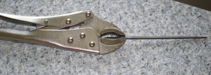

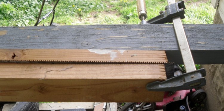

 Placing a saw between the two halves of the "vise', I clamped the jig to my porch railing's 2x4 top rail.  ning-sdc12285-31748-38.jpg?width=750Teeth to the top.   When the file gets near a clamp. I'll just swing the clamp the other way. and keep on filing along.   A look at the other end of this visening-sdc12286-31748-97.jpg?width=750Nothing real fancy here, either.   I grabbed an "extra slim taper" file, and followed along the tooth line.  Since this was just a sharpening , NOT a retoothing, I just followed what angles were already there:ning-sdc12288-31748-5.jpg?width=750You can see where I've been on the blade.  That file got to be hard on my hands to hold, so a pair of visegrips was clamped onto the file's end.  Filing took about 15 minutes, counting two 'breaks" to catch a 'breather" ( Olde Pharte Syndrome) but i finally reach the handle end!  Now, how does this old saw work , after the "dentist" got done?ning-sdc12290-31748-28.jpg?width=750Not too shaby.    Saw was made by Disston/HK Porter back in the late 50s.    Called  The Rancher.   two more full strokes finished this cut.   No "grabbyness" in the cut, either.     Set might be a bit much, but we can fix that as well.     just a High Tech Vise......Grin.gif

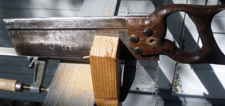

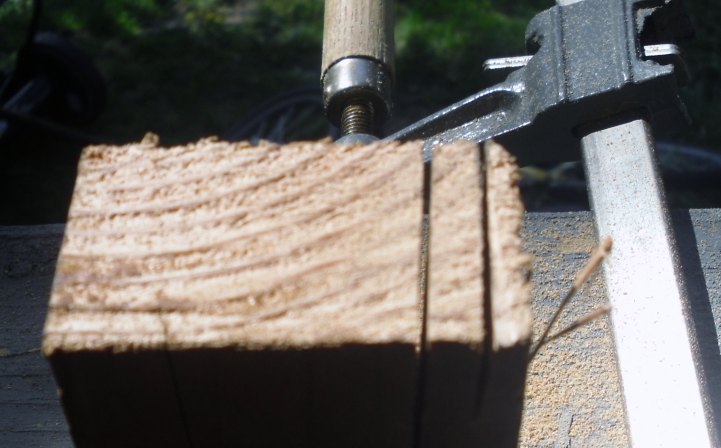

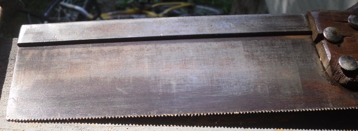

 I tried the jig out on a backsaw today, once the rain had quit.     Sun came out!      I had to change the way the board sat, though, due to the short (10") blade.     Once everthing was in place, time to file, right?     Not yet, after them sore hands the other day, rigged up a file holder, of sortsning-sdc12295-31751-18.jpg?width=721May at a later date, notch the jaws on a cheepy one, just to keep the file steady.    The backsaw for this experiment?ning-sdc12293-31751-71.jpg?width=721That cheap, $1.21  saw with a new walnut handle.    IF this works out, i have two other backsaws to sharpen up. Got everything clamped up, worked my way down towards the handle.   In filing "rip", I file straight across each tooth, and there are a LOT of them.   Whew!    Done!    After a "break" for a Mountain Dew, time for a test drive, or two.    The first one more or less clean the "gums' ( do NOT use  "Tap Magic" on the fileTongue.gif)  and the second cut worked a lot better.ning-sdc12292-31751-72.jpg?width=721the one on the left is number 2 cut,  didn't take long to get to full depth of the saw, eitherning-sdc12291-31751-58.jpg?width=721I then crosscut the notch, since it will fit the handle areas better on the other backsaws.    This saw works just as well in crosscut, as it does in rip.   NEXT!!!Grin.gif

Drill a hole in a piece of dowel rod, and you'll have a handle for your file!

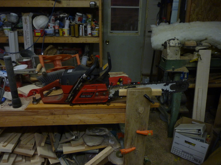

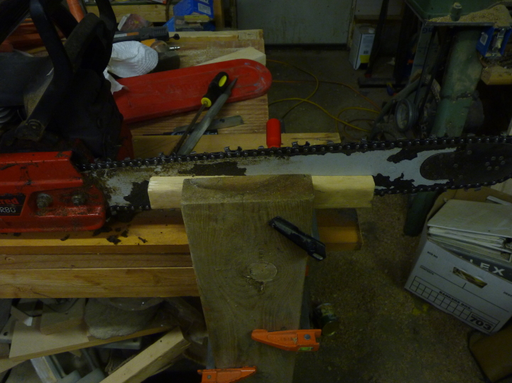

Steve here are a couple of pics of a saw vice i use in my shop.
ning-p1030394-31749-15.jpg?width=721
ning-p1030393-31749-20.jpg?width=721
