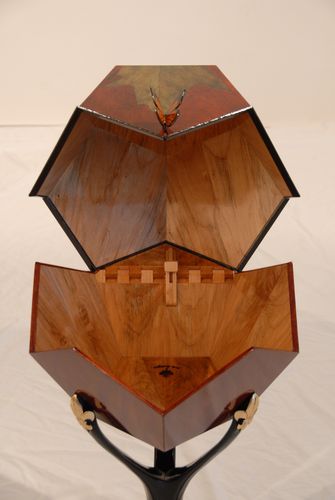

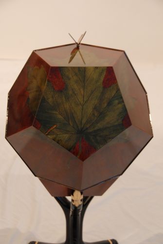

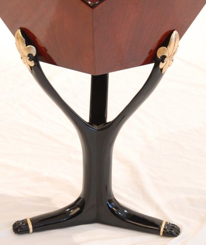

Paul Miller is what one could call a renaissance woodworker. For many years, in BC, Canada, he built wooden boats. Sail boats, canoes and motor craft. Before he retired he and his wife built a fleet of tour boats and, for several years, ran a business offering tours of the waterways around the islands near Victoria, BC. A few years ago he sold the business and ventured down another woodworking path. He builds large and small boxes and decorates them with marquetry. His dodecahedron box is a marvel to behold.
Not shown are his wooden hinges and latching mechanism. Just simply exceptional work!
