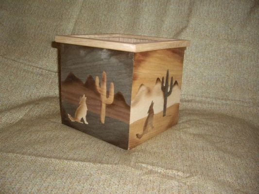

While at Paul Miller's place in Green Valley, AZ he sat me down at the Chevalet and I cut a pretty typical desert scene.

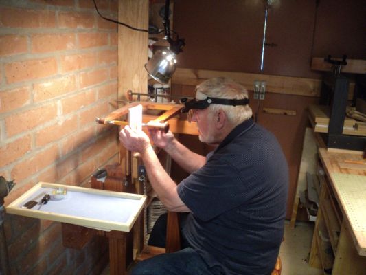

Here is a picture inside Paul's 6X12 marquetry workshop. Cozy.
Here is the result. All I did was cut the packet. Paul put them all together and veneered them on the box he constructed. He also did the hot sand shading.

That is very cool Gene! Hey Gene, is that you sitting there? That man is deep in concentration, look at that! Now that's a woodworker!!!
As far as shading, can you elaborate on the hot sand technique? Thanks Gene, great photo thanks for sharing.
Yeah, that's me, and I was concentrating! The process requires continuous cutting while moving the work to follow the line. Much like scrolling, except you must use your foot to control the clamp that's holding the work while working the saw and turning the work. Heck, I can barely walk and chew gum.

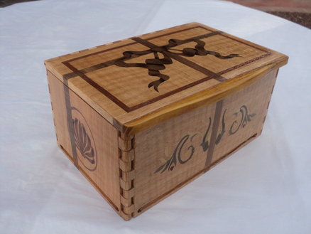

Paul just heats white sand in a container and dips the work in. He has a deft touch, not evident on the desert box. Some of his more intricate cuts, like ribbons or Celtic knots are shaded so realistically that it reminds me of trompe l'oeil. They take on a texture and depth that fools the eye. Here's an example he had on the bench when I was there. The box unfolds and can be re-folded with the insides (sides, top and bottom) becoming the outside.
