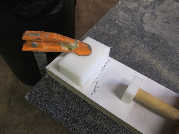

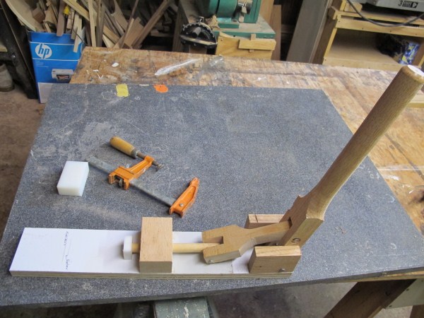

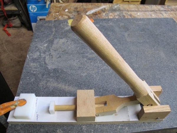

My press-
The "stop block" is clamped to the press at the desired location. The clamp also holds the press to the bench

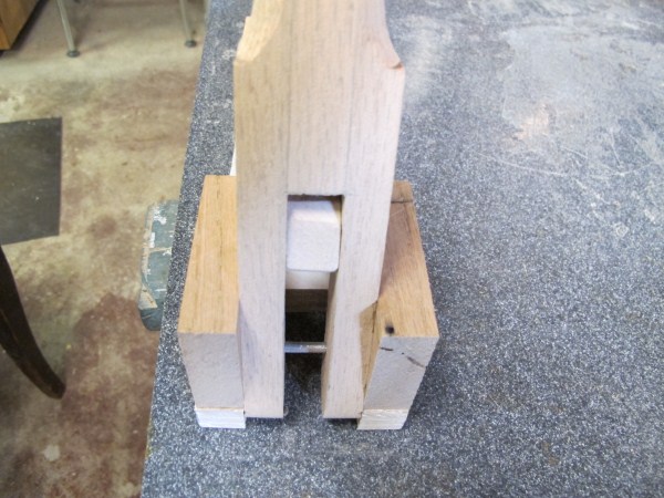

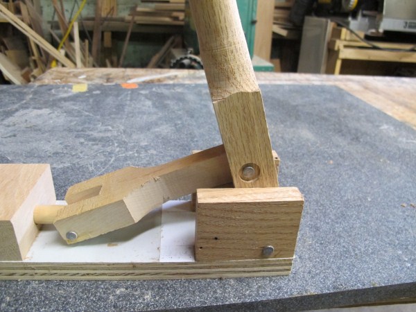

Leverage action. The pins are 16d nails. Notice the fine finish work.

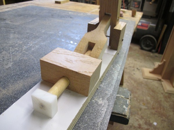

Back end.
The "plunger" pad and the stop block are made from a piece of tapping block for laminate floor installation.
So far the press has worked flawlessly, although it has probably assembled fewer than 15 pens.
