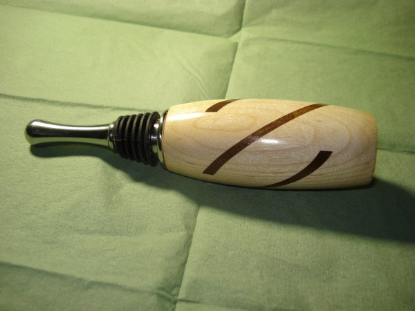

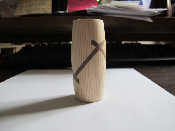

Well, the old lathe finally got powered up this week. I've had this idea rolling round in that empty space called my brain and had a couple of hours to try and make it work.
A couple of years ago, my Christmas presents were wine bottle stoppers. The design was stolen  borrowed from a pen turner and they turned out OK-
Then the design started to morph, in my mind, but it was going to take some experimentation to get the design to work. Sketchup was a possibility for creating the new design, but since my talents there are limited to drawing boxes, it looked like it was going to be a trial and error (mostly the latter) process.
Here is what version 0.1 looks like. My end goal is to get the ends of the dark pieces to match exactly to make a flowing line around the piece.
For some reason, this example- to me- has an Asian characteristic. That's OK, just not my original idea.

Nice looking stopper Lewis. I have several turning projects myself, I may have to add one of these to my list.
Charles,
The "inlay" is actually done on a table saw. Slots with a thin pieces of stock glued into them. This could probably be done with a hand saw and narrow chisel as long as the bottom of the slot is very flat.

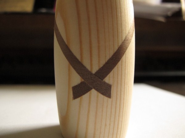

I made a small jig to hold the piece in the same position for each pass. I make one pass over the blade for each slot. The slot is about 1/4 to 1/3 of the thickness of the main block but is not critical. The deeper the slot, the more the "inlay" appears to curve around the piece when turned.
