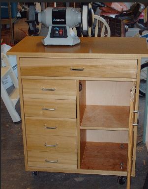

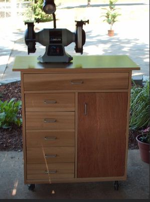

Ron here a couple of pictures of some poplar I used on a shop cabinet that I put my grinder on. I was real concerned with the sap wood and heart wood colors since it was a shop cabinet. But as you can see you will get some variation. I don't remember off hand how much of this had the green color in it, but it has turned a little darker with time. I didn't have a recent shop on the computer but I can get one for comparison. This just has (shhhh) Poly on it.

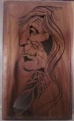

I use poplar in many areas of scrolling.  Biggest problem I have is warping on larger pieces.  The green and purple colors will turn darker with age.  Here is a cutting I have done with "black poplar".
"Native American Portrait"

Dang John, that's about the nicest poplar cabinet I think I have ever seen, beautiful contrasting colors!

Another fine example of scrolling, and how poplar turns dark brown, in this case, it worked really well Fred! Great job my friend!

Beautiful cutting!!!!  I had never heard of black poplar.  That is a great color.
