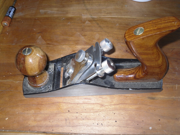

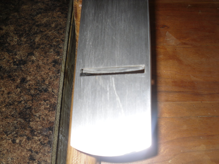

  Seems he likes a little plane from harbor freight called a "Windsor #33 bench plane.    His costs about $10 ( mine was $9) and decided to try out some ideas with it.    One idea was to convert it into a nice little scrub plane like a Stanley #40.     Idea worked real nice!!!    The iron IS kind of thick on the #33.     A 3" radius  needs to be ground on it to make it into a scrub plane iron.    A picture of this wonder??ning-sdc12402-30797-86.jpg?width=750Just a litle thing ( TWO of these will take up the same length as a single #5 Jack Plane) as for the iron itself?ning-sdc12401-30797-52.jpg?width=750Not a perfectly ground edge, but i did it freehand.     With LOTS of water handy.    Stick this iron back into the plane, and get ready to take a big bite!ning-sdc12400-30797-10.jpg?width=750Still plenty of room for chips to slide through.   This is for taking rough lumber down to get it ready for the jack plane to work.    This goes ACROSS the grain.     All for about $10, or less.....
