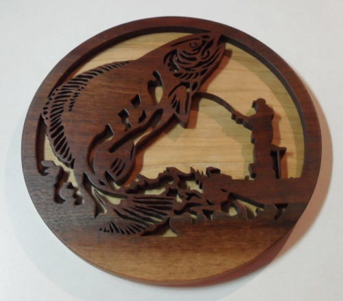

April 20, 201214 yr comment_30775 This is a Steve Good design that I just finished. Â It's made out of walnut and sweet gum. Â It's 9 1/2 inches in diameter. Â Scrolled with a # 2 blade for all the interior cuts. Â Sanded primarily with a sanding mop, and finished with mineral oil. Â I have designed a stand for it, but not quite done with it yet. Â Need to attach the hinges. Â Thanks for looking and comments are encouraged and appreciated. SQ Happiness is wood chips flying! Report

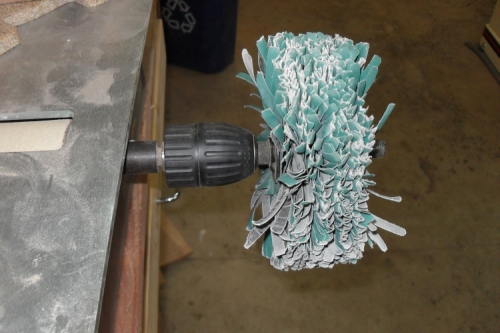

April 20, 201214 yr comment_30784 Nice work. As others have said, good to "see" you back, SQ.I have a question. What is a sanding mop?Harry BrinkBulldog WoodworkingMontana Report
April 20, 201214 yr comment_30783 Ok, first off Sue, welcome home!!! Great to see ya around these parts again.I have once question, and I think I know the answer, did you purposely use the lite wood at the bottom of the project? It looks perfect to define what could be the water. The color is amazing, very warm, very nice, and a great item.So, how is the booth working?John MorrisThe Patriot WoodworkerProud Supporter of Wounded Warrior Project and Homes For Our Troops Report

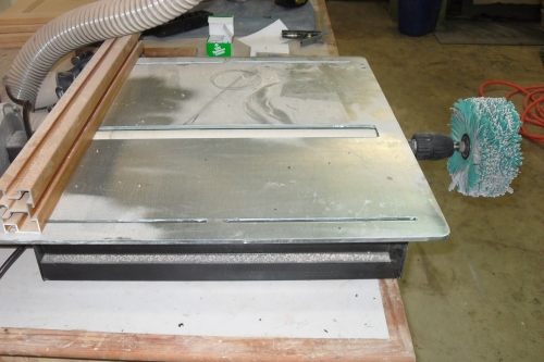

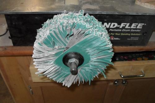

April 20, 201214 yr Author comment_30782 Thanks Harry,The sanding mops are the best! They are fantastic for getting into fret work. Mine is attached to my Sand Flee but I believe they can be used in a drill press. These mops come in many different grits. It's nice to be back here - but I never wonder far. (grin)SQHarry Brink said:Nice work. As others have said, good to "see" you back, SQ.I have a question. What is a sanding mop? Harry Brink Bulldog Woodworking Montana Report
April 20, 201214 yr comment_30781 Makes me want to get my pole and head out. Â Great work.Fredaka Pop's Shopwww.pops-shop.comEX-21'Soooooo many patterns - sooooo little time' Report
April 20, 201214 yr comment_30780 As the others have said, "Welcome Back"!Beautiful job on the plaque!!Lew Kauffman-Wood Turners Forum HostTime traveler. Purveyor of the world's finest custom rolling pins! Report
April 20, 201214 yr Author comment_30779 I didn't have time earlier to post a picture of the sanding mop but here goes. Â Picture of mop from two different angles. Â Sanding mop doesn't hurt your hands but requires a firm hold on the item if you don't want it tossed across the shop. Â Â SQ Harry Brink said: Nice work. As others have said, good to "see" you back, SQ. I have a question. What is a sanding mop? Harry BrinkBulldog WoodworkingMontana Report
April 20, 201214 yr Author comment_30778 John, Yes, the lighter wood at the bottom of the plaque was on purpose. Â I wasn't even sure that detail would be obvious in the picture. Â Appreciate you noticing. I never jumped ship. Â Who in their right mind would leave this group? Â You can always count on me to surface from time to time. Â Shop I've placed my items in has been fun and motivating. Â Gives me a reason to spend even more time in the shop. Â My hope is to keep the display fresh and interesting, Â so plan to keep keep adding new items as often as possible. Â Rest assured, Â you can count on me to dust myself off - as time allows and take a picture or two. Â SQJohn Morris said: Ok, first off Sue, welcome home!!! Great to see ya around these parts again. I have once question, and I think I know the answer, did you purposely use the lite wood at the bottom of the project? It looks perfect to define what could be the water. The color is amazing, very warm, very nice, and a great item. So, how is the booth working? John MorrisThe Patriot WoodworkerProud Supporter of Wounded Warrior Project and Homes For Our Troops Report
April 21, 201214 yr comment_30777 A picture is worth a 1,000 words! Now I know what a sanding mop is.ThanksHarry BrinkBulldog WoodworkingMontana Report
April 22, 201214 yr Author comment_30776 Harry, When it comes to mops, this is my favorite one. Â SQHarry Brink said: A picture is worth a 1,000 words! Now I know what a sanding mop is. Thanks Harry BrinkBulldog WoodworkingMontana Report
