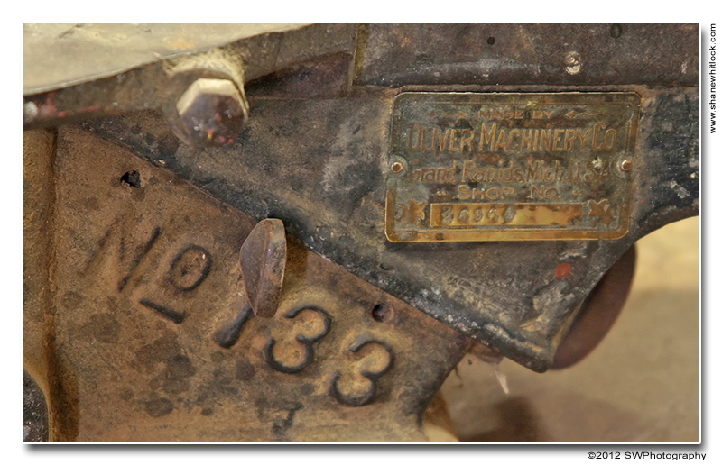

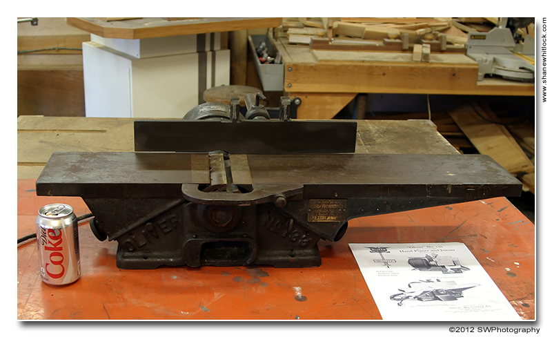

April 23, 201214 yr comment_30622 I need another jointer in the shop like I need a hole in my head but when my friend Andy sent me a link to a local classified ad I had to go check it out. It's tiny for a 6 inch jointer, I had 4 inch jointers bigger than this one, but it weighs 200 lbs. It's in fairly descent shape and mostly complete sans the blade guard. Oliver Machinery Co. is one of my favorite manufactures and I had to have it so I offered the seller 50 bucks for it and he accepted. Direct drive 110 v 1/3 hp motor Badge After a little cleaning and a coke can for scale Should be a fun restoration project but it's gonna have to sit in the rathole until I have time to work on it, which should give me a chance to find a 6 inch cutter head to replace the clamshell head and maybe get lucky and find a blade guard. Report

April 23, 201214 yr comment_30632 That is an awesome joiner Shane. Great lines and nice style.What is a clam shell cutter head?And, have you fired it up to hear how that direct drive sounds? Just curious.John MorrisThe Patriot WoodworkerProud Supporter of Wounded Warrior Project and Homes For Our Troops Report
April 23, 201214 yr comment_30631 Awesome Shane. Just wondering if a good cleaning might not be the best for this one. Leave her aunatural.My job is to give my kids things to discuss with their therapist Report

April 25, 201214 yr Author comment_30628 Thanks for the comment everyone.Larry, yes it will be nice to restore something small again. I think the last 3 machines I have done have totaled over 8,000 lbs.John, This article can explain to ya what a clamshell head is a lot better than I can. In my opinion they are as dangerous to use as a square head is. I don't have a problem running a planer with either, but don't feel safe running a jointer with one.Yes I have turned it on and ran it for a few minutes. Bearings sound okay but they are dry. They will get replaced when I restore it.Ken I thought about just cleaning it up and leaving it as is, but there's a lot of chips in the paint, looks like it got knocked around a little. I don't think I will completely strip it down, just sand the good paint, fill in the chips and repaint.Chris, are the pic not showing up for ya? If not, you can view them here on my website. Report
