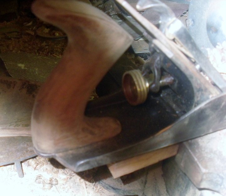

April 28, 201214 yr comment_30319  Starting to sound like Star Wars.      Anyway, got off work this morning, i was on a MISSION.     Put a bit of gas in the van, and check out the village yard sale day nearby.    Went back the the Antique store in the village, and paid a whopping $10!   FoR ONE item, no less.   And just what did i buy ???  Well, since I like RUSTY TOOLS, a nice 13-1/2' long jack plane was available. Got it home, and cleaned out a bunch of junk.   Bug nests, dirt balls, three roofing nails stuck under the frog (WHY????) and then started on the rust itself.   I start by taking everything apart.    Work from piece to piece. Soak things down, brush things up, loosen and twist.  Once things were starting to 'come clean", i placed them where I could keep track of them all.   First the base:About a pound lighter, I think...  Then came the boltsA wire brush with a squirt of WD40 in it, works like a charm ( just wear OLD Clothes) I also got the frog cleaned up and ready for a paint job.    Then i cleaned and sharpened the iron, and the chip breaker, and then the lever cap.  There is a SMALL Brass wheel to adjust the depth, about the size of a nickel, maybeStamp says "WortH" not sure who made the plane for Worth Co. though.   Painted the base and frogand, while the Rustoleum Black cured, I sanded the handles back to bare wood.   I'll re-finish next weekend.  i do have a couple sets to do, afterall.  ok, evrything done?   Put it back together, and get ready to work. A "normal #5 is sitting behind the Worth Jack plane.  $10?   Not too shabby.... 'and may the road raise up to meet ye' Report
