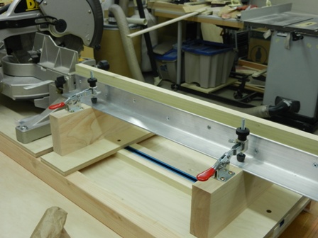

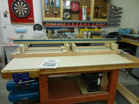

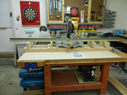

This is my Miter Saw station that I built from free plans I downloaded from Woodsmith shop plans:
 www.woodsmithshop.com
View the blog at http://www.thepatriotwoodworker.com/profiles/blogs/portable-miter-saw-station-from-woodsmith-shop-plans
This was a fun project and one I will get lots of use from. Thanks for viewing and comments always welcome.

Looks awesome. Strong enough to work, easy enough to put away when not needed. Wish I had a setup similar but my space and area dictates a dedicated station. Thanks for sharing.

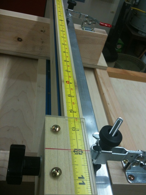

Wow! Mike that was a lot of work! I have question for you. How much time did it take to get all the track and clamps and toggles in place just right? That seems like some diligent work was involved in that part of the process.
Thanks Guys!
John from start to finish it took me 4 days to construct. The tracks, clamps took about 12 hours. Not too bad all in all. I could have done it sooner if I would've had a hole week end off.
