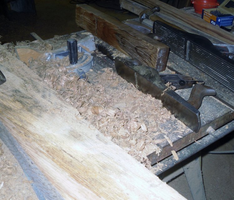

 i have a beam that needed a "dressing down".    I already had used an axe to "plane" off most of the bug infested wood.   Now, since I had a few "new' planes that needed a little work, i moved that beam onto the "bench" aka Tablesaw.     I worked the surface down with that little #33 scrub plane, going at right angles to the grain.  Then came the jack plane,  in this case the one made by Worth Co.ning-sdc12479-30260-36.jpg?width=750Makes a mess, don't it.  Anyway, i kept dragging out bigger planes, the #129  AND the #8c took their turns as Angry Beaversning-sdc12478-30260-88.jpg?width=750getting there..  that big old #8c Jointer was a might hungryning-sdc12481-30260-78.jpg?width=750But once he was done, the little Union smoother got it's turnning-sdc12477-30260-6.jpg?width=750Later on, I'll rip that beam down into stretchers for a "real" workbench.    As I worked each plane, I learned just how each needed to be set up.   The other #5 jack plane I have needed a bit of adjusting, just to raise a shaving.     The little Star Wars block plane even took a turn.    That is the FIRST time I have ever heard a plane scream.     yes, it did indeed scream.      Tried all of the smoothers, just to see how they will work.     This is going to be fun.     What was NOT fun, was  hand-sawing the end square.   THAT is work, I don't care how sharp the saw is....Tongue.gif

 Spend all that $$$, they had better be ready to work!!   I used that beam to fine tune almost all my new planes.     I needed that beam flat and square, so they got a work out.    At least now i know how each plane will work.     I even had the little block planes out and working.    One even screamed back at me!!!    Not sure what the beam is made of.  Grin.gif
  i even got both jack planes tuned up!    Everyone should be ready to work, now.    That scrub plane though, is wicked.     Chunks flew off that beam, and even off one of my knuckles.   Mean little critter....Grin.gif
