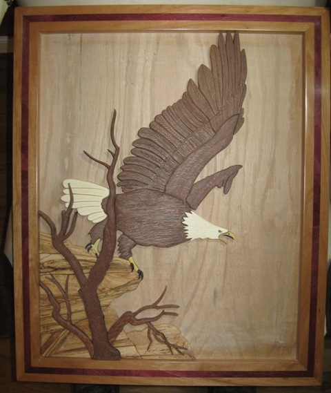

May 1, 201214 yr comment_30226 Hi Everyone Been a while since I’ve posted any new intarsia but here is a sneak peek of my newest commission. Titled—â€Eagle’s Realm†it sets in a 16†x 20†cherry frame with purpleheart inlay. Woods used so far; Walnut, Holly, Ebony, Yellowheart, Spalted Beech, Fishtail Oak. 50 pieces so far. I’m still designing the background scenery of the pattern which is the hardest part to get the proper depth . I like to shape, sand, detail carve and apply a coat of finish as I go on these type of projects. I foresee between 200 and 300 pieces depending on how elaborate the background gets. Stay tuned . Mike 'why buy it if you can build it'www.midlothianwoodworks.com Mike 'why buy it if you can build it'www.midlothianwoodworks.com Report

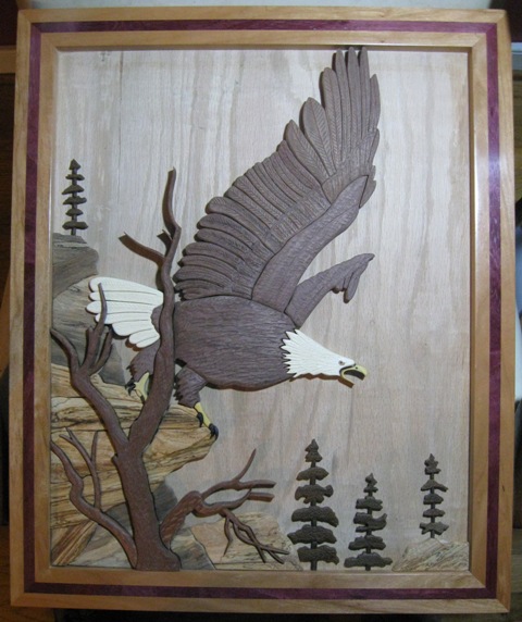

May 1, 201214 yr Author comment_30239 I added a few trees to the background yesterday. Each tree is made from lignum vitae and Peruvian walnut. The lignum is brown now but will turn a vivid green in time. I use CA glue to hold the pieces of the trees together to form a single unit.100 pieces so far. Mike'why buy it if you can build it'www.midlothianwoodworks.com Report
May 1, 201214 yr comment_30238 Mike, Thanks for sharing this beautiful project with us. And your description of it answers all the questions . GregScroll Saw forum hosthttp://www.thesawdustfactoryga.com/ Report
May 1, 201214 yr comment_30237 MikeImpressive. Time and patience is shown here. Great job so far, really looking forward to seeing the progress photos. Also I have some lignum vitae in my shop. I was a darker green when I purchased it, didn't know it started out brown. Thanks for the lesson.Wayne MahlerGod bless and protect our troops that serve so we can be free. Report
May 2, 201214 yr comment_30236 Wow Mike, that is awesome. It looks beautiful sir, and the frame is really nice, nice contrasting. Thanks for sharing MikeJohn MorrisThe Patriot WoodworkerProud Supporter of Wounded Warrior Project and Homes For Our Troops Report
May 2, 201214 yr comment_30235 Love it MikeFredaka Pop's Shopwww.pops-shop.comEX-21'Soooooo many patterns - sooooo little time' Report
May 2, 201214 yr comment_30234 Mike, All I can say is WOW! Fantastic piece of work! Â Larry Old Woodworking Machinery Forum Host Report
May 2, 201214 yr comment_30233 Mike,That looks great, I like those fine shadow lines (as in under the eagle's neck).How thick are the elements ?, and do they necessarily stand out from the background by the same thickness. Cheers Sam Csam c Report
May 2, 201214 yr Author comment_30232 Thanks everyone for the commentsTo Sam-- Part of the uniqueness of intarsia is using different thicknesses of wood to give it a 3D effect. In this case I have allowed 3/4" recess from the face of the frame to the backer board. The large tree( fishtail oak) is 3/4" thick tapered down to just below the edge of the frame. The eagle (walnut) is also 3/4" thick but tapered down where it meets the tree branches. The ledge where the eagle is standing (spalted beech) is 3/8" thick and the small trees( Lignum Vitae) are 5/16" thick. The rest of the background pieces will be 1/8" - 1/4" thick.I have just about finished the design for the background so will be posting more progress pics soon. Thanks for asking Report
May 2, 201214 yr comment_30231 Very, very nice, Mike!Your description of the thicknesses is greatly appreciated, too.Gene'The true soldier fights not because he hates what is in front of him, but because he loves what is behind him.' G. K. Chesterton Report

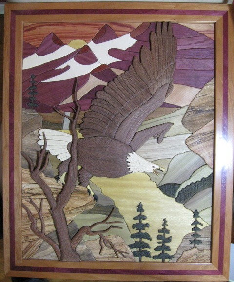

May 11, 201214 yr Author comment_30230 Â Well, I'm just about there. I'm still not happy with some of the scenery on the right hand side so will change some of the pieces to correct the depth that I'm looking for, plus more sanding and detail carving and glueing everything in place. 175 pieces. Walnut, Holly, Spalted Beech, Spalted Sycamore, Yellowheart, Ebony, Fishtail Oak, Poplar, Lignum Vitae, Purpleheart, Afromosia, Vera wood, Peruvian Walnut, Tulipwood, Maple, Bloodwood Mike'why buy it if you can build it'www.midlothianwoodworks.com Report
May 11, 201214 yr Author comment_30228 Thanks Larry I have 35 hours so far and will probably spend 5 more hours changing pieces , gluing in and applying the final 2 or 3 coats of poly.Larry Buskirk said: Mike, Â Wow! How many hours so far? Â Larry Report
May 11, 201214 yr comment_30227 Mike, Only 35 hours, I don't think I could do something like this in 35 days! Wow. Â Larry Report
