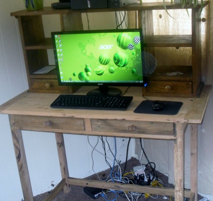

May 4, 201214 yr comment_30107  There is always a Desk like this one:This one does have two drawers, though.   Just a simple little desk, with a "hutch" on top.  M&T joinery for the legs.   I THINK I have a story somewhere about building this desk.    'and may the road raise up to meet ye' 'and may the road raise up to meet ye' Report

May 5, 201214 yr comment_30105 Cool computer area, Charles! I see you have found a way of dealing with software "bugs"!Charles Nicholls said: Before totally building the desk from scratch, sometimes it's a good idea to check with the local college, if you have one in your area. They occasionally just take older desks to the dump or sell them for literally pennies on the dollar at auctions. This one was an old teachers desk from Harding University. If you get a lot of good scrap though, you may be able to build one just as easily and cheaply. This desk was made with 1x6s and 2x4's It's a heavy beast but it has been around almost as long as I have. The sides are made from the 1x6's all tops except for the black desktop itself are made of approximately 3/4 to 1" plywood as well as the back. the desktop is the only crappy part which is I guess what you'd call pressed particle board but it is also 3/4" to 1" thick so it wont break easily. Anyway thats my 2 cents Charles NichollsSite Hostnicholls61@att.nethttp://www.nichollswoodworks.comThis website is new so it doesn't have much to it yet but you are welcome to take a look Report
