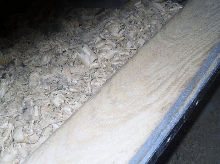

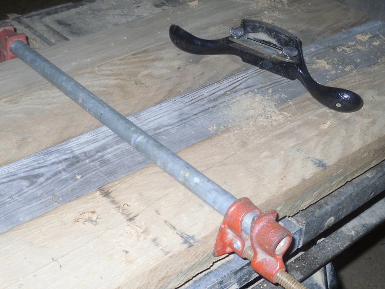

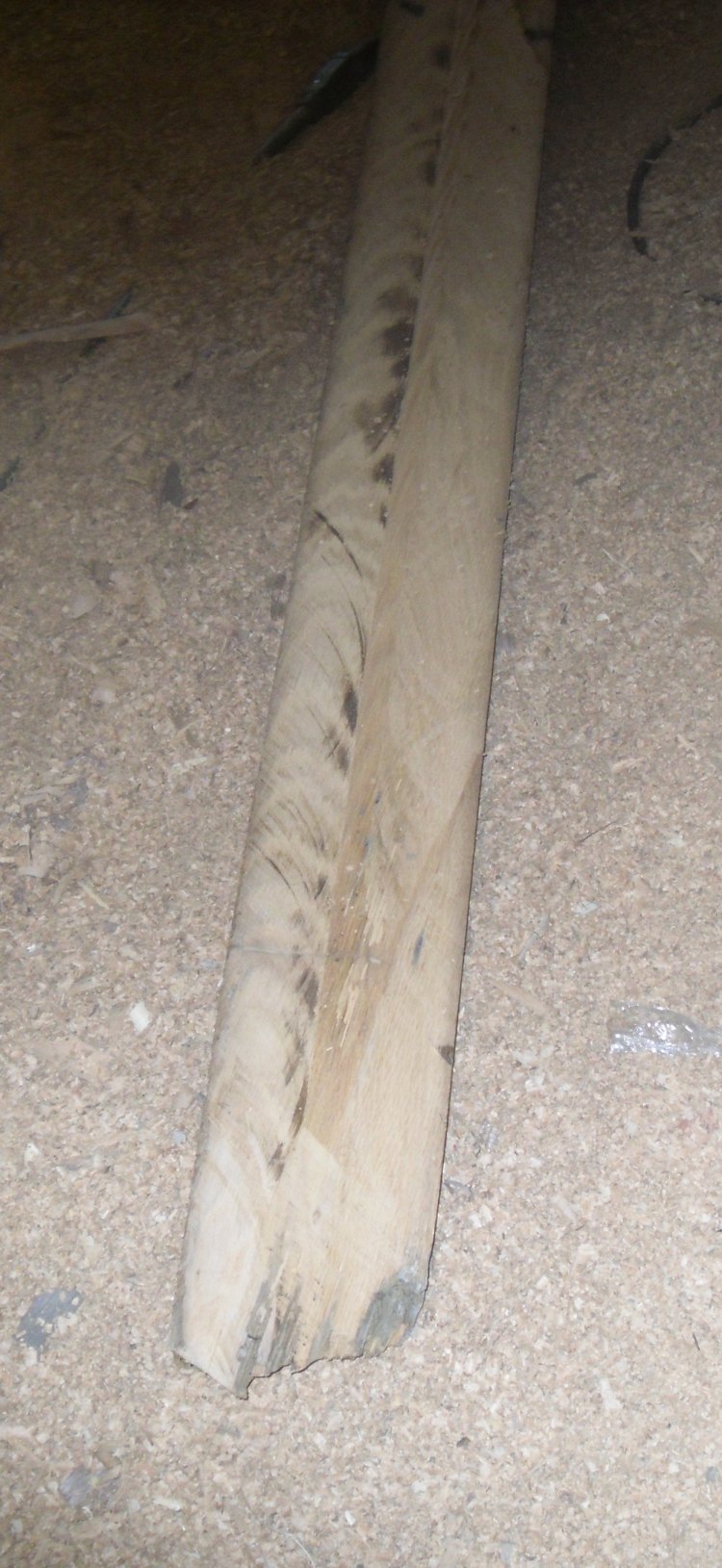

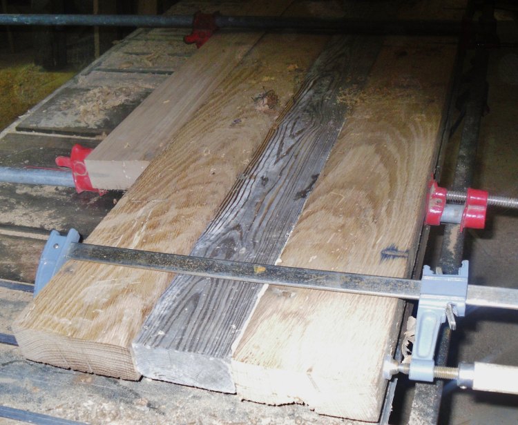

May 10, 201214 yr comment_29884  I had an old beam i was planning on using for a stretcher.   Tablesaw just didn't want to make the cut to split it down the middle.  Kept knocking the breaker out.   Finally, I decided to just get meaner than the board.   I ran a circ saw down the middle.   Once I had a saw kerf on both sides, i went and picked up a splitting maul, and a 10 pound sledge.  Start the maul, give a single whack, move about halfway along the beam, and repeat.   Beam was laying on the floor, beside itself...Pretty, ain't he??   Next, I C clamped one piece to my tablesaw's top ( might as well get SOME use out of it) and turned the planes loose on it...awaiting their turns.  When i had both boards looking good..I had them looking too good.   Soooo, hey, how about a bench top? I grabbed a pine 2x, cut it to length, to match the squared off Oak planks.  i also had another shorter plank.....ah, Design Element!!The "open area' will be for a tool well!.   I took a bit of time to sharpen that #80 scraper plane, so a "test drive" on this plank was in order..Well, a benchtop is in the clamps, waiting on the titebond to do it's thing.  Might as well start the next "phase'..... but that's another story..... 'and may the road raise up to meet ye' Report

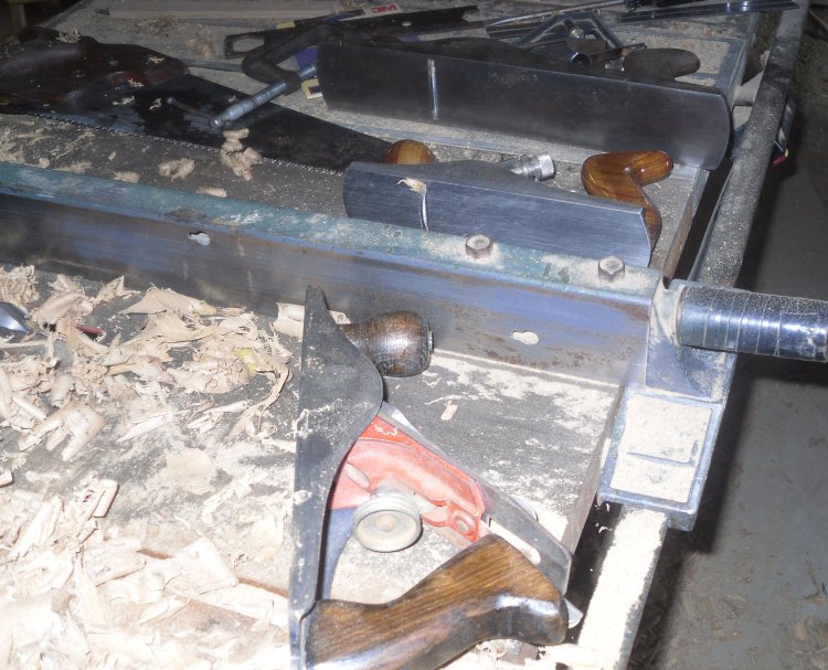

May 10, 201214 yr Author comment_29886   Those three handplanes are ( front to rear) a Stanley Handyman #4,  A H-F #33 Scrub plane ( wicked little beast!!!) and a Worth #5 jack plane, with a cambered iron.   Also in the "attack' were a Stanley #129 fore plane, and the Bailey #8c jointer.   When I flipped these planks up to do the edges, the #8c did most of the work.   Once he gets a-going along, you just hang on.  I still have a couple planes to "tune up", so a flattening of the new benchtop should help that out.   The "Family" is getting bigger, THREE block planes, two #5s , two #4s, two #3s, and the two big guys.  'and may the road raise up to meet ye' Report
