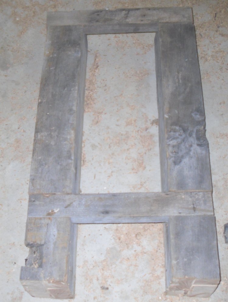

   I had some other 4x6s in the shop.     Might as well do something with them.      I needed four pieces for bench legs.    I had them cut to length awhile ago.    Now, I needed to add some stretchers to keep them in their places.     Simple joints, just BIG is all.    I got out the backsaw, and nothing happened, too big a board.    went over and grabbed a full sized crosscut saw.    Sawed down to a line, and then a framer chisel knocked out the waste.    It works, but it takes a long time to do it right.  ning-sdc12520-29881-12.jpg?width=750Framer chisel isn't much of a slick, so to get the joint smooth like this, a couple other toys were usedning-sdc12521-29881-90.jpg?width=750A#4 plane, and a sharp 1" chisel.     A small block plane as well.     This is taking way to long.     Each leg had two of these to do!    Went over to the old bench and picked up that circ. saw, again..ning-sdc12536-29881-52.jpg?width=750Reset the depth of cut to match the stretchers, and made a bunch of kerf cuts.    Knocked out the wasted wood, and cleaned things up.   We're moving now!!Grin.gif    Time for a dry fit, before the Titebond gets put to workning-sdc12525-29881-44.jpg?width=750More of them UGLY Legs??    A few screws to help the Titebond along, and we are ready to stand on our own four feet ning-sdc12526-29881-31.jpg?width=750 well, so far, so good, at least it stands on it's own...Grin.gif  what next in this project?     Stay tuned, this could get interesting......
That's coming along nicely.  Like the circular saw.  Especially like the metal vice in the background.
Rustic, heavy, poundable, not too pretty you gotta worry about scratching it up, just my kind of bench Steve, great job buddy.
