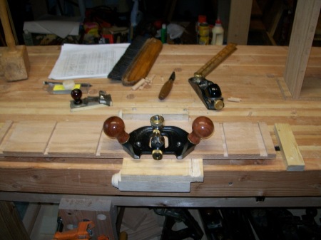

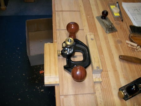

Besides sawing I use my bench hook (in this case my old beater) for Dado work.
After I cut the sides with my back saw I chisel the waste close to the line using the hook to hold the work. Then when I'm going for final depth with the router I use it as a stop so I don't blow out the back of the Dado. I just work from one side then flip it 180 and finish up.ning-benchhookrouter002-29751-41.jpg?wid

Very nice. I have an extra large bench hook that I use the same way. I also use it for chopping dovetails.

Interesting. Never thought of using a bench hook like that. Thanks.

nice router plane!!
Thanks Dragon1 Lee Valley router had it a couple years.

That's really nice Mark, so what is your collection of Bench Hooks up to right now? I love your LV plane too, nice!
I have two for sawing and then I have a chuting board. I use these for light tennon cleanup too.
When you don't really need to clamp but yet you want it to be stable; just hold the part tight to the hook with one hand and go to it.
