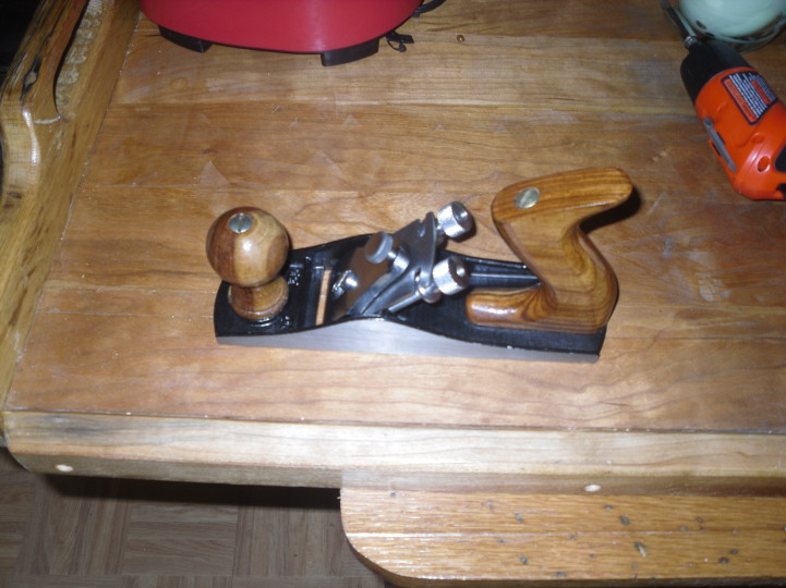

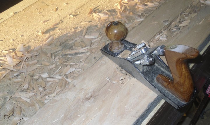

 might be on the same level ( different colour) as my #33 "Bench Plane" from "Windsor Design".   ning-005-29528-58.jpg?width=721If nothing else, you could turn it into a very mean Scrub Planening-sdc12549-29528-50.jpg?width=721
