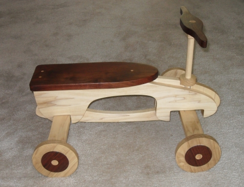

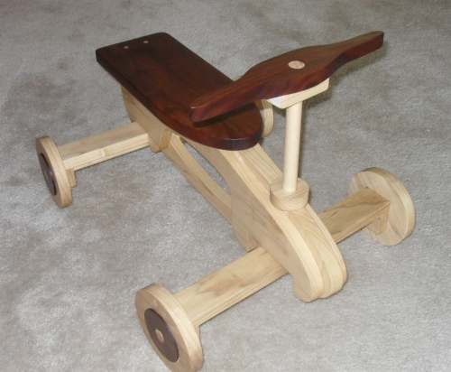

Decided to try my hand at the Red Rocket Racer which is a pattern offered by Toymaker Press - John and Cynthia Lewman.  Pattern was very detailed and easy to follow.  This is just one of many great patterns offered by this company.
All parts were cut on the scroll saw except for the axles which were cut on the table saw - to save myself a little work.  :)
Rocket Racer is 24 inches long, 18 inches wide, and 15 inches high.  Recommended for toddlers 18 months and older.  Made from poplar and walnut.  Had planned to make it out of maple, but stock maple from Home Depot was only 5 1/2 inches wide and I didn't want to laminate pieces together. Directions called for just gluing everything together, but I used some screws and plugs on the seat,  on the axles, and on the block under the handle for additional support.
CPSIA doesn't require testing on USP grade mineral oil and beeswax as these products are on their exempt list - reason I chose this finish.  Recipe for this finish is also offered on the Toymaker Press website.
Thanks for looking.  Any and all comments would be appreciated.
