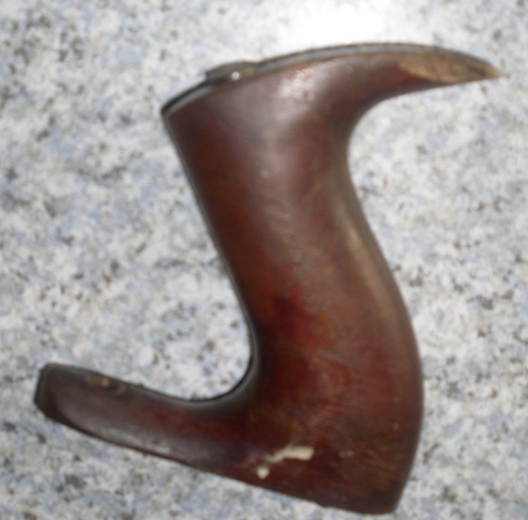

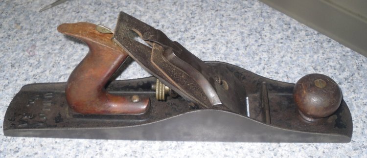

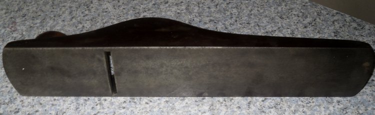

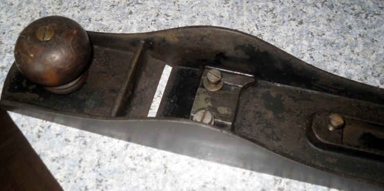

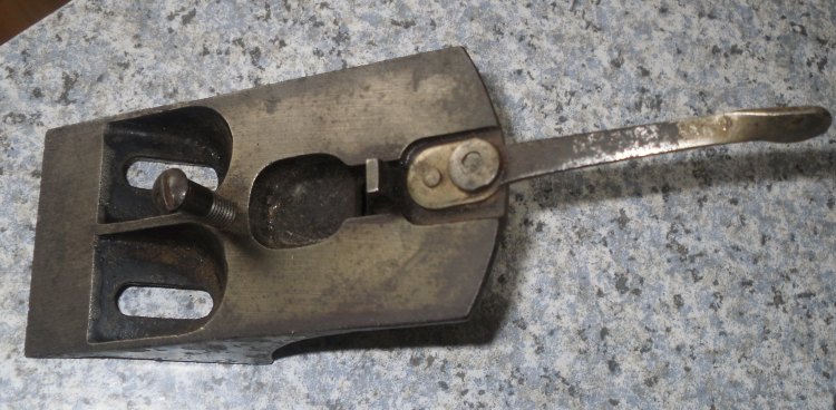

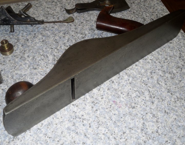

 seems a package arrived today.    Had to wait a few hours, since the mail carriers were short-handed.   Underneath a bunch of "Pop-corn" and encased in a mile of bubble wrap ( BUBBLE WRAP!!  OH! AHHHH!!) was a few old parts. After unwrapping things, this is what "fell out' of the bag:ning-sdc12582-29065-30.jpg?width=750A crack free basening-sdc12583-29065-68.jpg?width=750Kind of scratched up knob. screws look good though.  paintjob to come.  Next item:ning-sdc12585-29065-6.jpg?width=750Got Brass?   Older froggie, a look at the other side?ning-sdc12586-29065-25.jpg?width=750almost looks like a bailey, don't it?   But, not quite.   There was a chip off the old block, thoughning-sdc12589-29065-62.jpg?width=750just have to find some mahoganey.   This is NOT Rosewood.     Ok, a look at the whole picture?ning-sdc12592-29065-62.jpg?width=750This is a Union #5A.     Same size as a Stanley #5-1/2.    About 1902-1910 era.   Should be nice when i get it cleaned up...Grin.gif

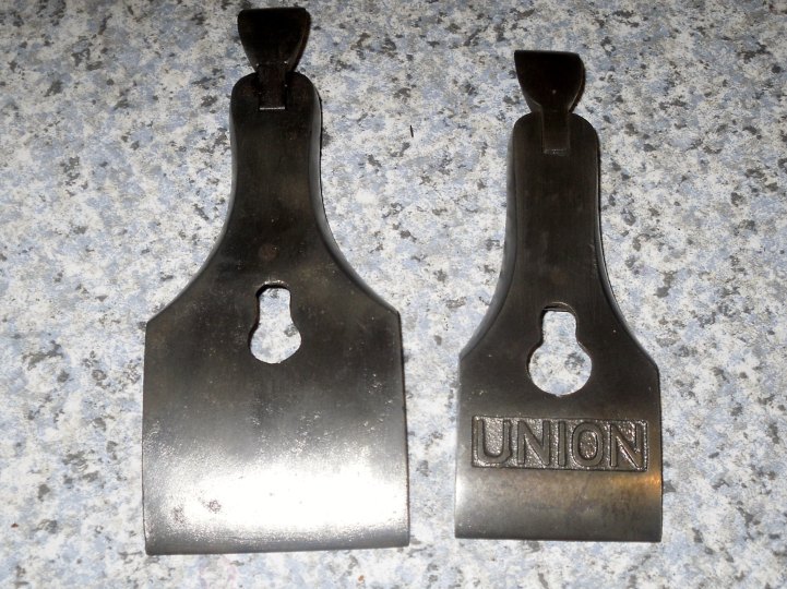

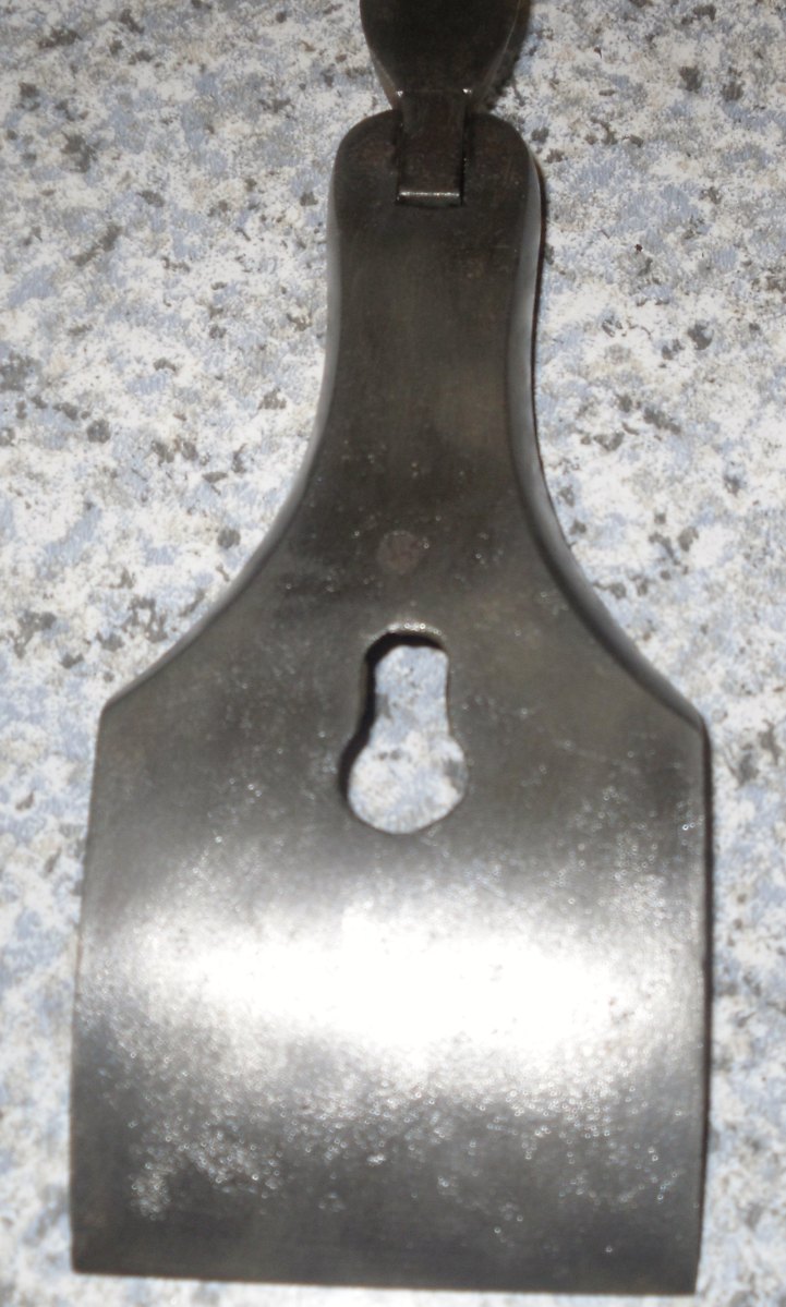

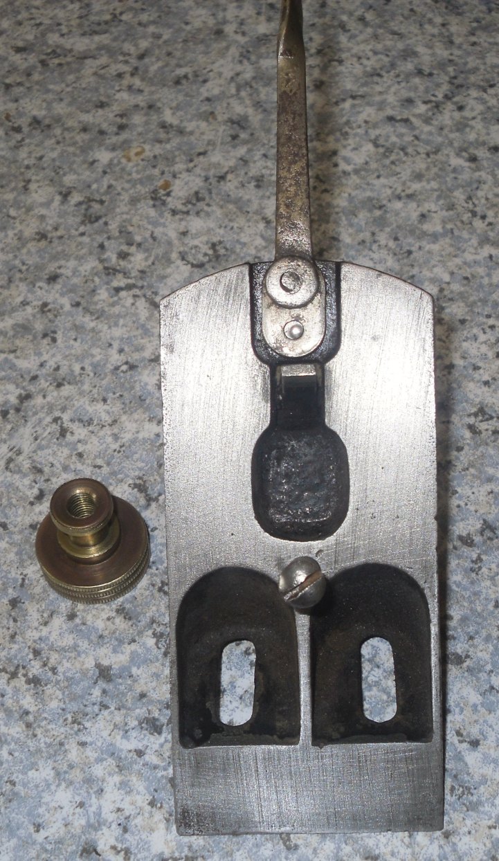

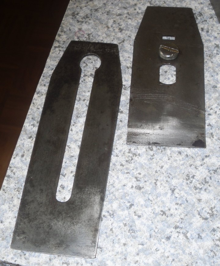

Gave the small parts an overnight soaking, in apple cider Vinegar.    hey at least they smell better.     All the bolts, washers, posts, and the brass went in, along with the frog, and the lever cap.    Took them out this morning, and wire brushed the bolts clean, shined the brass, and cleaned the rest off to dry.     i even soaked a bunch of my saw files, as well.   Anyway, here is a "Rogue's Gallery" of parts:ning-sdc12595-29070-77.jpg?width=721Frog and brass,ning-sdc12596-29070-23.jpg?width=721early style Union Lever cap,  flipper was frozen, got it moving real nice, now.....ning-sdc12593-29070-80.jpg?width=721Scary Sharped iron, and chip breaker.   iron is 2-1/4"  wide.   I also cleaned the bolt between these two.    As for the body, what looked like "patina" was just a dark brown RUST.     Cleaned the sides and sole last night. ning-sdc12599-29070-88.jpg?width=721looks better now.    As for the 'woodwork' on this plane,   there is a wood that starts with Mah......   this is that wood, as Union Mfg Co. of New britain CT.   didn't use rosewood for handles.    Stanley bought all that up.   Up next?     paint stripping, what is left of that japanning ain't worth saving.     A couple coats of Rustoleum Gloss Black should be alright...Grin.gif

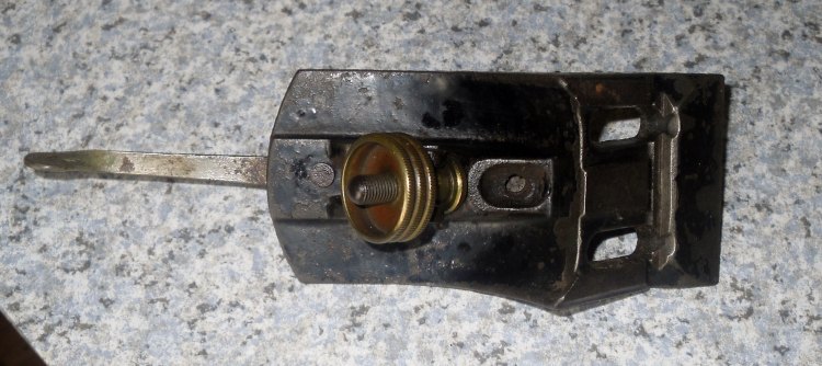

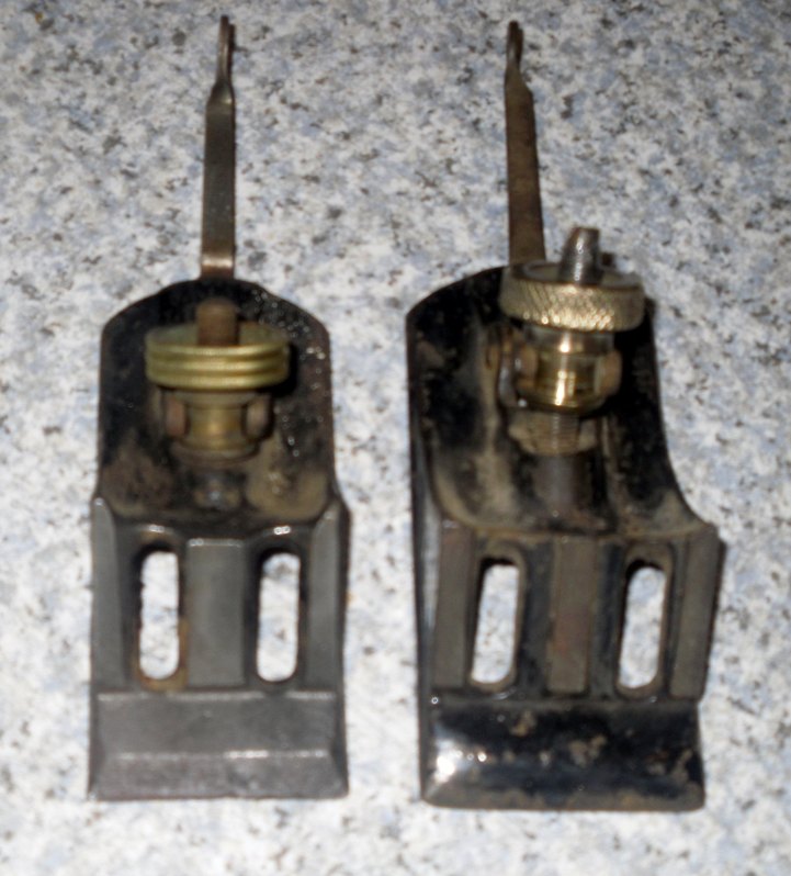

 as for a little box that came today?   One part needed a lot of work, BEFORE I can use it to fix a Union #4G's frog.    #4G's frog is missing a lateral adjustor, and a chunk of iron.    New frog will take care of that.    Seems a bolt that the adjuster wheel rides on was bent.ning-sdc12602-29068-88.jpg?width=721here it is, sitting next to my new #3 frog.  Notice anything different?     Ever see one of these bolts with a slotted, tapered end on it?  AND bent, to boot?      Got out the tools ( clamp for the back Porch Bench, Big Ball Pean hammer, couple of visegrips) and removed the offending bolt.   Took a while though.    I did keep the wheel, i can always re-thread it.   I can use the hardware off the broken frog this will replace, as well.   Let's see, you've seen two out of three parts from that little box, how about the third?ning-sdc12605-29068-12.jpg?width=721Mutt & jeff???   Sitting beside it's Big Brother, is my new  Union #3 lever cap.   Got a project for it, later on....
