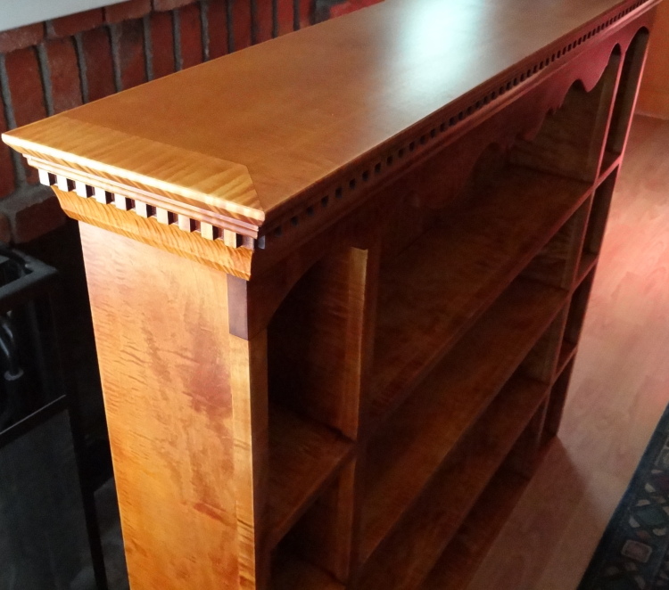

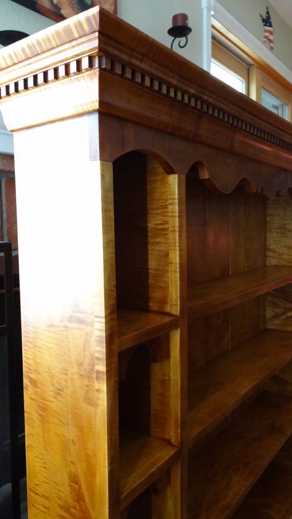

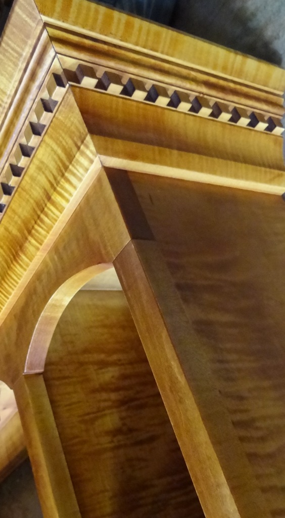

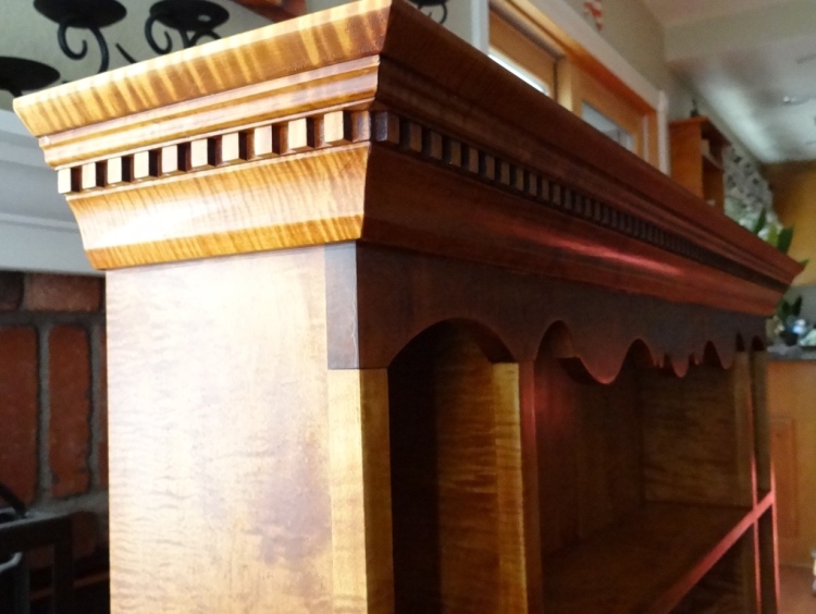

Well I just put the last coat of finish on the cabinet last weekend and it turned out pretty nice. I love the color and the figure. The wood is curly maple, the design came from my customer who submitted the first photo to me to use for inspiration. The finished pics are scarce on shots because I could not get the lighting to work very well, I tried some full frontal shots but they all turned our lousy on the stained and finished piece.
The stain is Transfast Early American Maple mixed to ratios per instructions. Followed up by a heavy coat of BLO, a coat of 2lb clear shellac sealer, then three coats of Varathane oil based satin.

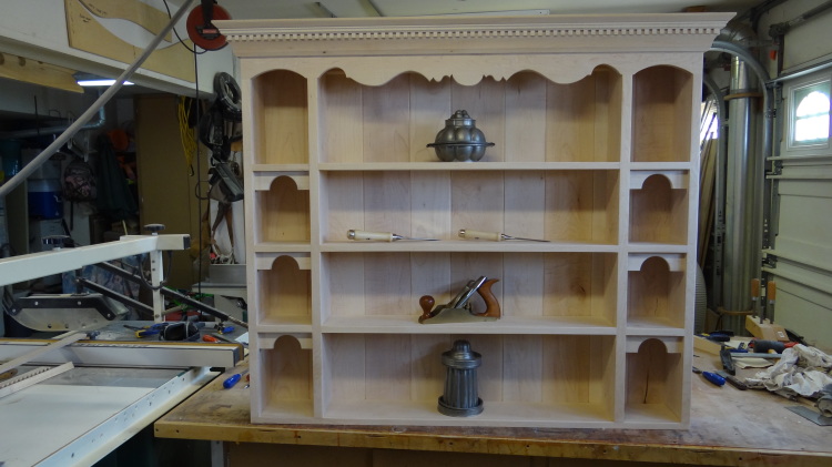

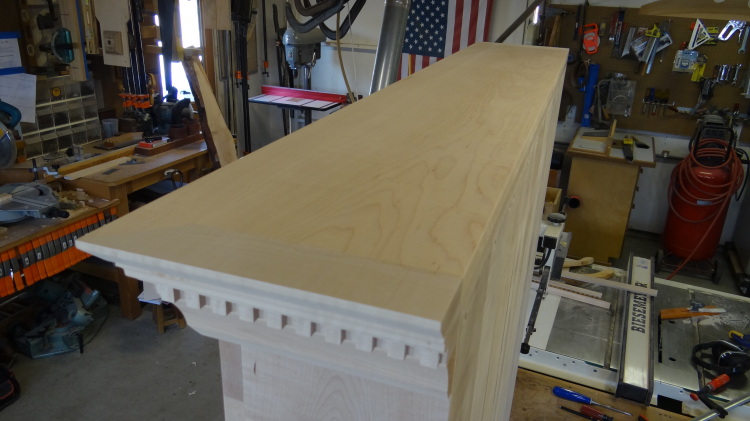

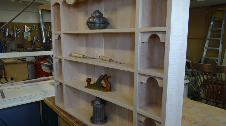

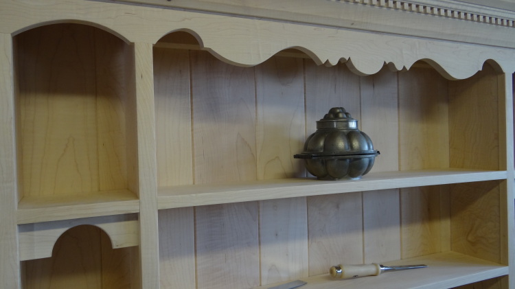

The first shots have been seen already here but I'll post em again, then the final shots are the finished cabinet. The cabinet will be hung on the customers wall to hold the pewter molds you see in the first picture. And my beloved No.3 Lie Nielsen Bronze on the second shelf and a couple nice chisels on the third shelf.

Now the finished set of pictures
ning-bunnfinal4res-29051-39.jpg?width=75
ning-bunnfinal3-29051-36.jpg?width=750
I could only get pics from this side! The lighting was horrible everywhere else in our home. For now though the cabinet sits in our living room waiting for the finish to cure well before I man handle it in place on the wall of our customer. This was fun job for us, our customer has seen these photos already and he is very pleased. Now, I gotta mount it somehow!!! I proved a nice strip of lumber at the top inside back for screwing purposes, but I need some reeeeallly strong screws. The cabinet weights in around 80 to 100 lbs. And it's going to hold about 24 of those really nice pewter molds. So any suggestions on screws would be welcome. Thanks for looking guys! You can also see our display at Courtland Woodworks Works in Progress.

Wow John, just saw the pictures of the cabinet. It is awesome. Boy you got to love that Curly Maple. It finishes out and looks great.
I would go with Randall and use the #10 screw. I think it will do fine for this application.
