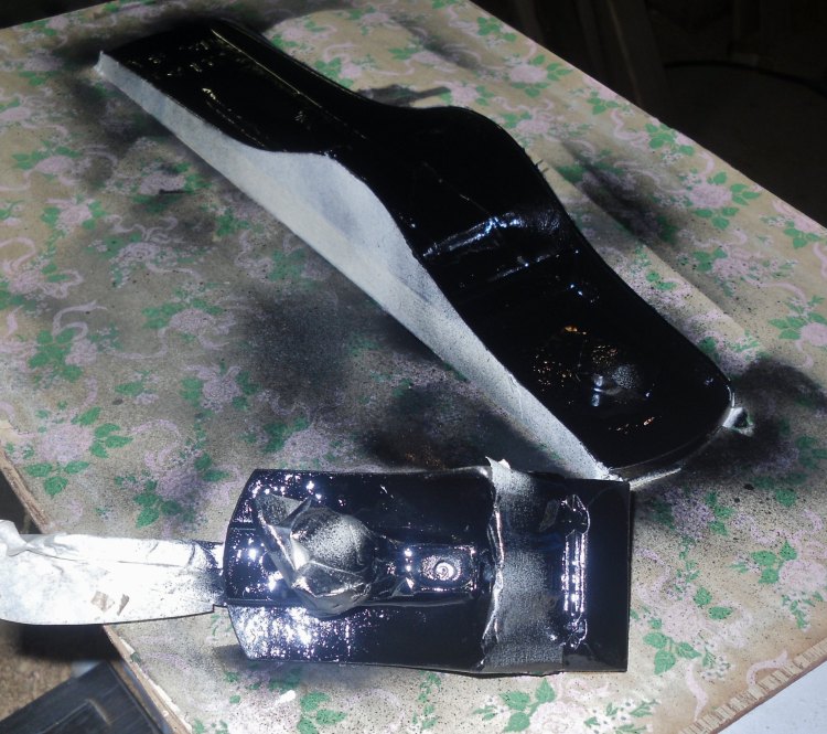

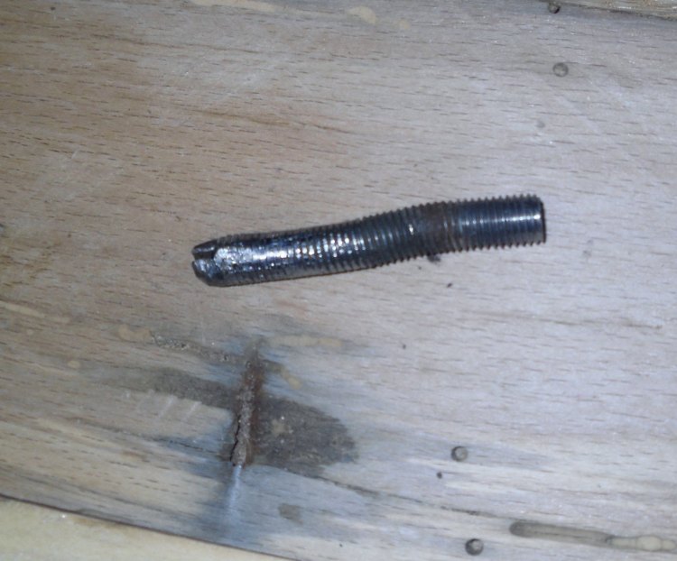

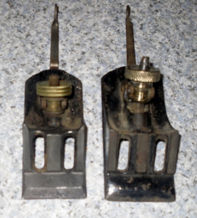

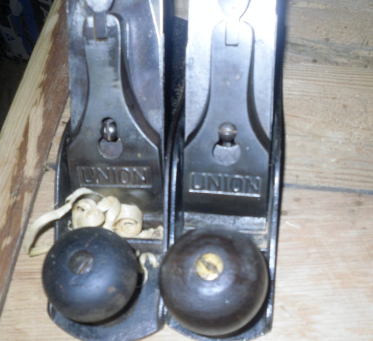

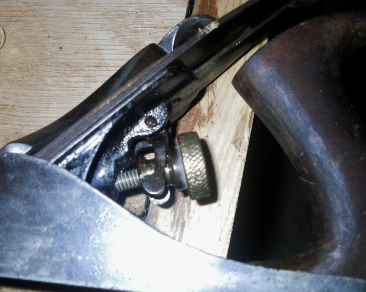

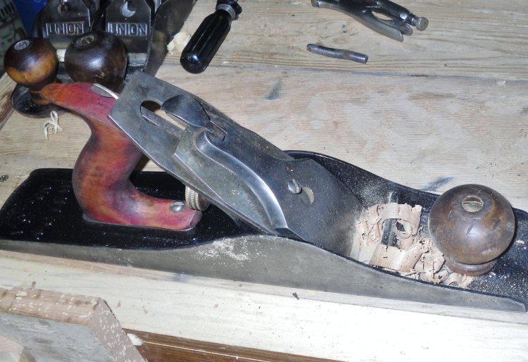

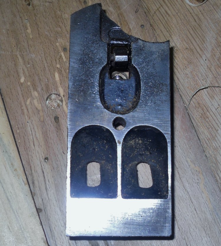

June 2, 201214 yr comment_28866  well, i got a few parts in those two little boxes this past week. Time to put them to use.   I strppied the Union #5A down , and sprayed the base with some "Carb. Cleaner" and let it soak awhile.   Ran the the frog under the wire brush on the drill press.   All the smaller parts were already cleaned, after an over-night soak in Vinegar ( Apple Cider Vinegar, thank you) once the frog was cleaned off of the old paint, out came the masking tape. Just waiting around for the CC to finish up.   While waiting for that base to get "happy", i decided to work on another frog,  Seems my Union #4G had a piece of junk for a frog...Notice anything missing??  Just so happens, I had a "spare' frog that came in the second box the mail brought by.   Upon looking it over, something alos looked a bit "funny"A #3 frog on the left, That #4 frog on the right. Notice the bolt?  Just a little bent. Got the wheel off, and started to remove that ugly bolt, finally got the ba#@#d out. Ugly?? Nah.   Ok, went to use the bolt out of the old frog, hmm , wrong threads.  Old frog= left hand threads vs "new' frog needing RIGHt handed threads?    Looked around for a spare bolt of some sort... ah, an old "C"clamp.    Right size ( or close enough to tap some threads) just a tad long.  Got the new "bolt installed, cut the end off with a grinder ( hack saw went awol long ago) and put the new frog in it's new home. Not too bad.   let it 'wear in" a bit, should be fine.    Older Unions used right hand threads, stanley came along, and all thread turned to the left.   Well I was at it, used the old frog's wheel to replace that buck Brothers #5 pot metal wheel.  I also had a "new" Union #3 lever cap in the house, so... Franckenplane my Defiance #3 for awhile.I went on the refinish that knob on the #4.  More on that later, time to mask and spray two items.While the paint dried, Worked on some handles. The tote was hand sanded until all the old finish was gone, found a surprise as well.   The two knobs were chucked up in the drill press, spun sanded until clean. #5A's knob also was a surprise.   The number 4 was just as strange looking.  Since i had them ready for a 'finish' i oiled them down.   While the two knobs were on the drill press, an oily rag was held tightly on each.   The tote was "Hand Rubbed'.   OIl?   In a "Poly shop?   Yep, 3-n-1 oil.   Ok paint finally set up enough I could put this big guy back together.   In the background of this next picture, check out that crazy knob on the #4... Here we go...Took it for a "Test Drive' on that 1x in the leg vise.  How do you spell MAHOGANY???? 'and may the road raise up to meet ye' Report

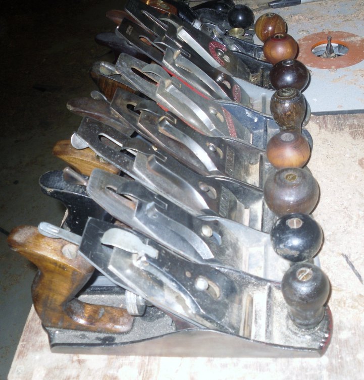

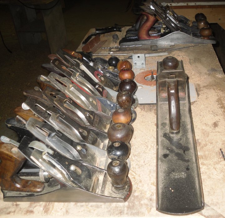

June 9, 201214 yr Author comment_28875 The little guys: Three #3 sized planes, four #4 sized planes, a scrub plane and two block planes. As for those in the backgroundL-R Worth 13.5" Jack ( with cambered iron) Fulton 414 Jack ( no camber) Buck Brothers 14" Jack ( slight camber), and the Big boy Union #5A "super Jack) (little camber, just the corners) And lastly That camera hogging Bailey #8c.   Almost as long as the row of "Little" guys.   MIGHT have another jack coming next week...... 'and may the road raise up to meet ye' Report
