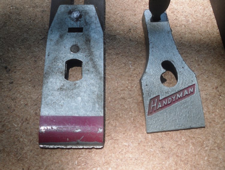

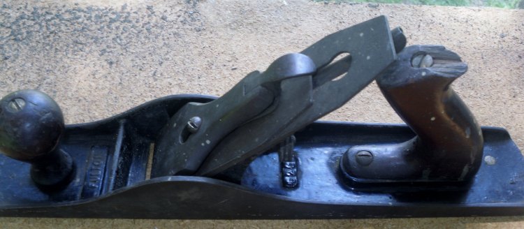

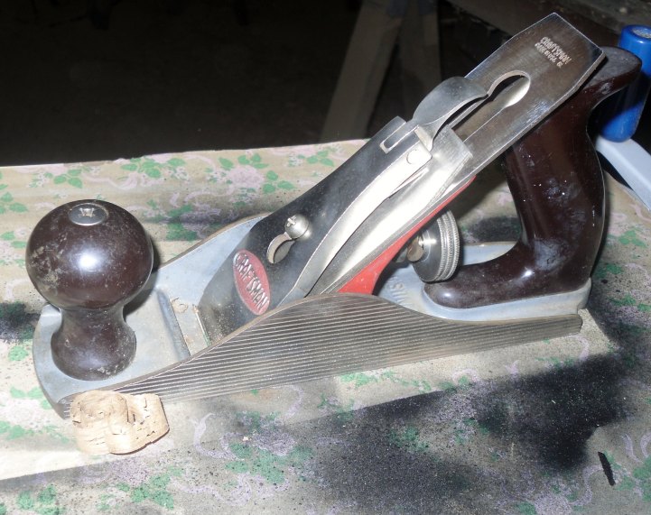

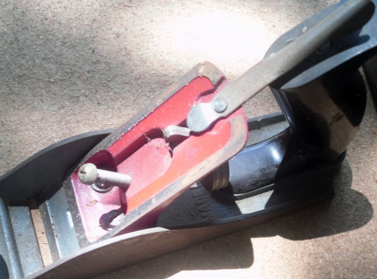

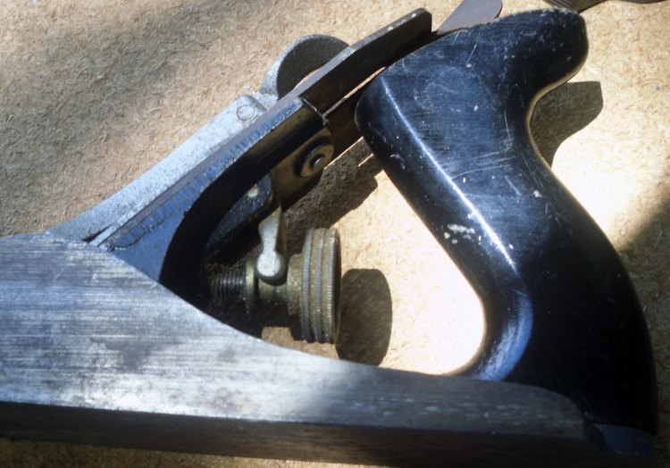

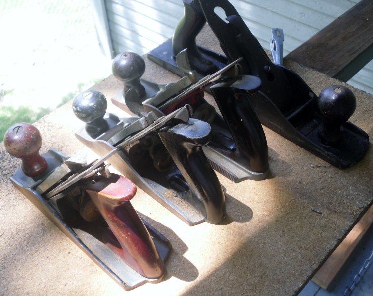

At least today.     USPS and UPS showed up today.      Here is a "Group Photo" of what came :ning-sdc12646-28725-27.jpg?width=750Two number 3 sized planes, a number 4 sized, and a 14" long Jack  ning-sdc12631-28725-78.jpg?width=750Jack was sold by Fulton @ Sears & Roebuck.   ning-sdc12636-28725-48.jpg?width=750Old red frog, Sears   Craftsman ( a number 3 size) yep, it does have groovy sides, and phillips headed bolts....ning-sdc12639-28725-49.jpg?width=750Stanley Handyman H1203   A stanley #3 size.   ever see a chip breaker like this??ning-sdc12641-28725-72.jpg?width=750yeah, yeah, needs a little sharpening.    And last but not least..ning-sdc12642-28725-9.jpg?width=750Millers Falls No. 9  type 4.   Still has that three point frog as wellning-sdc12645-28725-3.jpg?width=750Looks like I'll have something to work on while I'm off......Grin.gif

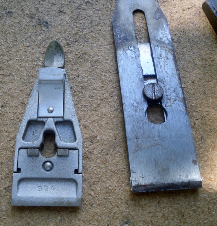

 Spent about an hour out on the back porch bench.    Cleaned up the handyman H1203.    Chip beaker and lever cap have been galvanized ( WHY??)   but everything else cleaned up nicely.    Base has a coat of Gray paint on it, instead of the normal black.    Debating whether to leave the gray on, or strip it down.    Black frog looks ok.  just a wire brushing.     Sole got cleaned off ( lots of paint streaks, and rust) as well as the sides.   Still have to flatten the sole.

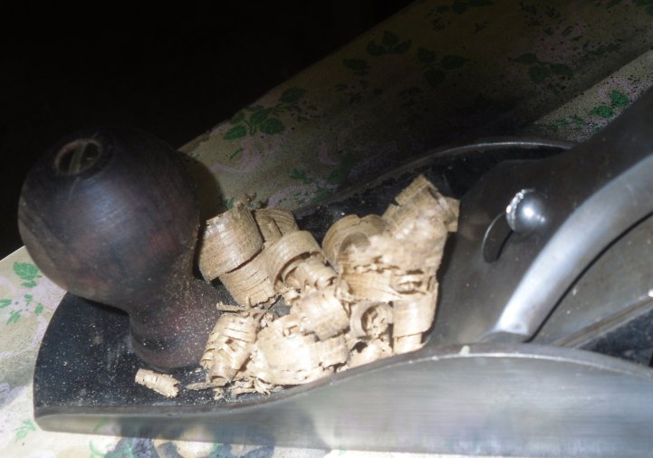

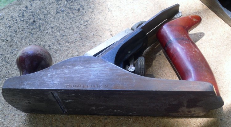

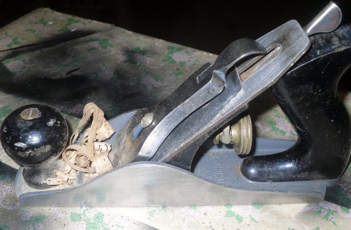

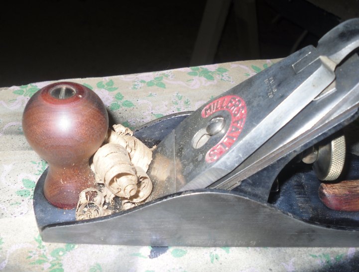

 Took awhile tonight, but got them all tuned up.   No painting this time, wasn't really needed.  However, the Moxxon TP was  everywhere...ning-sdc12647-28730-88.jpg?width=721Stanley handyman H1203  a Stanley #3 sizening-sdc12653-28730-51.jpg?width=721Sears Craftsman #3 smoother.    Groovy sides and all.  ning-sdc12656-28730-1.jpg?width=721Stripped that thick red finish off the handles of this Millers Falls No. 9 ( along with a tune up)ning-sdc12660-28730-70.jpg?width=721Refinished the knob on the Fulton 14" Jack, along with a tune up.    About an hour a plane.

  Seems that Sargent made both the Fulton 414 Jack plane (for Sears & Roebuck) but they also made the Craftsman #3.    The Craftsman I got was a  Hercules clone.  Got a nice long bed to it, longer than most of my #4s.  Iron is still a #3 size @ 1.75" wide.   Plus, it does have those "Groovy" sides.     Fulton may get the tote off of my #129 Stanley.    Might do a even-up swap.   Got both up and running, for now.    As for them "purple plastic handles"     we'll see......

I got a question, I noticed the shavings are pretty narrow, indicating a blade not even across the cutting edge or cambered too much, as it is your only getting shavings that appear to be about a half inch in size. Have you worked on getting those blades to cut more wood? Or are you intentionally cambering them to take only a small amount out of the material? Preferably you'd like to see a shaving almost nearly the same width as the blade, unless again, it is cambered, but even a properly cambered blade should produce shaving about 3/4 the width of the blade.
Shavings are 3/4" wide, due to my planing a 3/4 wide piece of scrap oak.    Fulton is not cambered, yet.   Not counting shipping costs,  these four planes cost a whopping $12 total.       Works out to be about $8 (counting shipping) each.    Not bad when one of them turns out to be a Millers Falls No. 9 type 4.
