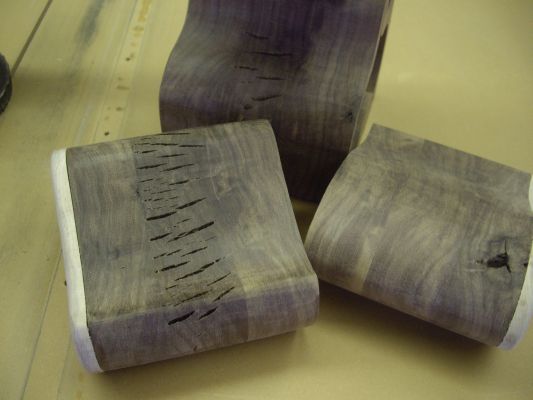

However, after cutting out a band saw box from a glued up chunk of walnut, several nasty stress cracks appeared in the middle 8/4 piece of the glue up.
Here's what it looks like. The piece to back is the part of the body of the box. The piece left is one of the drawer blanks. You can see that the cracks went pretty deep and got more numerous as they got deeper. The piece on the right is also a drawer blank but, it just has a knot hole in it.

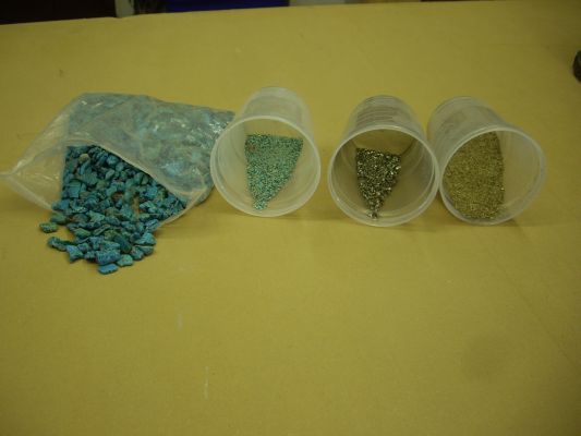

The picture below shows some of the material I'll be using to fill the cracks in the body of the box. I'll just use straight blackened epoxy to fill the drawer blank cracks.
From left to right: Turquoise nuggets, crushed Turquoise, Iron Pyrite, brass filings from Ace's key duplicating machine.

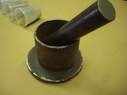

This is my "mortar and Pestle". Just a length of well drilling rod, a piece of well casing and a circle of steel plate. It's not connected so I can just dump the material on to my screen after crushing it.  BTW, fry pan splatter screens make excellent sifters. Phyllis made me go buy my own.Grin.gif

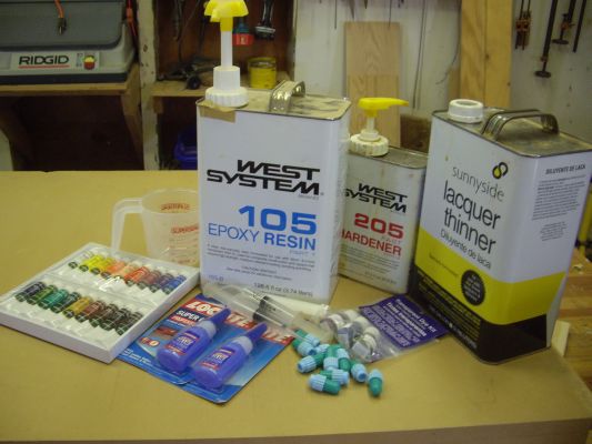

This pic shows some of the other materials necessary. On the left are acrylic artists paints to color the epoxy, if needed. Of course, a measuring cup, the epoxy and lacquer thinner for clean up.
In front is Super Glue that I use in smaller cracks. Laying on the super glue are plastic squirt devices like hypodermic needles.They sorta kinda work. In front of the thinner is some tints if I want a translucent look to the epoxy. And, those little blue and green things are capsules of dental silver or, amalgam. Not shown is the device I call a jitter bug that mixes the amalgam. Each capsule will yield enough silver To fill a 6" groove 1/8"X1/8".  It's mostly used for initials or to highlight other designs.

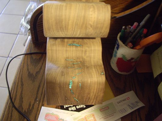

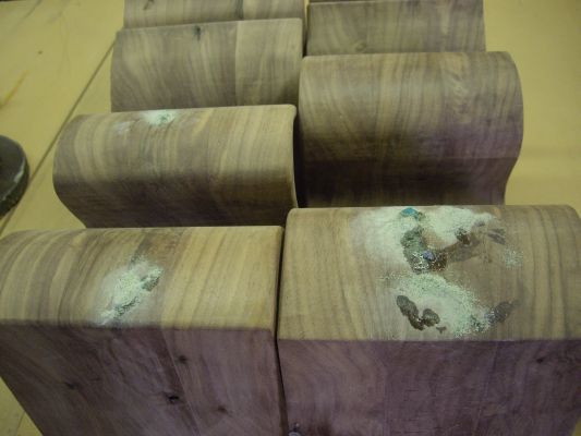

I finally was able to get in the shop and fill the cracks with turquoise. These were small enough so that CA could be used.
The first pic is after filling. Ugly, ain't it?
The next one is after the first round of sanding. The second box is still awaiting the sanding.
The stones "pop" more after finishing.
Gene
