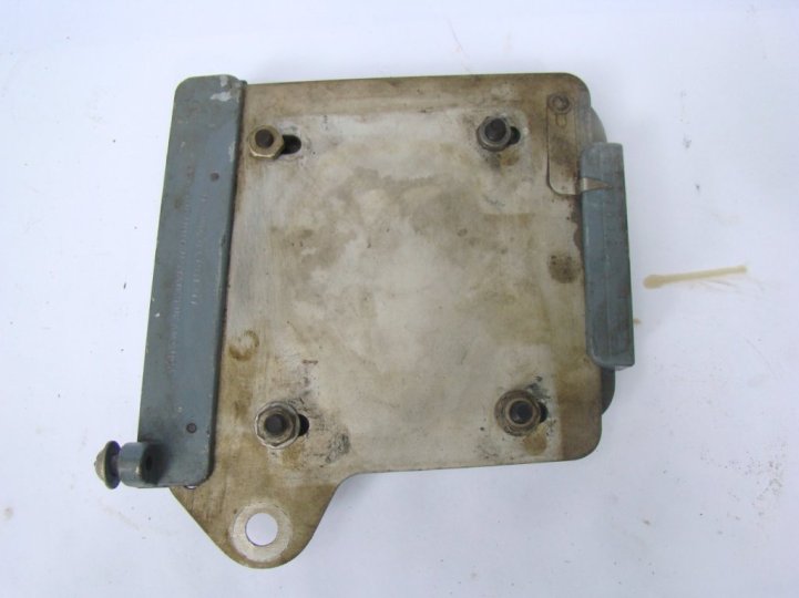

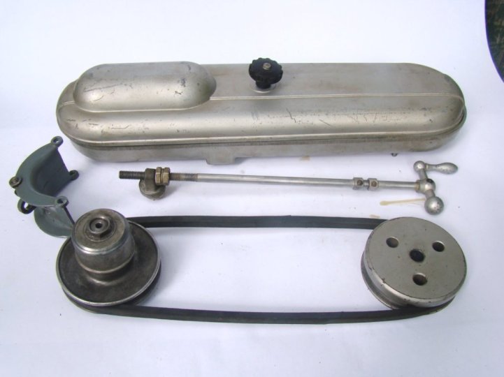

June 15, 201214 yr comment_28314 Steve, There are several ways of doing variable speed on these lathes. The original pulleys would give you 4 speeds. Adding a lineshaft assembly will give you 16 speeds. If you are using a phase converter to run a 3 phase motor a variable frequency drive will give infinate speed control. You could also adapt a Reeves Drive pulley set up which would give infinate speed control using a single phase motor. This one is for a Delta scroll saw. As far as conversion kits, I myself have never looked for one. The lineshaft parts do occasionally show up on ebay, the variable speed scroll saw drive shown above is listed on ebay now (Buy It Now $225.00) I use the lineshaft setup myself. Larry Old Woodworking Machinery Forum Host Report
