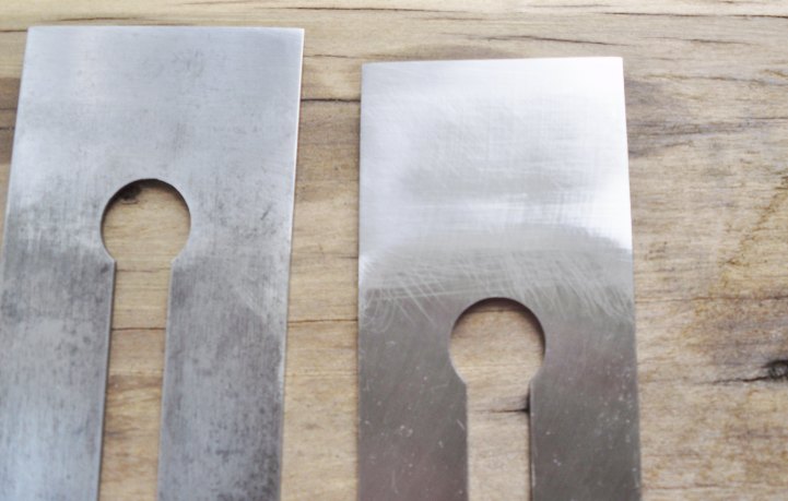

July 14, 201214 yr comment_26999 yes it would do the same thing but by not doing the full surface you get a slight angle (1/1000ths) on the surface. And that changes the blade angle and the cutting angle. My test is this- if i cannot adjust the plane to remove a pencil line from the surface of the wood without digging out a huge shaving of the whole area, it ain't sharp enough. and the adjustment is off. Report

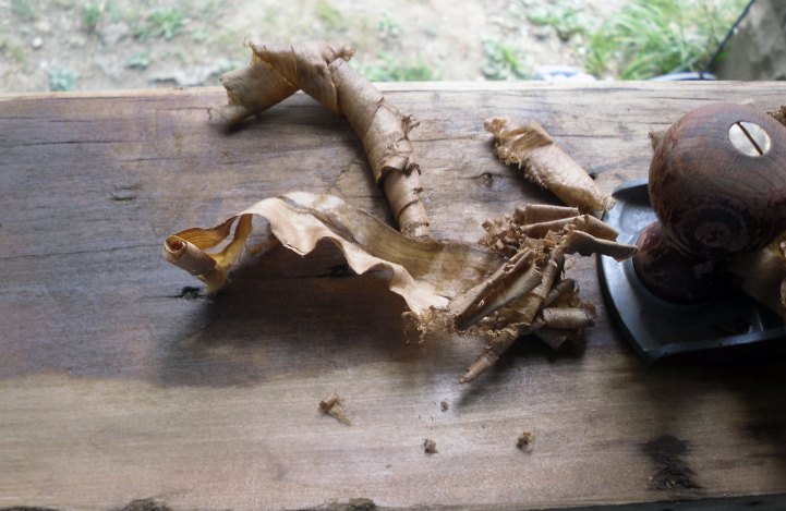

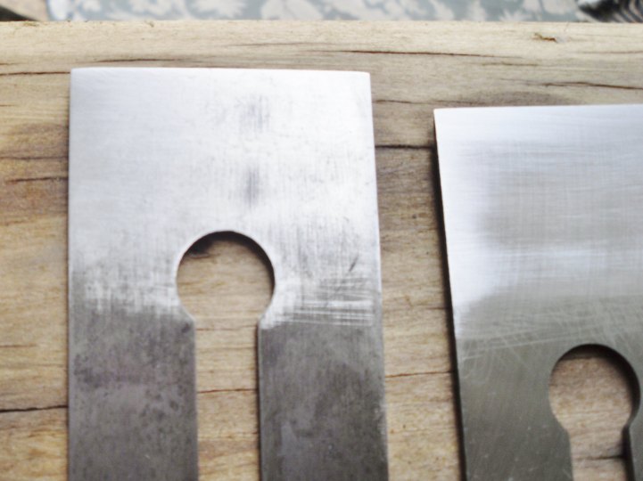

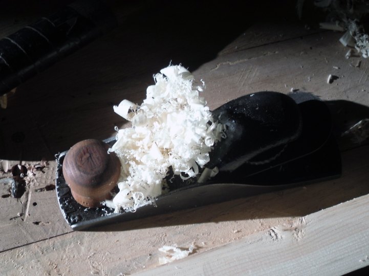

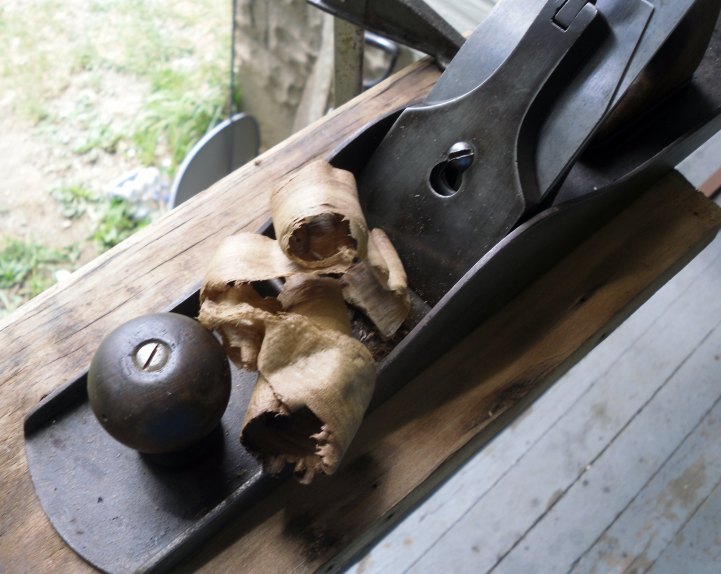

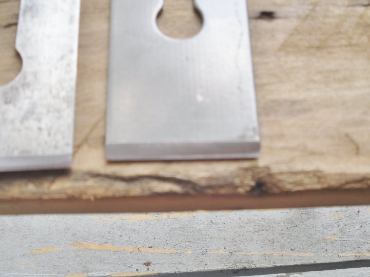

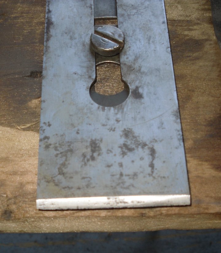

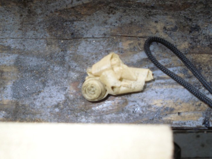

July 14, 201214 yr Author comment_26998  These irons aren't quite to a Mirror Finish, 90 yearold Sweetheart iron, next to a 5 year old (?) Buck Brothers ironA look at the BB iron.   I will even do this for a block plane IF they need itThe edges are what matters on these bigger ironsThis one will need a grinder first, too many pits along the edge.   The Buck brothers came out nice thoughI also worked over an iron from a Craftsman #3. Went the full length of a piece of poplar, and got this little rollMight be sharp enough for what i work on.... 'and may the road raise up to meet ye' Report

July 15, 201214 yr comment_26996 Personally I believe it effects the angle that everything comes together with. I polish mine and make sure the cb and the iron fit right with out changing the angle of the iron. I will also do a slight back bevel on my chisels and they stay sharp longer and touch ups are a breeze. I guess it is all about the fit which effects the performance and the longevity of the edge.Wayne MahlerGod bless and protect our troops that serve so we can be free. Report

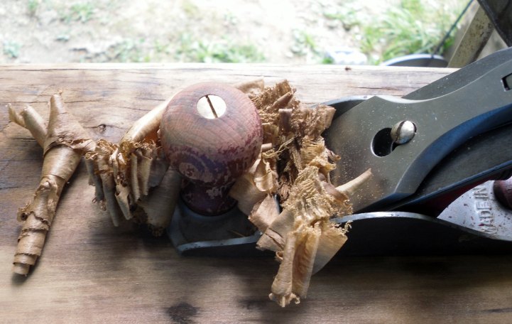

July 15, 201214 yr Author comment_26995  A test drive after the sharpening:The Buck Brothers iron, sitting in a just out of the box parts plane.  I hadn't even tuned the plane up, just slapped the iron on-board.  Nice and thing curly things. As for the "New&Improved #6c"? Quality Control has given it their "OK"... 'and may the road raise up to meet ye' Report
