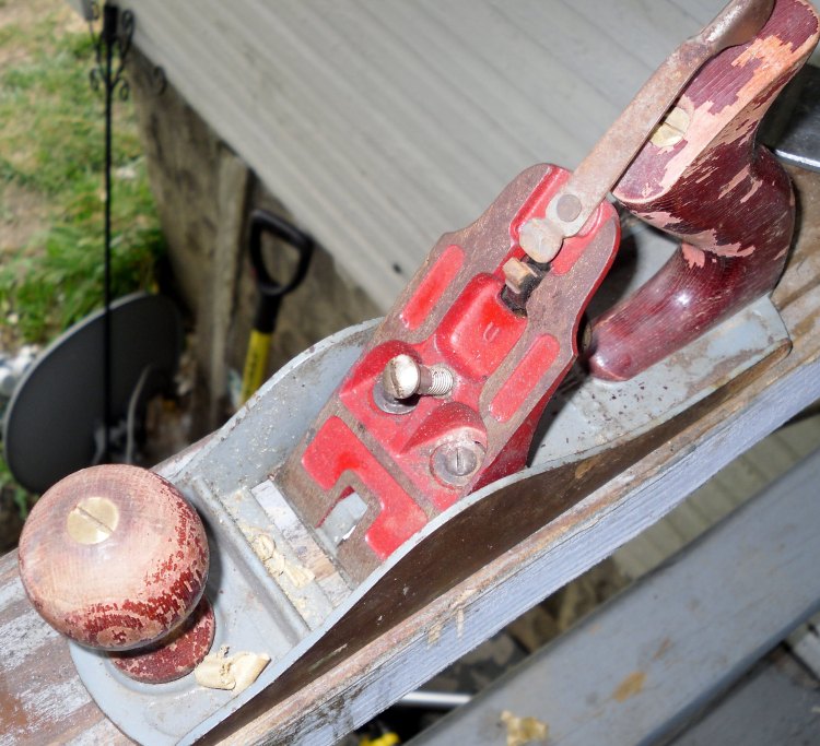

  So, I have the #6c almost done.   Time to gear up for the next phase of this project.     Goal is to build, from "scratch' a Bailey style #5 Jack Plane.     I needed a few parts to show up first.   The base is on bid right now, know more later.   The Iron i had, a Buck Brothers 2" wide one.     The frog showed up this morning, riding on a parts plane that came in the mail.   ning-sdc12852-26986-75.jpg?width=750A later type one, I know.   The knob will work as well, after I refinish it.   Tote? Might have a use for it as well, but, I need that bolt.

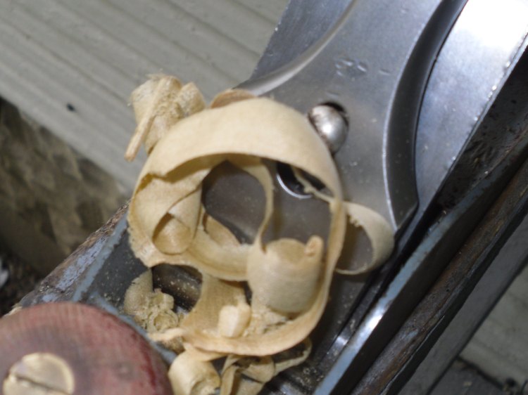

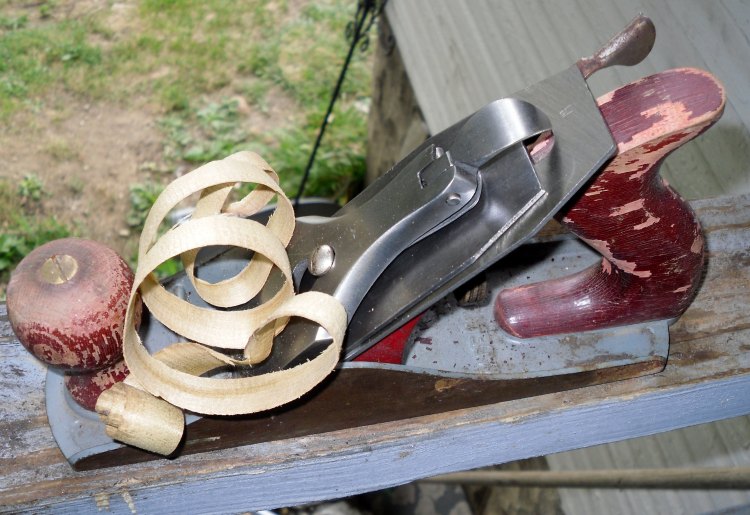

Some other parts showed up this morning as well.     A 2-3/8" wide iron for the KK7, a 2" wide chipbreaker, and a 2' wide lever cap.   The last two will go on the #5 project, but for now, a test drive along Poplar Alley...ning-sdc12849-26986-71.jpg?width=750Had it a might deep on this first pass..Grin.gifning-sdc12851-26986-10.jpg?width=750Just a little better.   Iron is that Buck brothers iron i sharpened up the other day.    I had the Poplar set up as an edge grain test bed.   These are full width, and full length shavings from it.

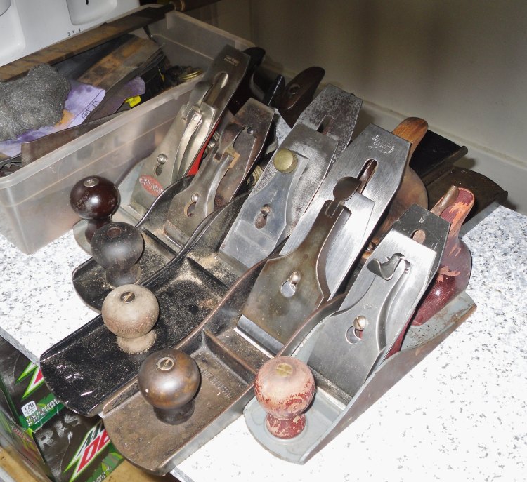

Project Plane Central...ning-sdc12853-26986-13.jpg?width=750From the back of the row:   Craftsman #3, Worth #5, KK7, "Bailey#6c", and a "Stanley #4?"  First two are for sale on the bay, right now, the two big guys will be heading out to the Pole Barn Woodshop, and the parts plane might go along.  Depends where I plan to work on things...Grin.gif
A Stanley/Bailey #5 base is on the way, be shipped out monday.    Foundout the New iron i put into the "new" #6c is a Berg iron, has a Shark logo on it.    made in Sweden, no less.    Traded a stanley pre-Sweetheart iron for it.     Franckein Planes just keep getting "Franky-er", don't they?   Parts plane has a lot of Sargent Tool Co. looks to it.     It Should fit the base that is coming in, though.
