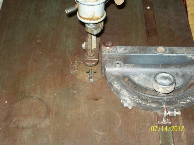

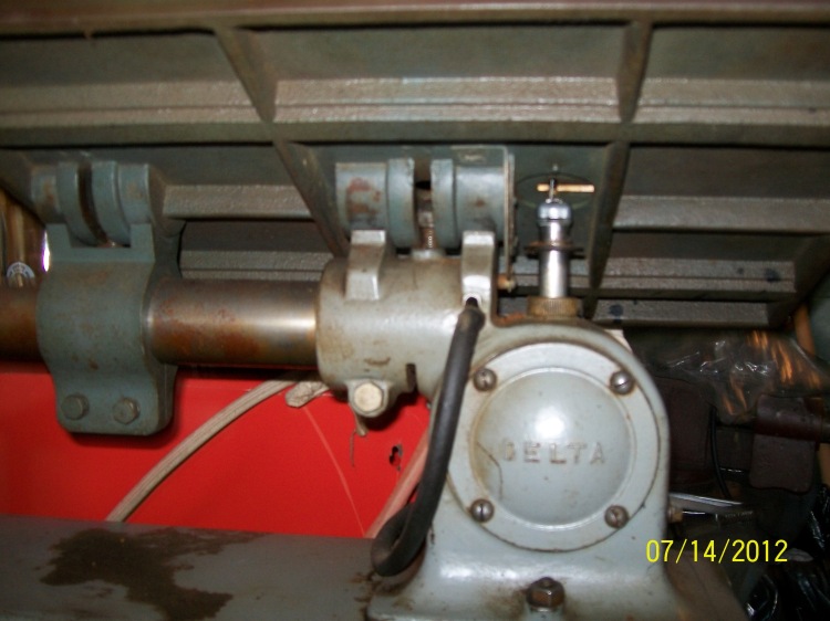

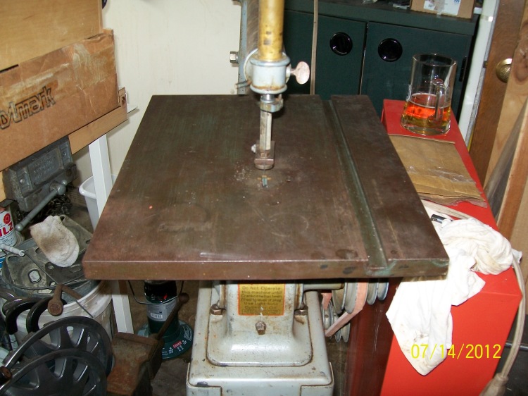

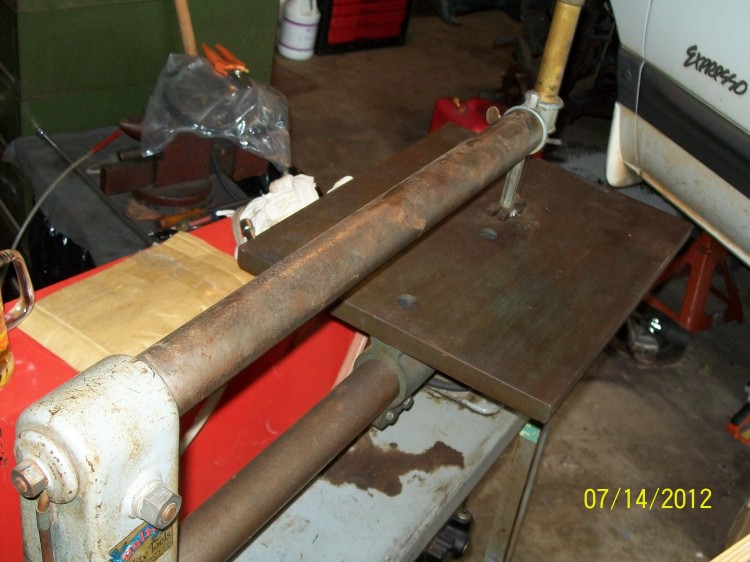

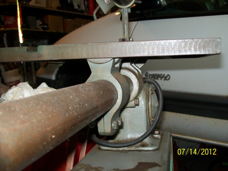

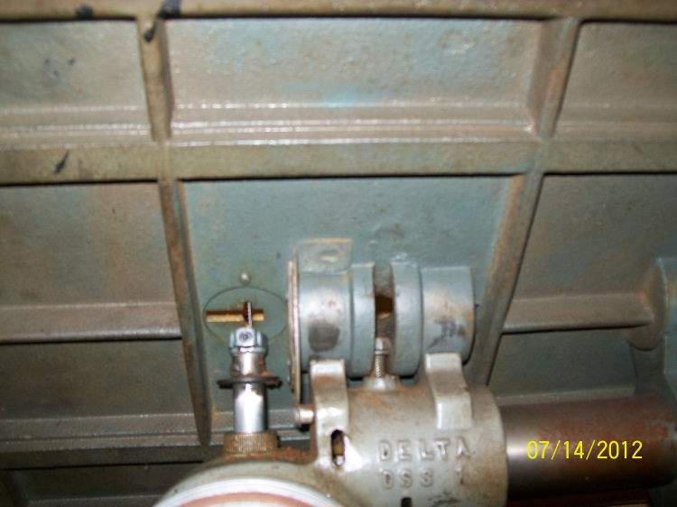

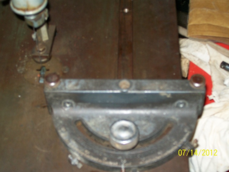

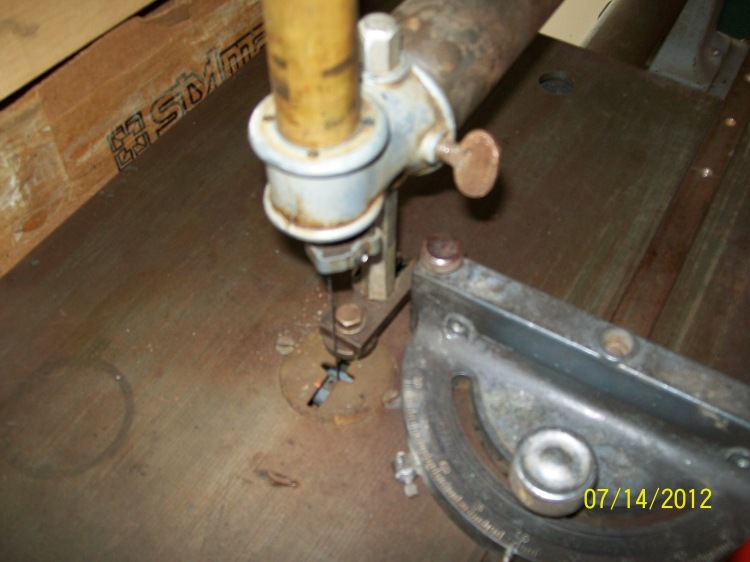

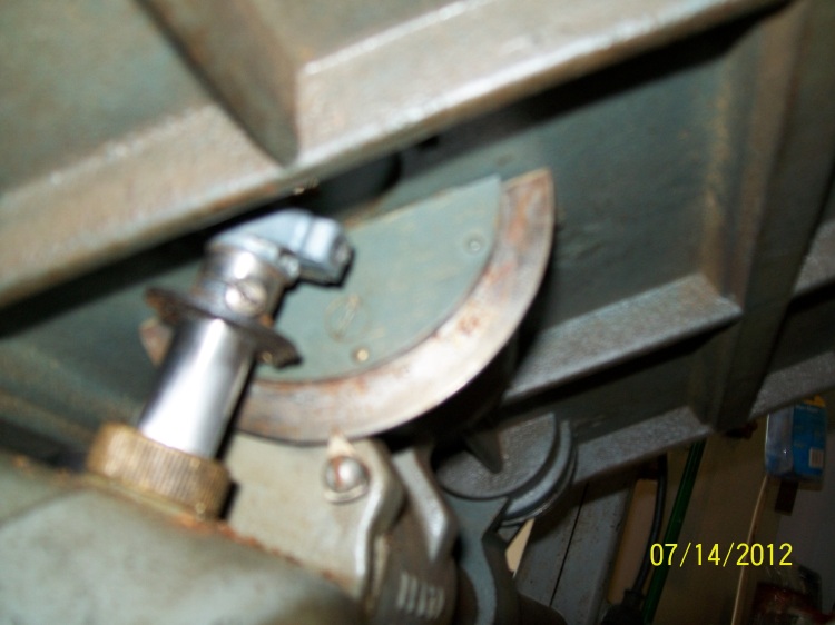

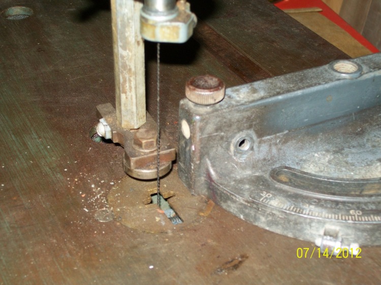

July 14, 201214 yr comment_26967 "Back From The Archives" Dateline: July,14,2012 , Location S.E. Wisconsin, Your roving "Old Machinery" reporter, has photograped a 1931-1937 Delta Specialty Co. Model # 700 Scroll Saw.....Yeah, I know " Big Deal ".... What's so special about spotting a Delta Specialty Co. Model # 700 Scroll Saw? A cast iron tabled with miter gauge slot, Model # 700 Scroll Saw that's what! Wait a minute.....A what?.....As found in the wild..... As the above photos show, at least one exists. The table is a one piece casting with the only identifying detail being the use of the normal Model # 700's angle gauge. It has been drilled and mounted to the cast iron table using drive screws through the face of the gauge. The rear trunnion mount is also a cast iron, machined piece. I searched the catalogs from 1931-1937, the years of the Model # 700's production run, but couldn't find any reference to a cast iron Model 700 Scroll Saw table. So is this a Delta prototype design?, or a rare Delta accessory? Edited November 11, 20188 yr by Larry Buskirk Report

July 15, 201214 yr Author comment_26982 Lew, The photos that you linked show the normal stamped steel table, like the one to my 700. This is the table that is shown in all of the photos in the catalogs, and all of the photos on the Vintage Machinery website there are about 30 photos of machines there that all have the stamped steel table. I should have included photos of the normal table in the earlier post. Edited November 11, 20188 yr by Larry Buskirk Report
July 15, 201214 yr comment_26981 Man that sure is a beefy rascal! Edited November 11, 20188 yr by Larry Buskirk Report
July 15, 201214 yr comment_26980 That's a new one for me, very interesting. I have never seen one with the second set of trunnions mounted to the post like that. It definitely looks factory made. I bet it really makes the cast iron table very steady. If that is what they originally came with I wonder why they ever switched to the stamp steel tables. I hate the little flimsy one on my Delta Specialty saw. Are there any part numbers cast into the table? Very Cool Larry!!! Thanks for sharing. Edited November 11, 20188 yr by Larry Buskirk Report
July 15, 201214 yr Author comment_26979 Shane, The only identifying mark is on the angle gauge, it is the same as the one used with the stamped steel table. I could find no other marks, casting numbers, etc. This saw belongs to a friend of mine. It was his grandfathers. It is not for sale. I have to wonder if it was a prototype idea that did not go into production due to cost, or it may have been to labor intensive to manufacture. But it sure looks like a factory made item. The miter gauge that I used for the photos is from my Delta 1160 Table Saw / 1188 Shaper. It looks like the table was designed to use the standard Delta miter gauge. I have to wonder after seeing this if there was a similar cast iron table for the Delta Specialty Co. Model # 785 bandsaw, because it used the same trunnion parts, and angle gauge as the Model #700 Scroll Saw. We may never know. Edited November 11, 20188 yr by Larry Buskirk Report
July 15, 201214 yr comment_26978 That sure as heck is factory made! Great find Larry, bummer it's not for sale, on a side note I love the one you restored. I think you mentioned he as other saws like it, does his other saws have the cast iron table? Edited November 11, 20188 yr by Larry Buskirk Report

July 15, 201214 yr Author comment_26974 Shane, After seeing this Model # 700 Scroll Saw, Who knows? Maybe we'll be featuring a pre-production run prototype Uni-Saw. I told Ron that I would like to see the other machines, and take some photos. He is going to talk with his parents, and if they say it's ok I'll be taking my camera with. I've got to figure out how to take videos with it. I tried when getting photos of this Scroll Saw, but I couldn't get the video feature working. We put a blade on, and had the saw running when I was by Ron's house. It runs and is real quiet when running. Edited November 11, 20188 yr by Larry Buskirk Report

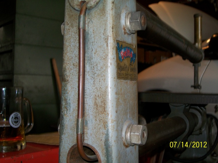

July 16, 201214 yr Author comment_26972 Dan, I found it to be an interesting machine, in that I cannot find any information regarding the cast iron table. It also has a prebent steel tube that goes through the frame tubes for the blower that I had not seen on any other Model # 700 before. All of the others that I have seen used a 5' piece of rubber hose as per the manual. Otherwise this machine appears to be like any other Model # 700, and is in remarkable unrestored condition. The only part needing to be repaired or replaced being the blower-nozzle bracket. It is present but broke off where it mounts to the blade-guide plate. Both pieces are there so it will likely be repaired. It even has the normally missing original factory supplied tools for blade changes, and table adjustment still with it. Edited November 11, 20188 yr by Larry Buskirk Report
