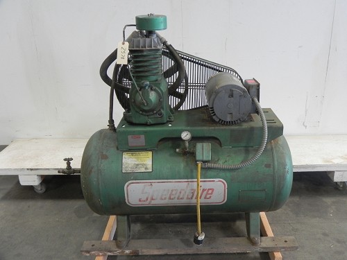

The auction site did have a few pictures of the machine and it appeared to be in decent shape and they did state the motor was burnt. I figured that if I got the head and tank for under a $100 I could add a motor and be in business. The pictures were decent but then again so were the planer pics and we all know where that machine is, needing about $500 in parts.
I have not had much time nor success in being able to find much info on the compressor. It is a 60gal horizontal 2 stage design with a 115/230V single phase motor that is "burnt". It is a Speedaire brand distributed by Grainger. I have contacted Grainger and they were able to pull up a parts diagram but no other info was available. BUmmer.

So I get the machine home and give it a quick once over. I pulled the cover off the motor electricals to confirm wiring and its wired for 220V. Cool I have 220. What did I have to lose buy trying to run the motor even though the auction company said it was toast. I found an old Cutler Hammer mag starter that was wired single phase that I have for my jointer, which still isnt finished, wired it up and plugged her in. What did I have to lose? Either the motor would run, trip the breaker or nothing would happen. I flipped the breaker and voila the motor started right up. It ran for about a minute before shutting off. The overload heaters in the starter were too small and they tripped out. So, I removed the starter and wired without it and plugged it back in and once again flipped the breaker and it ran perfectly. It pumped to 120psi in about 3 minutes and then shut off.
It sat in the bed of the truck for next few days until I could get some help unloading, its about 300 lbs and awkward to lift. It now on the ground and I will get it cleaned up and painted. I plan on changing the pump oil, replacing the air filter on the pump head and new belts. I figure on about $30 in parts and paint. I should a compressor that will out live me if taken care of and best of all no more LOUD Crapsman.
ning-speedaire1-26919-65.jpgNot a bad grab for $41.00!!
