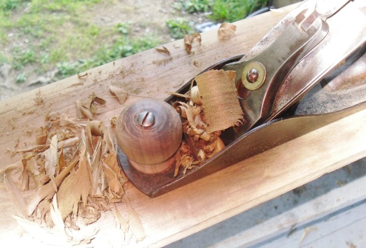

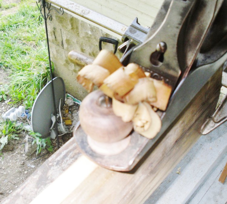

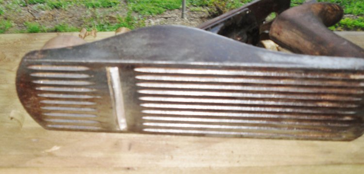

July 24, 201214 yr comment_26469  Is my Union #4G.    G as in Grooved bottom.    Iron was getting a might dull, and I tried out my new stone on it, along with some sandpaper.    Got an almost mirror like shine on the end. Worked on the depth adjuster wheel, and got it to move a lot better. The old "bun" of a cracked knob got replaced as well, with a Black Walnut one.  The bolt that hold the lever cap in place was bottoming out, added a washer to stop that, at least until I can shorten it a bit.   Bolt was from the old, broken frog, wheel was too.  Trying to get them to work with a new frog. Got the plane back together, and tried it outWorking the face grain in Poplar. Like the washer? It is there because the iron would slip backwards.  Wasn't staying tight, unless I really cranked that bolt down.  Not good, so it got a washer.  works much better now.   Before, I could get some thick shavings on edge grainBut the iron would back out on face grain. It will work until I can shorten the bolt.  As for the bottom of this plane?It's groovy.... 'and may the road raise up to meet ye' Report
