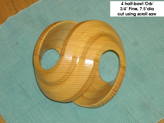

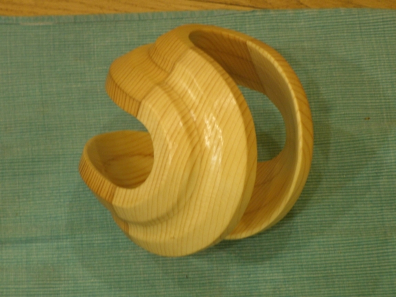

This is the brother of the Orb I posted not long ago... it is made of 4 half-bowls, assembled "inside-out" compared to the Orb. It, too, is fashioned after the work of Malcom Tibbetts, however, I used only the scroll saw to cut the wood, assemble the bowl parts and sand/shape into what you see. This project was made of 1/2" poplar.

The other wood I used for a 4-half bowl project is 3/4" pine:
ning-gedc0621-26435-91.jpgning-gedc0626-26435-93.jpgThe Wavy Ribbon and Bowly Mobius were cut from 1/2" plywood... the methods to make the bowl parts are the same for all 4 of these "ribbon" projects (basically, the "bowl from a board" method, using a 45deg bevel cut for the rings that make up the bowl parts and the ring width=wood thickness).
Formulae: Orb and Orb, inside-out =4 half-bowls, 1/2" or 3/4" thick, assembled in opposite fashion.
Wavy Ribbon=6 half-bowls; Bowly Mobius=2 half-bowls and 10 quarter-bowls
