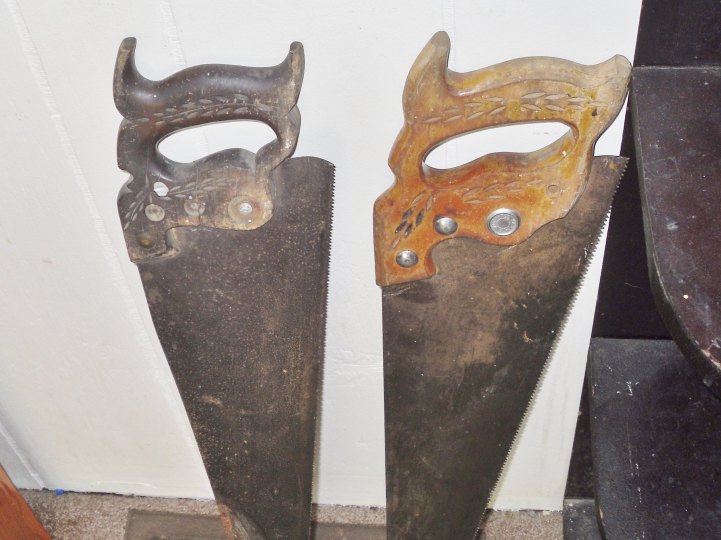

I did a little "Rust Hunting" today, and found two $1 handsaws.    Both seem to be in the 10tpi range.    Might be a little while before they are ready, though...ning-sdc13024-26210-90.jpg?width=721The cracked tote isn't too bad, I can fix that.    The hardware will be the hard part.     Cleaning the plates aren't a bad job, just messy, and very dirty work.    I need to wear OLD CLOTHES doing these sorts of things.   USED to have a sawvise by Disston, until I sold it for lack of work.     I can rebuild the Back Porch Saw Vise in about.....10 minutes.  I have about a dozen or so saw files of different sizes.    Should be a couple there I can use.  A look at the other side of this "coin"?ning-sdc13020-26210-14.jpg?width=721Black handled one IS a 10ppi as it is stamped as such down by the handle.    Not sure about "Blondie", know more as I clean it up.   Both will get a sharpening, as well.   Should be fun...Grin.gif
