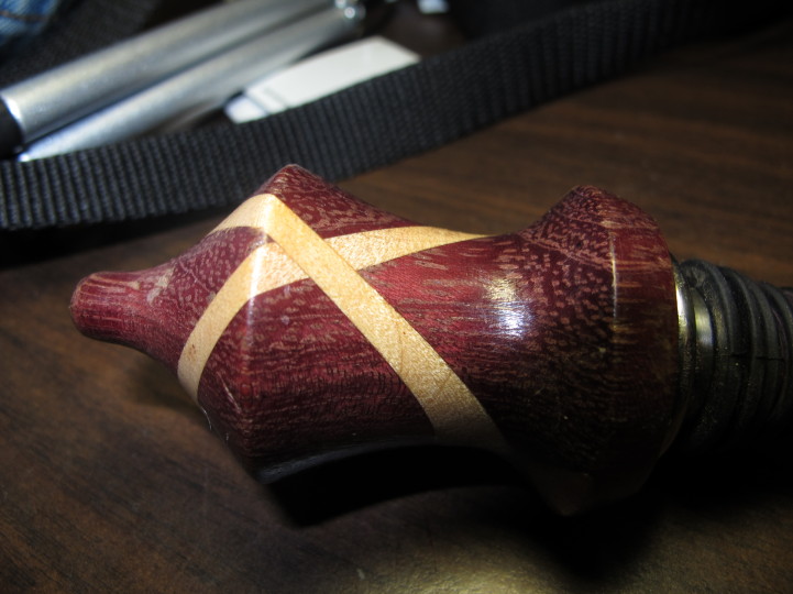

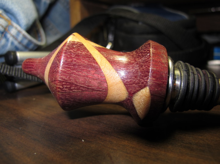

July 29, 201214 yr comment_26176 Charles, This is one of the first stoppers I made. Purple heart and maple. It had a couple of coats of Minwax gloss oil based poly. It has been in use for many years. Tried to get the picture to show it still shines. Lew Kauffman-Wood Turners Forum HostTime traveler. Purveyor of the world's finest custom rolling pins! Report
