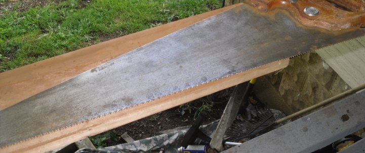

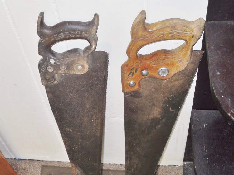

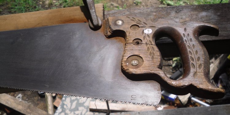

 Just two old handsaws, @ $1 each.    I might be able to fix them up...ning-sdc13024-25855-93.jpg?width=750I even worked on the black handled one for awhile today.    Clamped it in place on the Back Porch Bench, grabbed some sandpaper, and went after the rust...ning-sdc13025-25855-47.jpg?width=750Looking a little better.   Even found an "etch", still trying to decode it, though.     It MIGHT be a Disston.  A look at the handle (tote)ning-sdc13026-25855-60.jpg?width=750That "10" is the tooth count, usually as tpi.   I found ONE missing tooth, clear out by the end.   Not going to joint a whole saw blade for one tooth.   I'll be re-gluing that handle, once I get it off the blade.  Then, I will start looking for some Brass hardware.   Two Saw nuts, and a Brass Medallion.    As for the other saw?    It's next on the "Bench", later today.     I have about an hour so far in this old saw.  Grin.gif

 I just use sandpaper and elbow grease on the metal.    Just keep using finer and finer grits until it is all cleaned up.    The handles get a re-finishing like any other wooden item.     The one will need a glue up when I get it off the blade. New saw nuts when I can find some.

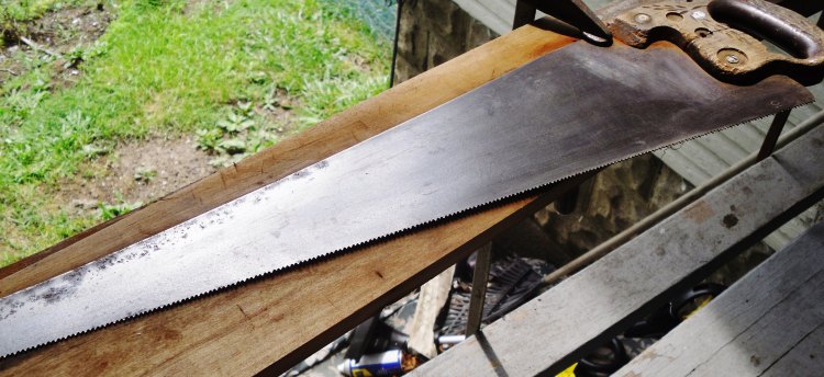

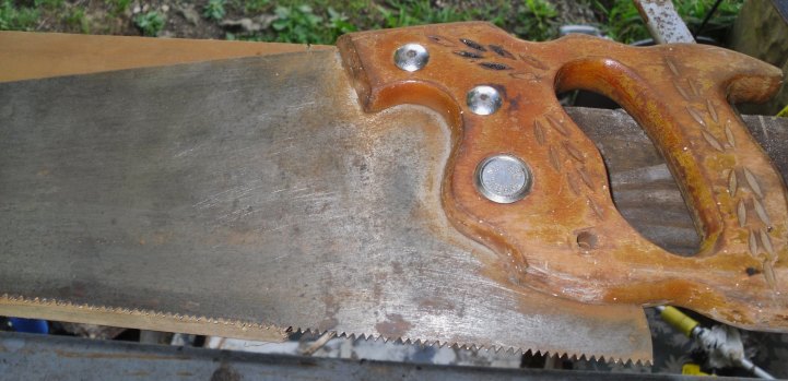

Worked on the other saw for awhile...ning-sdc13029-25858-49.jpg?width=721shined up nicely..ning-sdc13028-25858-85.jpg?width=721still have to work on the handles.    need some more fine sandpaper/emery cloth to get rid of the rest of the junk. And needs one saw nut.   Grin.gif

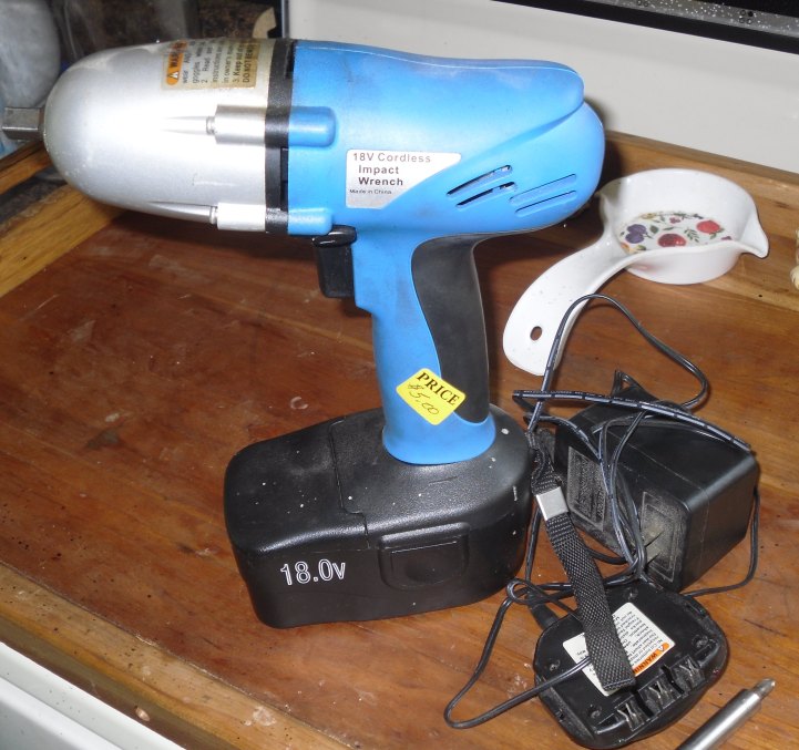

 Also working on a third item that "followed me home", cost a little more than the first two, though..ning-sdc13021-25857-26.jpg?width=721Getting it charged up now, we'll see later IF it works ok.  3/8" drive.
