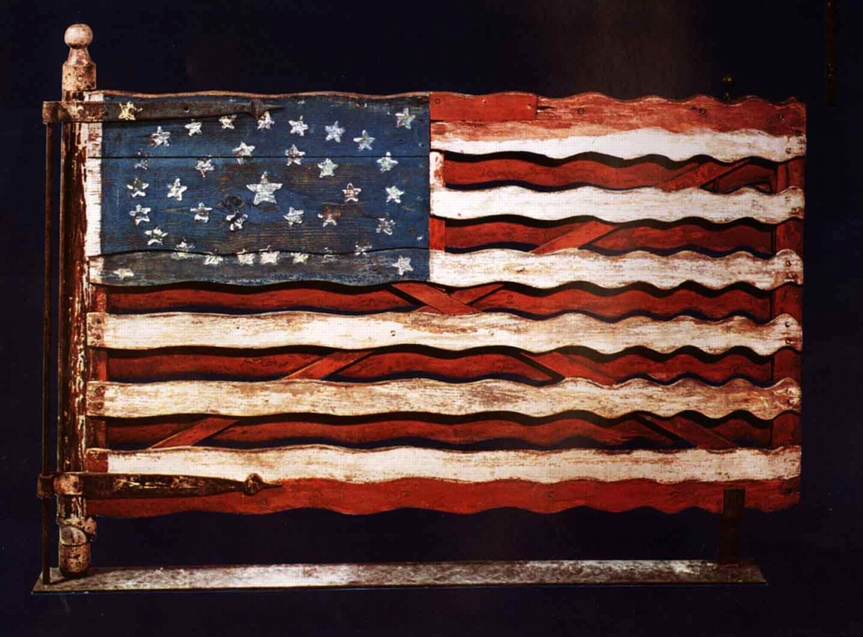

I decided to make a wooden flag so a quick Google search turned up nothing that I liked, until I came across this photo of an antique wooden flag. The description on the photo said it was fence gate to an old house.

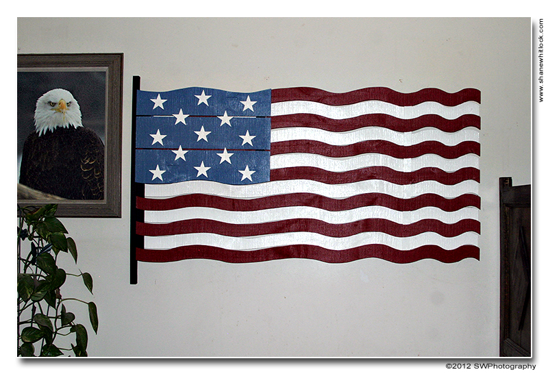

amer_flag_gate.jpgHere's what I came up with. I was originally going to antique it so it looks like the original but don't know if I will now, still debating on it.
I made it from some red oak that I had kicking around from another project.  I wanted a rough sawn look to it so I loosened up the tension on my band saw and opened up the guides a little bit which gave the wood the look I was after.

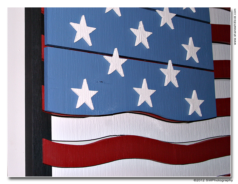

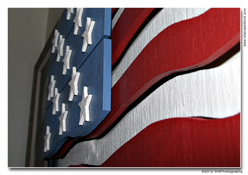

IMG_1288.jpgIt's kind a hard to tell from the pics but it has a 3 dimensional look to it. There is a 1/4 inch gap between the front of the white stripes and the back of the red stripes, and the same with the blue and red.
IMG_1291.jpgIt was a fun quick easy weekend project and the wife loves it hanging on the wall.
IMG_1290.jpgThanks for looking,

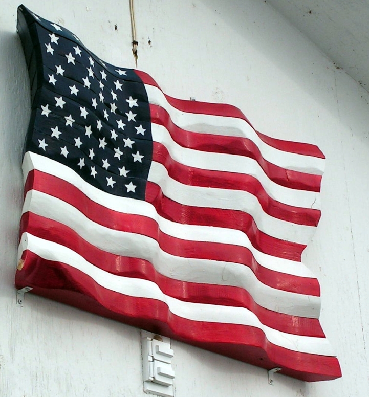

I always wanted a flag pole for my yard, but didn't have a decent place to put one. So I made one also, mounted at the top front of my garage where it could easily be seen and the light above it came on at dusk, off at dawn. I made it of 2bys and used the band saw to simulate a flowing flag.

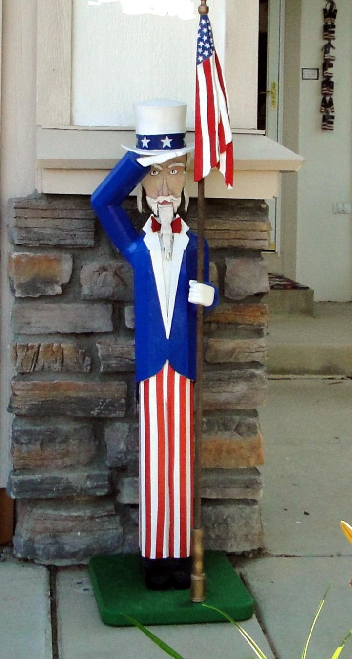

No, sir, it doesn't put yours to shame. Yours is just a different style from earlier time. Mine was made with all intent of representing the flag that I couldn't find a place for. I can guarantee you that if my wife sees yours, she will want one. Unfortunately, I had to leave my flag with my old home when we moved and this guy sets out front. I made him a few years ago and have rebuilt him, he don't weather too well. I made his flag to look as a flag would hang.ning-dsc01254-25839-4.jpg?width=721
