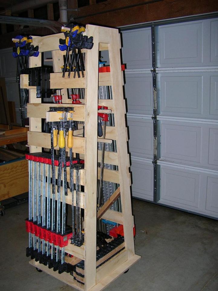

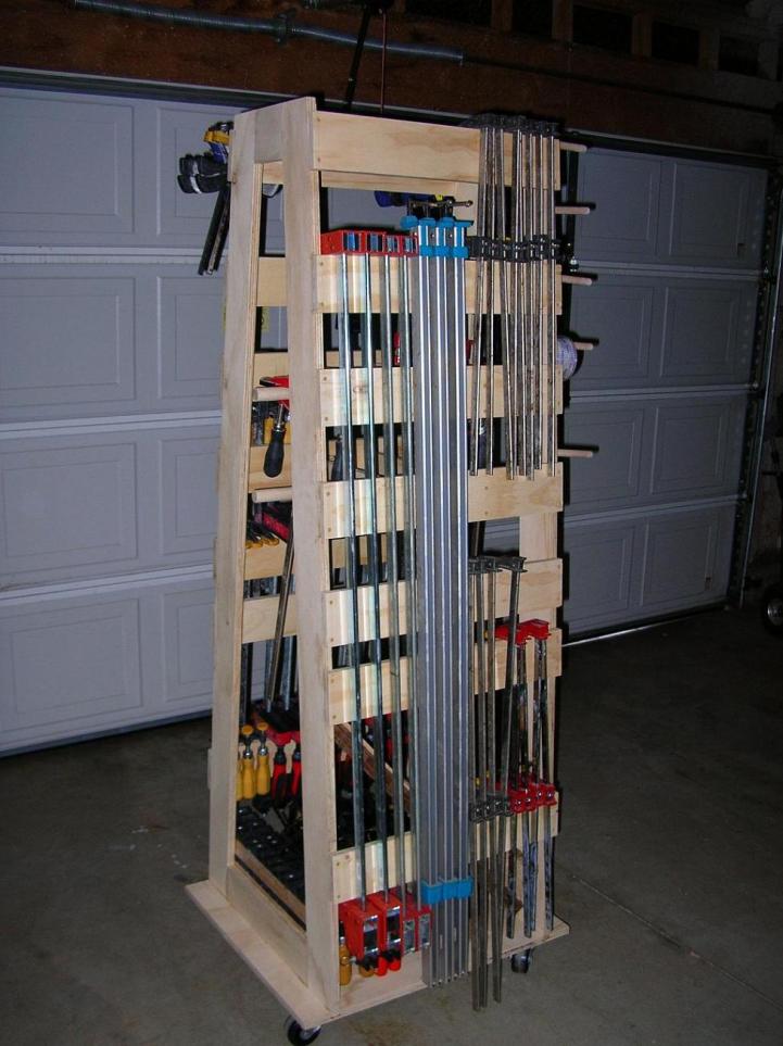

I will give you one more to consider depending on how many clamps you have.
This is the rolling clamp rack by Norm Abram on the NYWS that I made a few years back. For me in my shop it works great. I got the plans for it if you are interested.
ning-front2small-25829-96.jpg?width=721
ning-rearsmall-25829-1.jpg?width=721
