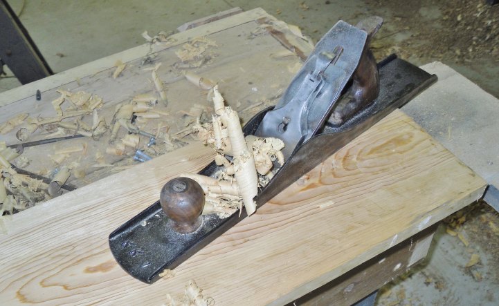

 To get a shaving like this..ning-sdc12964-25710-30.jpg?width=721I had the chipbreaker about 2mm back from the edge of that sharp iron.    Mouth wasn't adjustable, so I slid it forward the frog itself forward a bit.     I mated the chipbreaker to the iron, did  not have any gaps between the iron and the chipbreaker.   They need to be a nice close fit.  While i do "polish" the irons...ning-sdc12832-25710-28.jpg?width=721 i don't go for a mirror type of look.    Breaker as well, just well fited to the iron, and smooth on top.   As for them Block planes, that don't have a chipbreaker to worry about?    Just make sure the "bed" where the iron sits is claen and smooth, no rust or dirt,    Less chatter that way.  Sharpen the iron up ,and install.     just use only enough edge to make a shaving...ning-sdc13166-25710-57.jpg?width=721 i use just sandpaper, and a few old stones.     To each their own way...Grin.gif
A #6 is a bit large, but will work..ning-sdc12976-25709-87.jpg?width=721I use mine mainly as a "jointer" for edges.    I use the #7 as well, but for the faces of panels..ning-sdc13002-25709-5.jpg?width=721 but, maybe the best "all-around" handplane would be the #5 sized jacks.    They can surface a board, using a "cambered" iron ( looks like a smile on the edge) by going at a diagonal to the grain. they can smooth a surface as well, with an edge that is straight and square.     And they can Joint an edge like the bigger jointers, but at 14' long, the boards would need to be a little shorter.     I seem to have a couple jacks in the shop.   Just rebuilt one, in fact...ning-sdc13001-25709-51.jpg?width=721 So, it depends on how big a plane you want to muscle around.   Jacks run from 13.5" up to 15" long, counting the #5-1/2s.    A #6 Fore plane runs right around 18' long.   They are also wider than the normal Jack planes, a jack is usually 2" wide in the cutter, a #6 is about 2-3/8" wide in the cutter.    Those BIG #8s are @ 2-5/8" wide in the cutter area.    There is a "Junior Jack' out there ( I don't have one, YET) that runs about 12" long, and uses a #3 size iron @ 1-3/4" wide.   Little critter, more ike a long smoother.    Closest I have to that one is a Craftsman #3, @ 10" long.    It is longer than all of my #4s.   Just depends on how much weight you want to wrestle around. Grin.gif

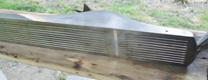

 A look at the Biggems in my shop..ning-sdc12855-25708-27.jpg?width=721A #6c.   18" long, with a 2-3/8" iron.   The "c" stands for corrugated, or grooved sole ( just hype about sliding better) ning-sdc12828-25708-96.jpg?width=721Next, also with that groovy soleGrin.gif is the BIg Boy, the Bailey #8c Jointer, all 10 pounds worth, Grin.gifning-sdc12977-25708-80.jpg?width=721It was even longer (24") than the test track.    There is a "Super jack plane", a #5-1/2.    The older ones used a 2-1/4" wide cutter, mine uses the 2'3/8' iron like the #6, and #7s do.     Length is just over 15".   ning-sdc12898-25708-64.jpg?width=721This one is a Union #5A, same size as a Stanley #5-1/2.    Tuned up, and ready to work.   Next time out, i show off the litle guys.     First things first, get out there and make some shavings...Grin.gif
