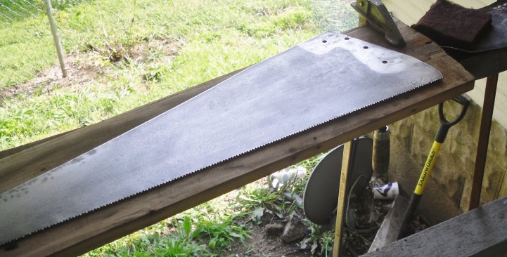

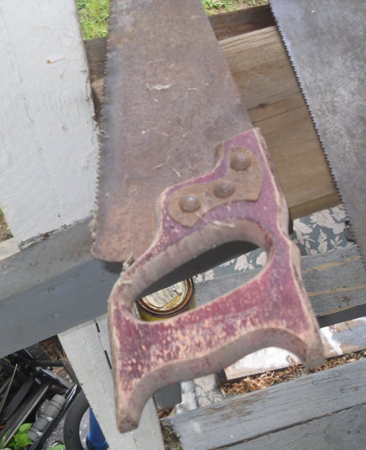

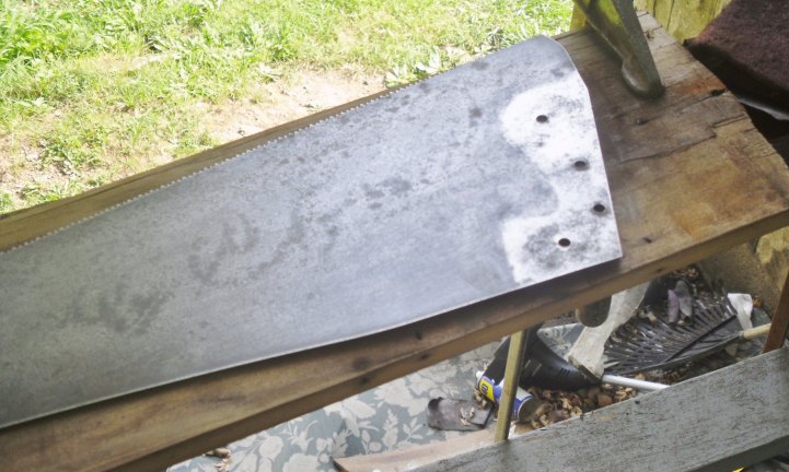

August 9, 201214 yr comment_25638 Got a little done on the No. 16 Disston saw today. Got the handle (tote) off,and cleaned off all the rust on the blade. Report

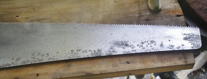

August 9, 201214 yr Author comment_25650 Try this again. One reply didn't come through, just now..Not sure about those squiggles, either.  THOSE I can correct, though.. Pitting out near the toe, and a missing tooth.   I will not re-joint because of one missing tooth, though.   Been a long day ( 28 hours) so it might be time to do like this little guy...I think he has the right idea... 'and may the road raise up to meet ye' Report

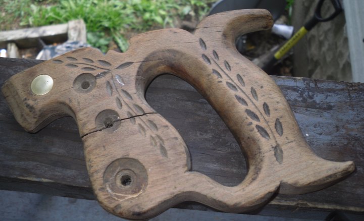

August 10, 201214 yr Author comment_25649  got the No.16's tote off.  hand sanded all of the finish off.  Got rid of the silver paint spots.  Getting ready to glue the cracked area back up. Handle hardware will get here next week.  I did shine up the ONE brass saw bolt this saw still had. IF it dries out on the back porch, I'll set up the saw vise, and file them teeth nice and sharp.    I do still have a sawset (IF needed) and a saw jointer ( don't need for one tooth broken) and about a dozen decent saw files.  I have the other saw cleaned up.  The handle will get stripped to bare wood, and a simple re-finish. Got to check down at ACE Hardware to see IF they can order a sawbolt.  These later-day ones, from about the Disston/HK Porter era were Nickel plated. All I need is just one more, to complete the saw. 'and may the road raise up to meet ye' Report

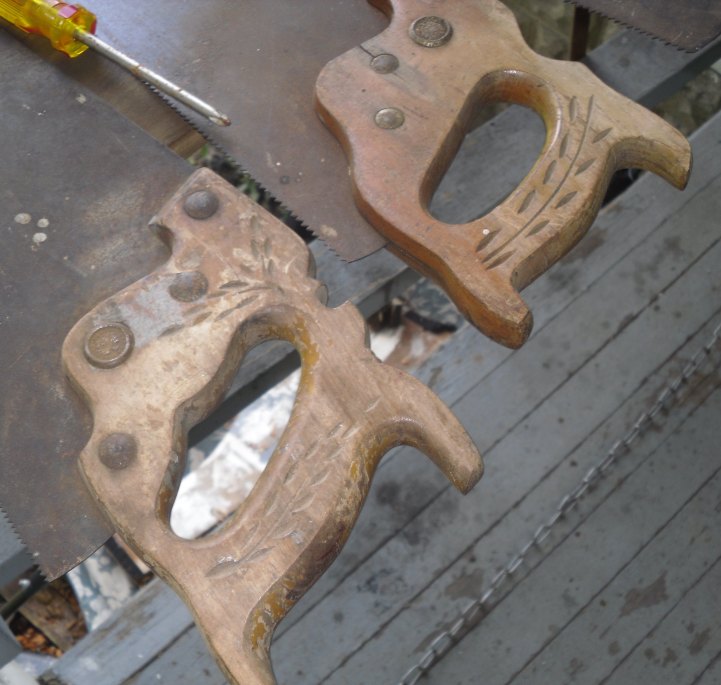

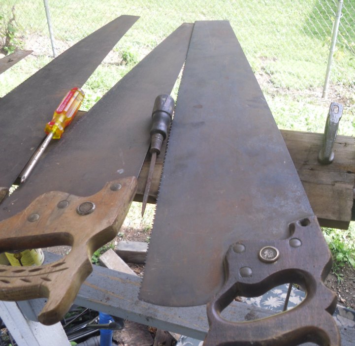

August 11, 201214 yr Author comment_25647  just what i needed, four more saws just walked in the door.     One is a BIG saw, two just normal saws, and a "half-pint" saw.  They even brought along a couple screwdrivers, just in case i might need one.   Cost? less than a fiver.  A look at the new guys..the big guy.  one of the normal saws beside it. 28 inches long, by over 7 inches tall.  the two screwdrivers sitting there,as well.  the two normal saws...just your run-o-the-mill warranted superior saws.   ugly handle on the one, but, we can fix that.   the half-pint....think it might need a touch up of that red paint?  Now, I do have to find out all I can about that huge, monster saw.  no etch, as of yet, most WS saws didn't have them.  Was it cut down?   WHO made this old saw?   Handle looks like a D-7, or a D-8 type. Brass hardware, unlike the other two "Normal saws".  They have the newer Nickel plated stuff.  Half-pint might supply the missing saw bolt.   Looks like I'm back in the saw biz.... 'and may the road raise up to meet ye' Report

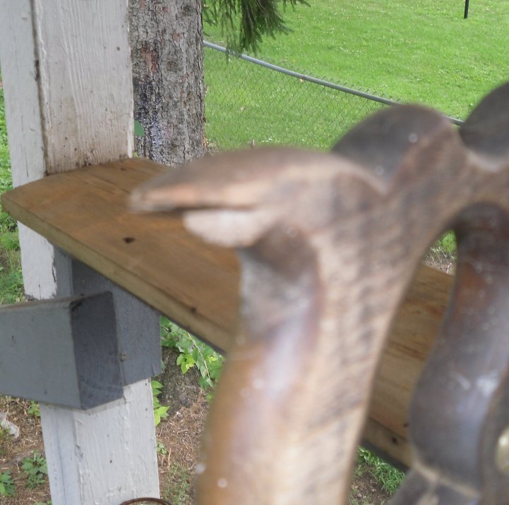

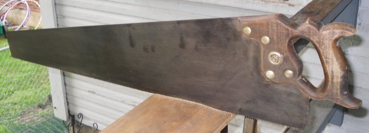

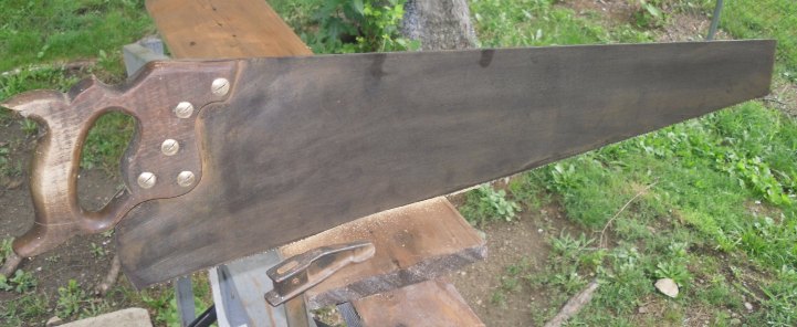

August 11, 201214 yr Author comment_25646  Ok, here is that tote I've cleaned up, from the No. 16 saw...yep, medallionis in the bottom hole on a No.16 Disston saw.   They stopped making them in the 1920s.  And now a few pictures of another saw, just a small,little saw....Medallion side. Over 28" long, this saw is over 7" wide at the heel, and almost 3" wide at the toe.   I found out i could chuck those saw bolts into my cordless drill, and give them a spin into a purple scratchy pad.   Shines them right up.   A look at the other side...It took about five full strokes to make that saw kerf deep enough for the saw to sit in. The top horn has a piece missing...Doesn't seem to hurt anything, though. I found a replacement saw bolt.  Had to narrow it down a bit the match the others. Just a dollar saw.    Might be going on the ebay express next week.... 'and may the road raise up to meet ye' Report
August 11, 201214 yr Author comment_25645  None of these will be a "Showpiece" of a saw.    Most will get a clean up, and then on to the ebay.     That way I can buy more planes like I need them...   Will do only what it takes to get them ready. That little red handled thing?  Haven't decided, yet.  'and may the road raise up to meet ye' Report
