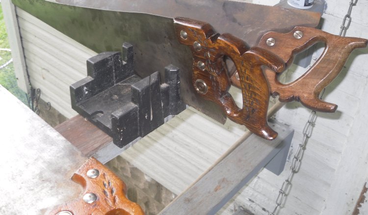

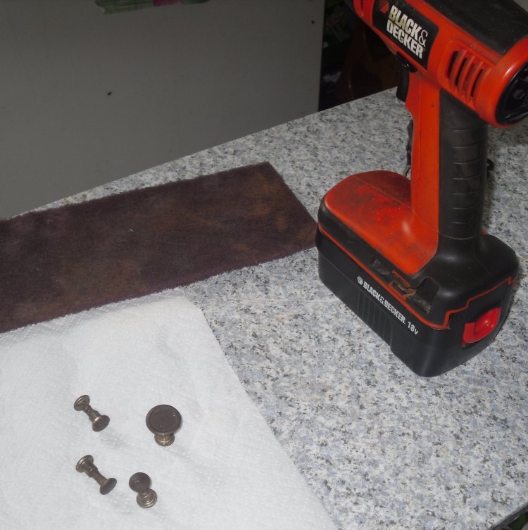

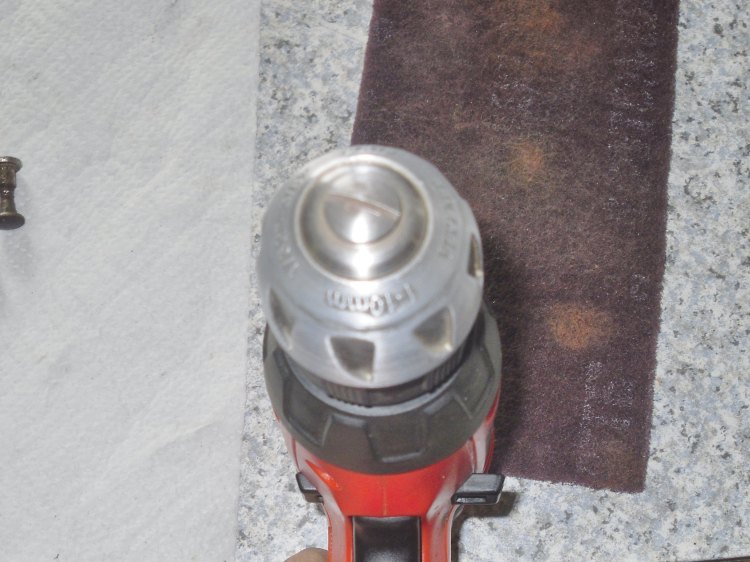

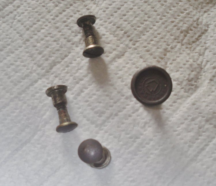

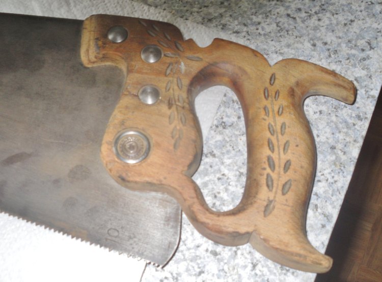

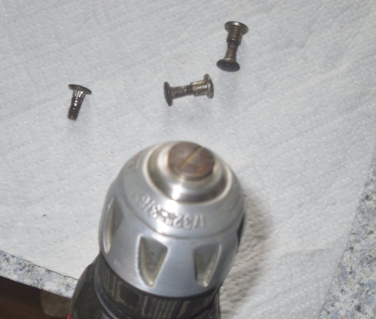

 well, some Brass (?) hardware showed up this morning, attached to a saw handle.   Decided to clean them bolts up.   (Brass rusts???) I have a little trick to polish these up, quickly.    First a look at the partsning-sdc13195-25468-19.jpg?width=750and the toolsning-sdc13196-25468-90.jpg?width=750I chuck a part into the drill..ning-sdc13197-25468-6.jpg?width=750use one hand to run the drill, the other to hold the purple scratchy pad against the part..ning-sdc13198-25468-57.jpg?width=750should look like this when done ( THIS ain't brass!)  medallions take a little longer, as I have to hold the pad into the recesses.  When all are done, just mount them into the saw of your chioce..ning-sdc13199-25468-26.jpg?width=750in this case, a Disston No. 16/D-16 from around the 1920s era.   10 pointer, skew back.   Crack was repaired as well.    Needed a re-finish, so....ning-sdc13203-25468-76.jpg?width=750here'tis!  sitting in the "drying rack" on my "Bench".   The other two are users, getting ready to go onto Ebay.  Grin.gif
