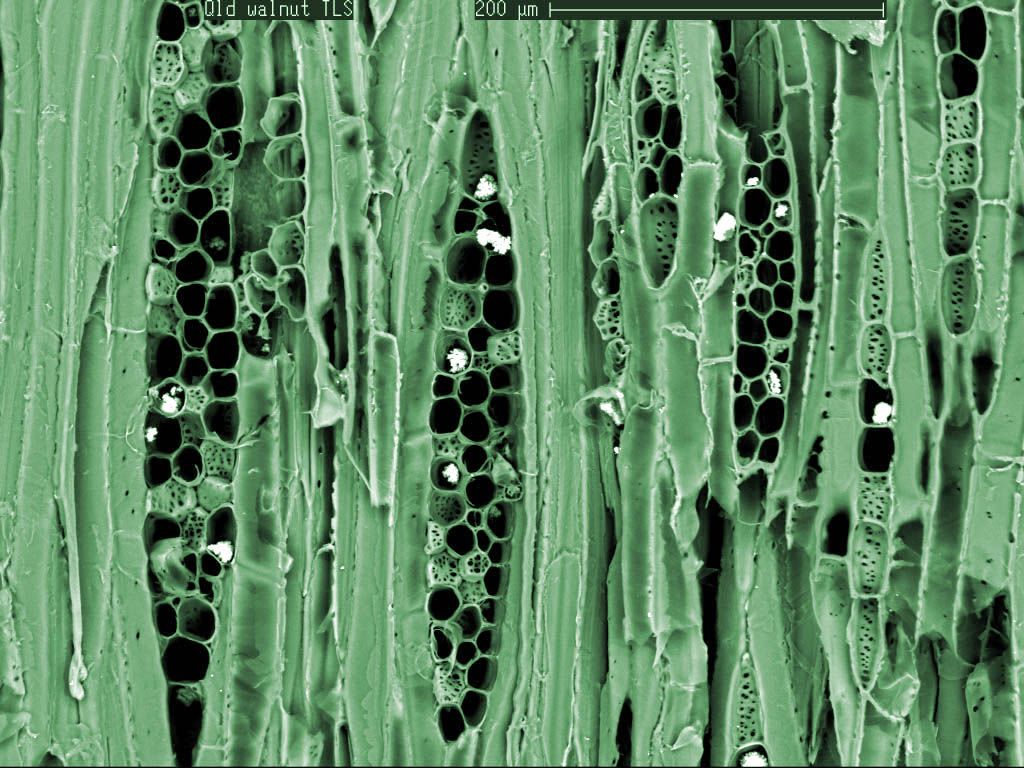

August 19, 201214 yr Author comment_25371 A dust mask won't filter down to the micron size. Here is an electron microscope image of the silica in walnut: Report
