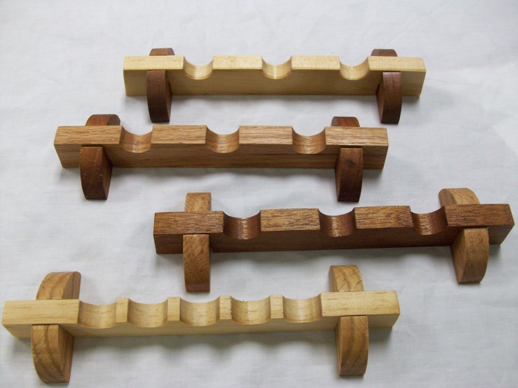

August 21, 201214 yr comment_25190 I ran across this pattern of Steve Goods the other day and decided to make some. Quick and easy. I used some pine, cherry, red oak , and mahogany. Great project to use up some of those 1/2" scraps. GregScroll Saw forum hosthttp://www.thesawdustfactoryga.com/ Report
August 21, 201214 yr comment_25199 Those are cool. I missed that one on Steve's site. Thanks for posting Greg. I'll have to file those away. Report
August 21, 201214 yr Author comment_25198 I think the pattern was from sometime last year. Maybe Steve can tell us himself, he just joined up. These are quick easy gifts. You could actually cut them on a bandsaw too with a thin enough blade. I used mineral oil to finish them. GregScroll Saw forum hosthttp://www.thesawdustfactoryga.com/ Report
August 21, 201214 yr comment_25197 Greg,I saw those on Steve's site, too. Â Yours look great! Â Love your wood choices.SQHappiness is wood chips flying! Report
August 21, 201214 yr comment_25196 Those are awesome Greg. And what I like about them is you don't have to be a scroller to make them! I am not sure how you did it, but I can see taking a piece of wood, boring holes in it, then cutting it in half to make two spoon holders and then fabricating the stands. A versatile project for all skill levels. Great project. Thanks Greg, and thanks Steve.John MorrisThe Patriot WoodworkerProud Supporter of Wounded Warrior Project and Homes For Our Troops Report
August 21, 201214 yr comment_25195 That's what I plan on doing John. I think the stands would be easier to cut on the scroll saw and give them some decorative fretwork. A good inspiration for a simple project there Ron! Report
August 21, 201214 yr Author comment_25194 Thanx dear, good to see you around.SQ said:Greg,I saw those on Steve's site, too. Â Yours look great! Â Love your wood choices.SQHappiness is wood chips flying! Report
August 21, 201214 yr Author comment_25193 It could be done that way John, but Steve's pattern has the notches in it already. If you have an 1/8" blade on your band saw you could use it, and I'm sure it would work fine for cutting the notches in the legs too. Here's a link to the pattern http://stevedgo.ipower.com/cat/?page_id=127John Morris said:Those are awesome Greg. And what I like about them is you don't have to be a scroller to make them! I am not sure how you did it, but I can see taking a piece of wood, boring holes in it, then cutting it in half to make two spoon holders and then fabricating the stands. A versatile project for all skill levels. Great project. Thanks Greg, and thanks Steve.John MorrisThe Patriot WoodworkerProud Supporter of Wounded Warrior Project and Homes For Our Troops Report
August 22, 201214 yr comment_25192 John,I like your idea of drilling out the notches and then cutting them and making two holders.  I think I would even take it a step further and use thicker wood which would stand alone without side supports, thus eliminating the side supports all together resulting in a very simple and sleek product.  Adding fret work as Mike mentioned and or rounding the ends of the wood could create an entirely different look. SQJohn Morris saidThose are awesome Greg. And what I like about them is you don't have to be a scroller to make them! I am not sure how you did it, but I can see taking a piece of wood, boring holes in it, then cutting it in half to make two spoon holders and then fabricating the stands. A versatile project for all skill levels. Great project. Thanks Greg, and thanks Steve.John MorrisThe Patriot WoodworkerProud Supporter of Wounded Warrior Project and Homes For Our Troops Report

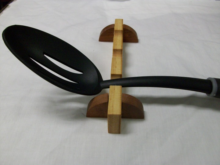

August 23, 201214 yr Author comment_25191 Here ya go Joe, here's one with a spoon taking a rest GregScroll Saw forum hosthttp://www.thesawdustfactoryga.com/ Report
