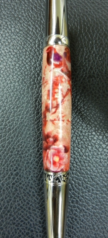

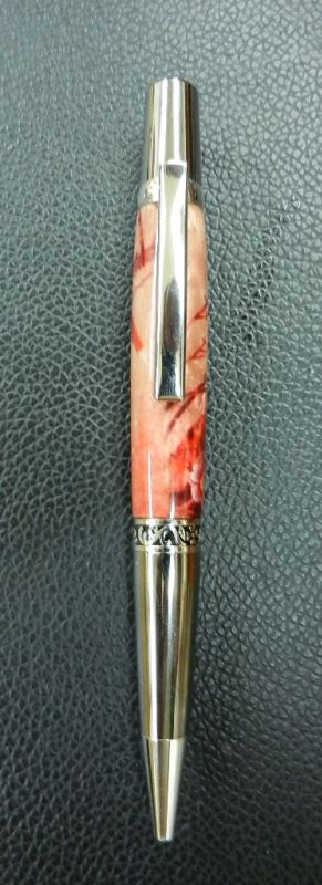

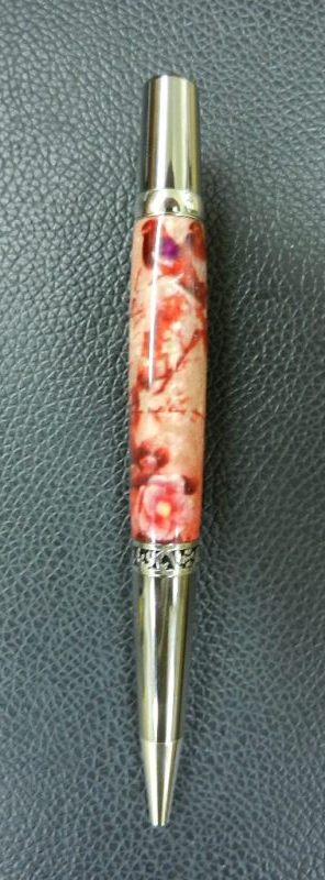

August 22, 201214 yr comment_25146 This is a pen I turned for our Daughter who is visiting this week. The blank is a cast acrylic decal blank from Woodcraft. It's a floral pattern with bird at the top of the blank. Turned with my Wood Pen Pro carbide tool and micro meshed to 12000 then buffed on my buffing wheels. The pen kit is a Wall Street II Elegant ball point Black Titanium &Â Platinum. I like the way it turned out. At first I wasn't sure if the floral colors would go with the black titanium but it works. Thanks for viewing. Report

August 22, 201214 yr comment_25149 It is beautiful. I like how the pattern slowly unfolds and voila, you see the bird ... Nice! Report
August 23, 201214 yr comment_25148 Mike, thats an amazing looking pen, I bet she won't let anyone borrow it GregScroll Saw forum hosthttp://www.thesawdustfactoryga.com/ Report
