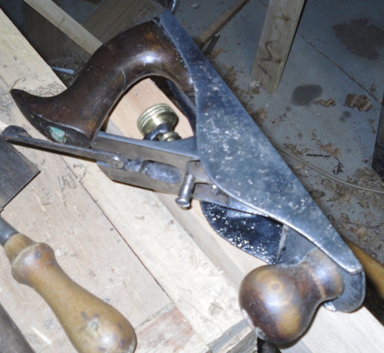

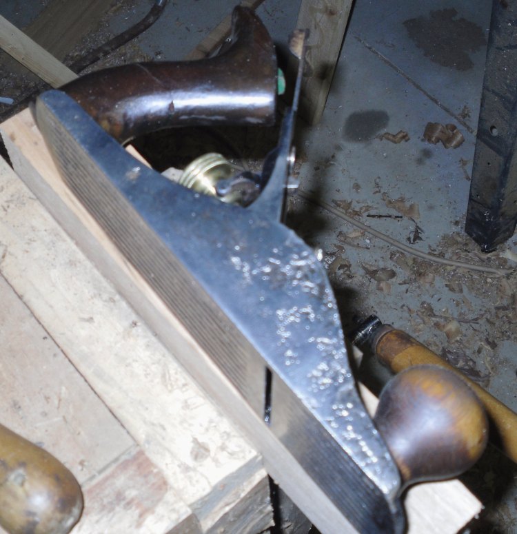

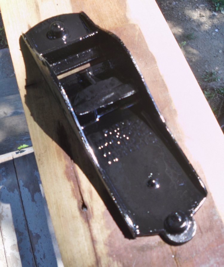

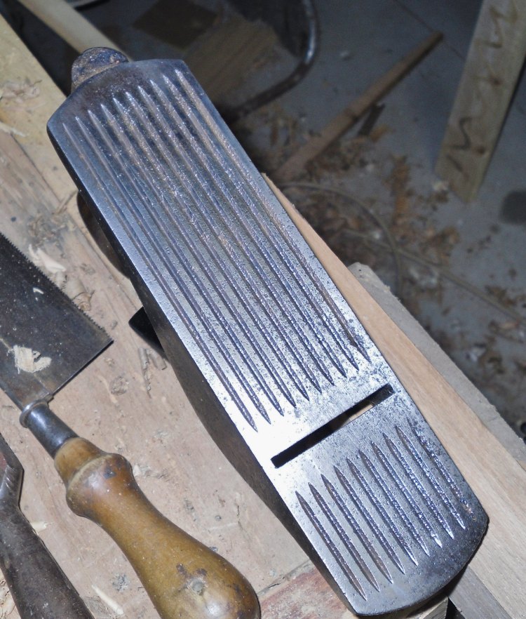

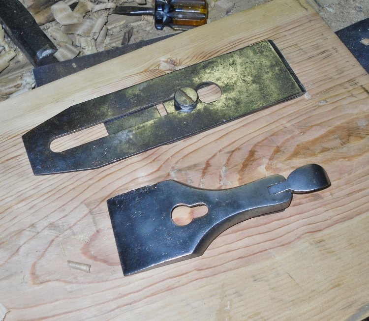

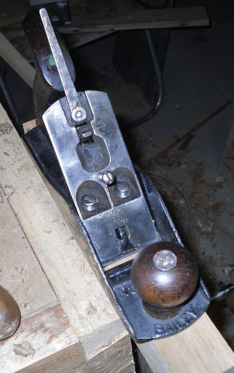

 Rust bucket, Forlorn Hope, Rusty & Crusty?    Not any more!  Day number two of the Challenge is done.  Got a coat of paint applied...ning-sdc13285-24936-75.jpg?width=750Took the parts out to the Pole Barn Woodshop, for some serious work.      Bolt extractor, brand new at that, snapped in the first hole.   Had to drill around it, and re-tap as 1/4" x 20 bolt holes.    When the "new" bolts do show up, I'll re-thread the brass nuts as the same.    No problem there.     Finished cleaned any and all rusty-ness out of this little plane.     The lever cap and the iron/ chipbreaker got a work over...ning-sdc13295-24936-64.jpg?width=750Dang camera flash on the iron..    The iron was sharpened as best as i can, and polished up.    It has more scars than a teenager with acne.   I also worked over the base, and the frog.    Screws and all were shined up.  ning-sdc13290-24936-10.jpg?width=750Bolt in the knob is a temp.   The sole was cleaned up, and lapped...ning-sdc13292-24936-10.jpg?width=750as were the sides...ning-sdc13293-24936-35.jpg?width=750this is the "good side".    the other side has a lot more pitting going on...ning-sdc13291-24936-43.jpg?width=750I guess I could take it for a short "Test Drive".....ning-sdc13289-24936-43.jpg?width=750on the Beech!     Rust Bucket?     No, now meet Mr. Stanley Bailey Number four, type 11.      Almost done.....

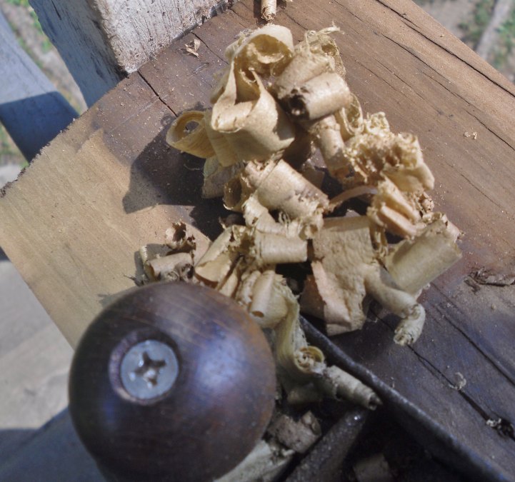

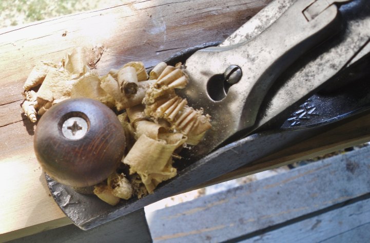

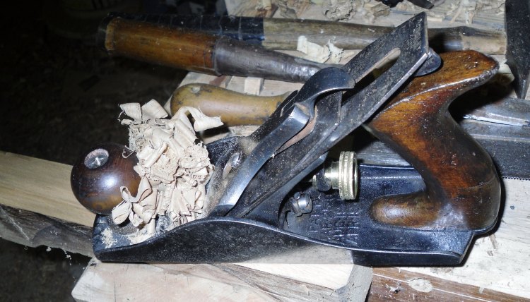

ning-sdc13296-24937-69.jpg?width=721A trip down poplar street Test track with the new plane.    Brass bolts  are being worked on now.  ning-sdc13297-24937-66.jpg?width=721not too bad, wait til I sharpen that blade up....
