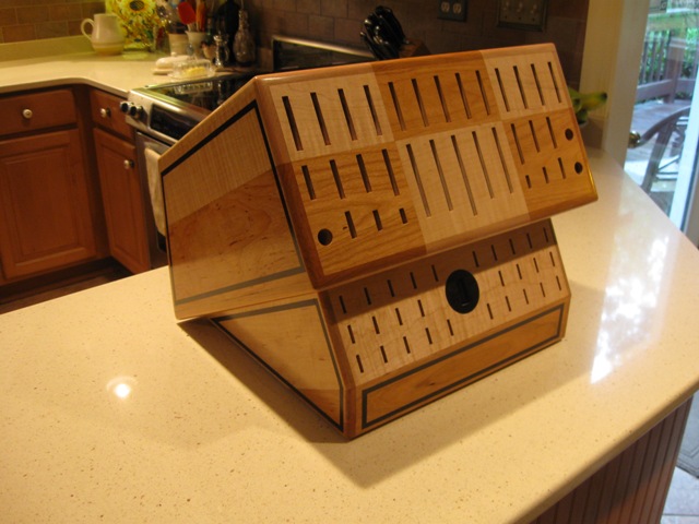

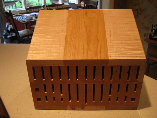

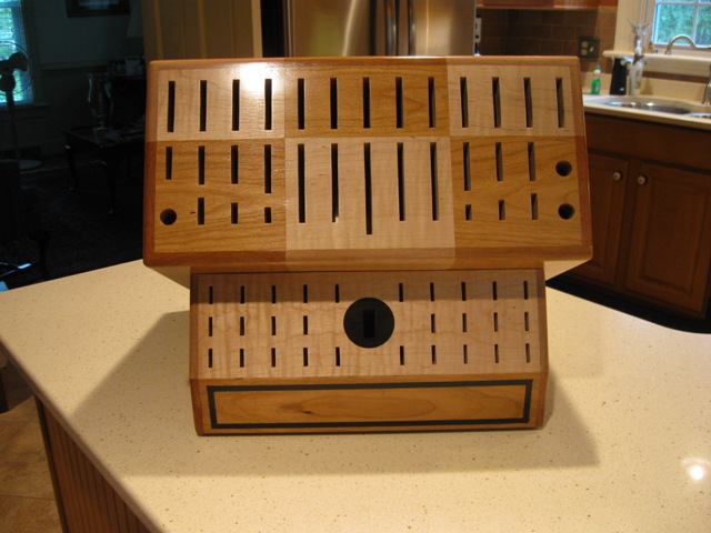

August 27, 201214 yr comment_24846 Hi Everyone Here are a couple of photos of my newest commission. This block is 17â€wide x 14.5†tall and 14†deep. Made from cherry and tiger maple with ebony accents. Weighs in at 45 lbs. Holds 59 knives, 3 steels and a pair of shears.And yes there was a lot of scrolling involved in cutting out the 60 slots for the blades. Used a #5 skip tooth blade. Mike'why buy it if you can build it'www.midlothianwoodworks.com Report

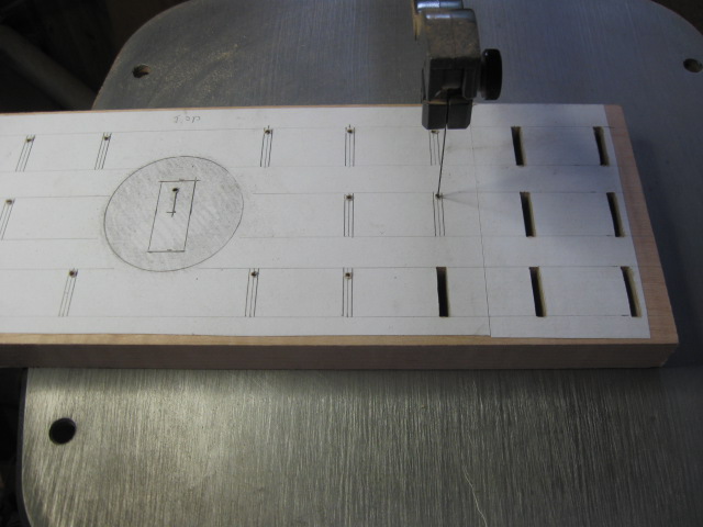

August 27, 201214 yr Author comment_24854 Hi Joe The slots are actually scrolled in 3/4" stock face pieces using a #5 skip tooth blade.as the photo below shows The face pieces are then assembled and the routed blade slot pieces are added to fill in behind the face pieces until everything is filled in then the top is glued in place as shown in the next photo. Lots of very precise cutting and fitting as you can see. The 3 round holes are drilled for the steels and the square slots match up with the front holes Joe Lyddon said: Mike, That is SO COOL! I cannot visualize how you "scrolled" the slots! Do you have a (at least) 14" scroll saw blade? Â LOL Could you please elaborate on that? Those round points... Â are they holes... or just accented circles? The way you made sub-blocks and glued them all together looks SO COOL! ... and the inlaid banding is an excellent touch of Class! The most beautiful Knife Block I have ever seen! It would be appreciated if you could go into some of the details on how you did it... Really... a COOL piece! Thank you very much! Report
