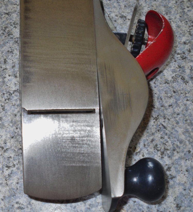

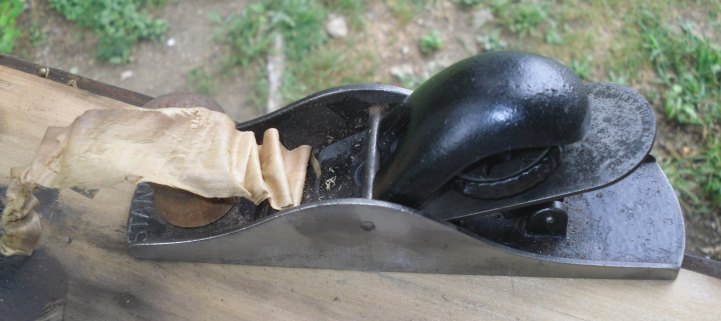

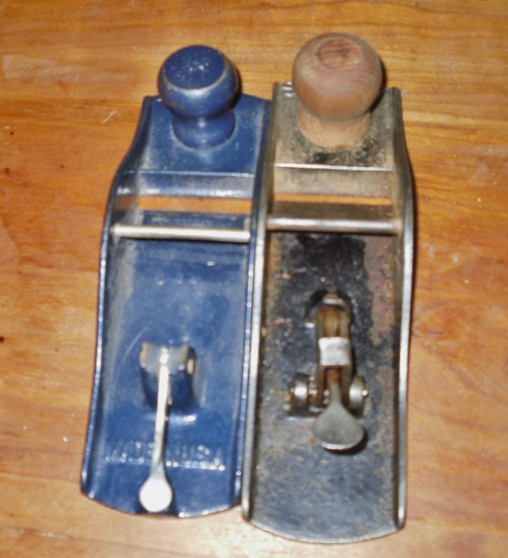

August 29, 201214 yr comment_24751  small box came in the mail today.   Very small box.  It had two block planes inside.all black is a Stanley #110, the Red & Blue one is a Stanley Handyman #120.    Things look nice, don't they?   Hmm, went to lap the sole of the 110,   didn't look right...Ah, that's the problem.   A cracked mouth.   shame, because the iron is a Sweetheart iron, making this about 1920s era?   The Red& Blue one?Looks good!  Is that cracked mouth a big deal??? we'll see.   I did have the sides cleaned up, the irons cleaned up. Was going to sharpen them, but the honing guide is out at the Pole Barn Woodshop. Counting a Dunlap from a few weeks ago, these tow new ones, and the rest of the "Herd"head count is now at EIGHT!  Time to thin this bunch a bit?    Three #120s?     A Millers Falls 700 , a stanley 9-1/2, a Sargent #107. a Stanley #110. and a Dunlap 220 sized plane.   About like sayingI have too many #5 Jack planes in the shop.    I do have four #5s, and a Union #5A.   Just enough...;-)) Sign on pick up truck's back window..:' Save a Horse, ride a Cowboy' Report

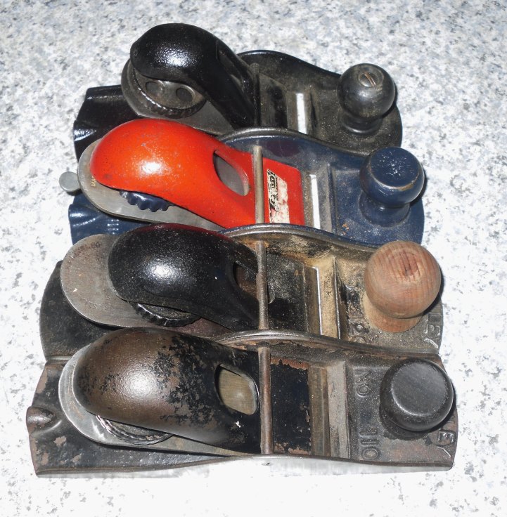

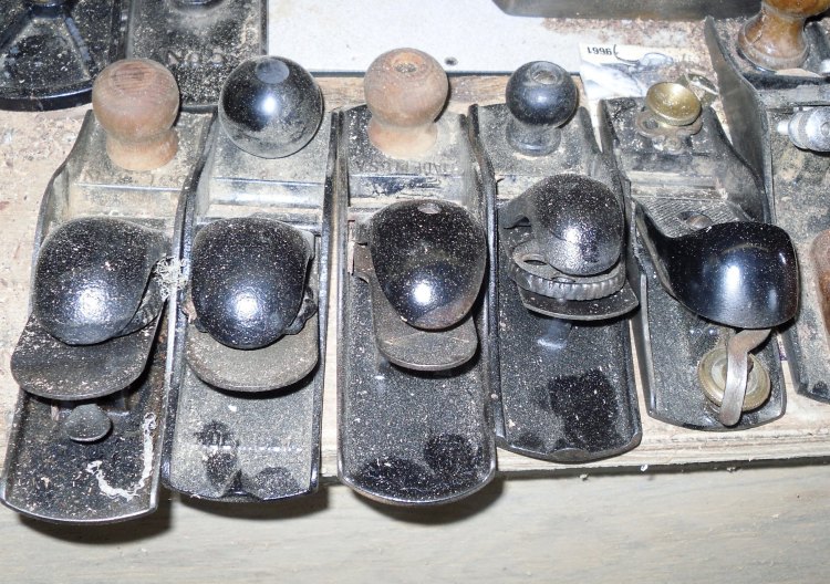

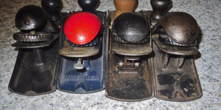

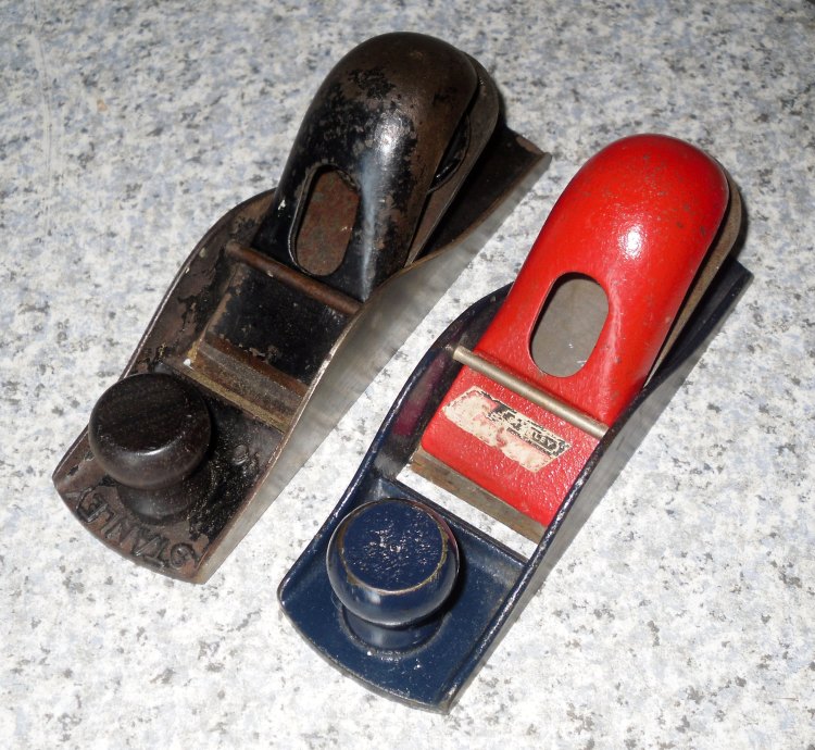

August 30, 201214 yr Author comment_24755  One of these is a Stanley #110, the rest?????another view??and from the side..All of them are by Stanley.   just gets a little confusing about which type is which number.... Sign on pick up truck's back window..:' Save a Horse, ride a Cowboy' Report

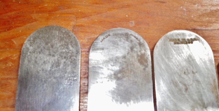

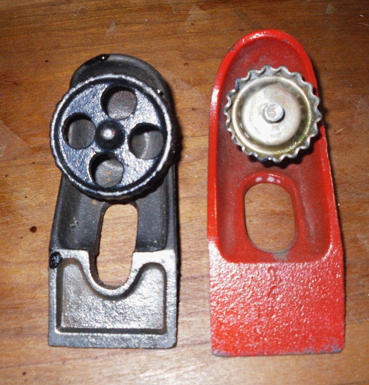

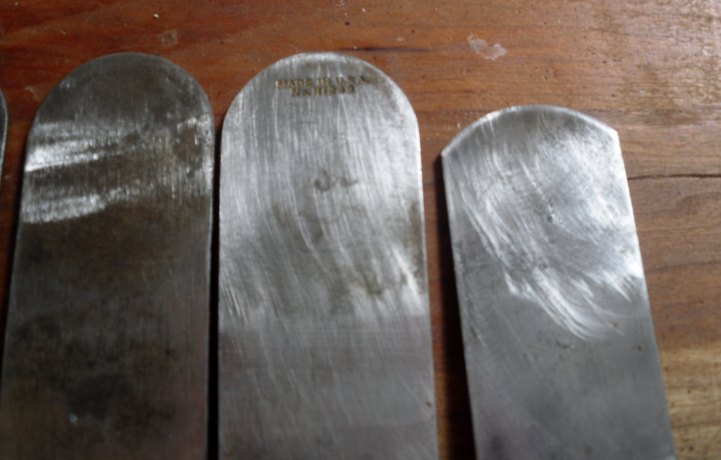

September 1, 201214 yr Author comment_24754  A look at some of the blades in this group..Left to right:  Pre-Sweetheart iron from a Stanley #120,  A Sweetheart iron from the Stanley #110, and a post- sweetheart Handyman iron for the Red& Blue H1249.   Which leaves a short, un-marked thing that might just be an iron...it came out of a short, little block plane that MIGHT be an earlier #120?  Maybe, maybe not.Like that wheel under the cap? Seems most of the ones in this group have that wheel...with the H1249 being the "odd-ball' of the group.  Even the bases are just a bit different.  #120s used a lever to adjust the depth of cut, at least on later ones..The black base is a 120, according to the stamp on the front porch.  Handyman is a little different.   Next up?   Sharpen all these irons up, and give that #110 a new paint job.   Not going to fret about the cracked mouth, but then, I could always get another base....;-)) Sign on pick up truck's back window..:' Save a Horse, ride a Cowboy' Report

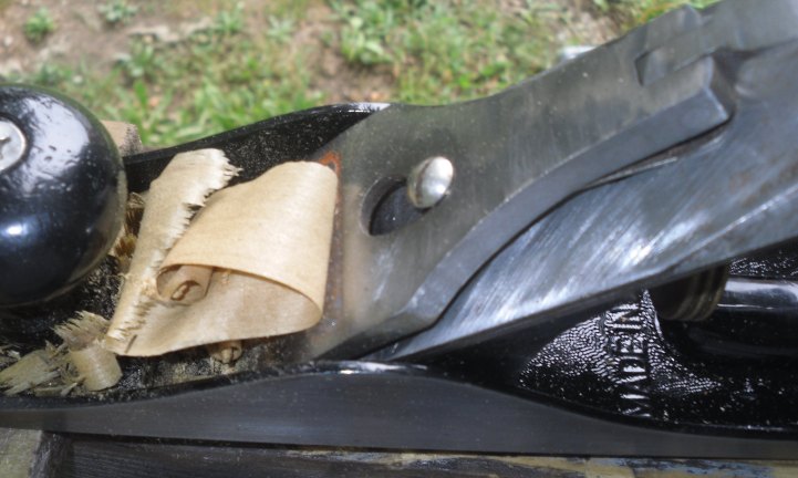

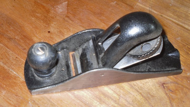

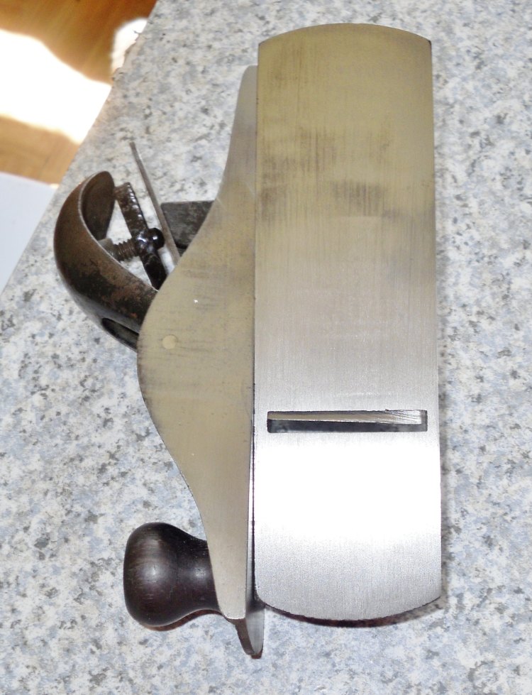

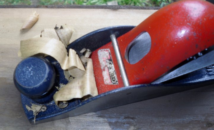

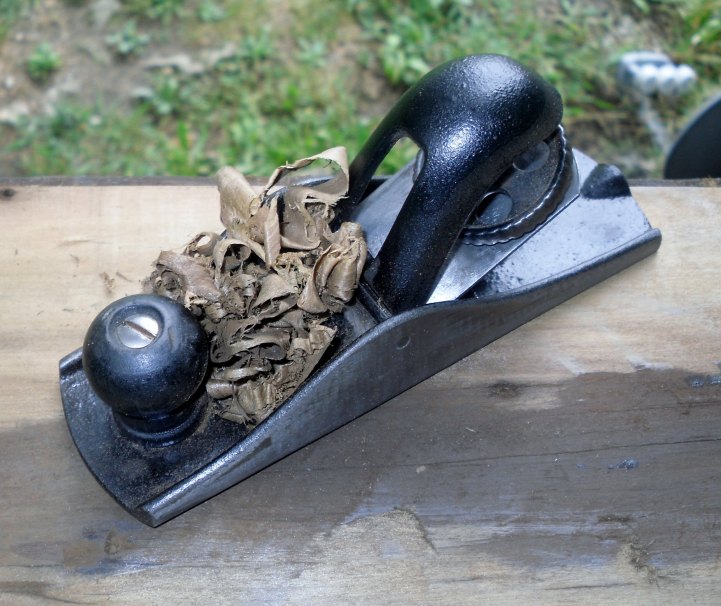

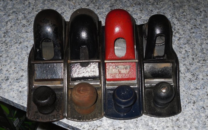

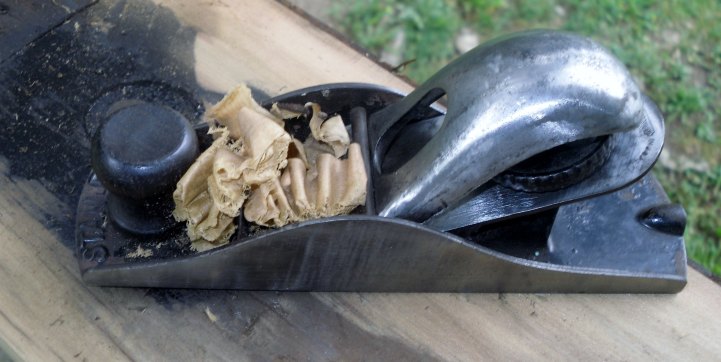

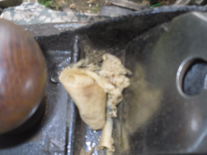

September 2, 201214 yr Author comment_24753  Went to work on the irons today, as well as a few bodies.    Got the cap iron for that #110 shined up, and the Sweetheart iron was sharpened upCracked mouth doesn't seem to affect it.  Debating on a new base, or just call it "Good E-Nuff".    Next on the "block"...I am not sure who made this little guy, might be a stanley, or a Union, or even a Sargent.   Does nice work, though...This "big" plane is a Stanley #120 ( stamped right on the front deck) with a pre-sweetheart iron, no less.  Sharpened up nicely.  And the fourth of the group?Yep, it IS a Stanley, a Handyman #1249 in fact.   Got the number stamped right on the iron.  I already have all the Handyman Bench planes, so this is a start on the block planes.   iron sharpens up real nice.... While the Test Track was up on the bench,  "kit" of a plane was sent along the track, just to see how a pile of old parts would work out..Not too bad... this is one of two "Project Planes".   This one was made from a pile of old parts, the other one is a $5 Challenge Plane...Would have been more shavings, but the wind was kicking up a bit.   Imagine "Gossemer Shavings"  just floating across the back yard.   Been a fun morning... Sign on pick up truck's back window..:' Save a Horse, ride a Cowboy' Report
