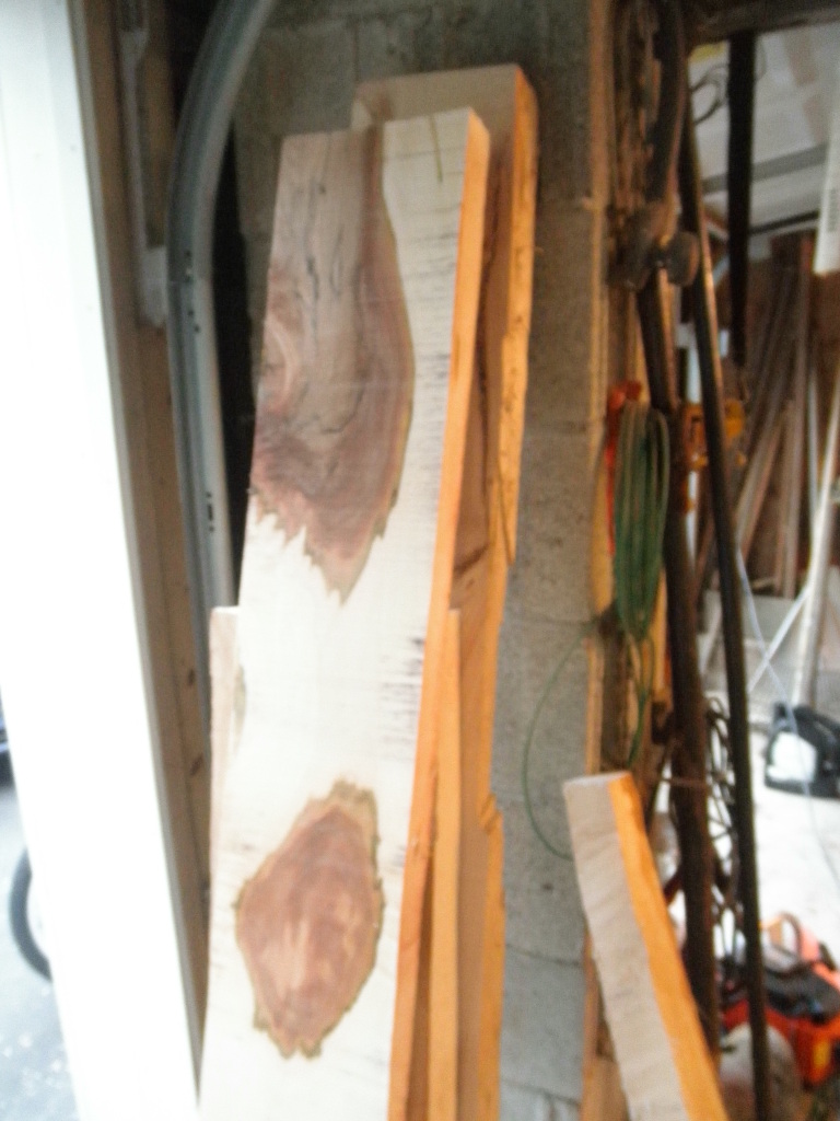

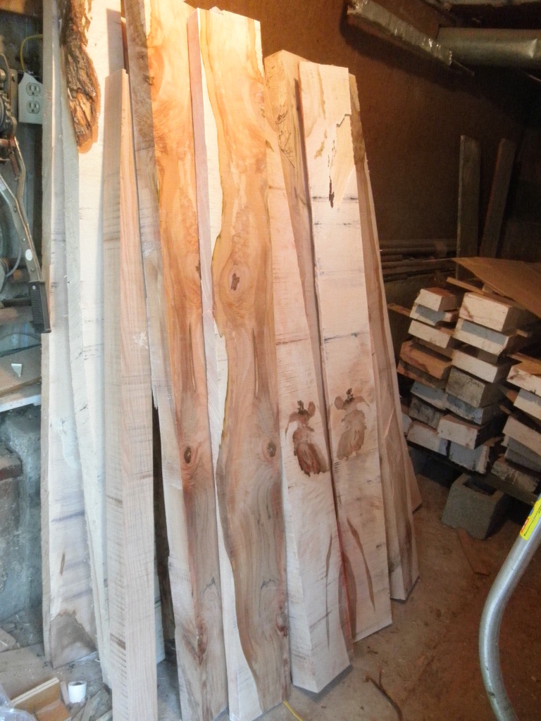

P4140250.jpgP4140250.jpgP4140251.jpgI am having  the dickens of a time drying it out.  I got it stacked indoors after resawing it smaller-ish. I'll have to take the pile apart and re saw it again in a year I suspect to accelerate the drying.

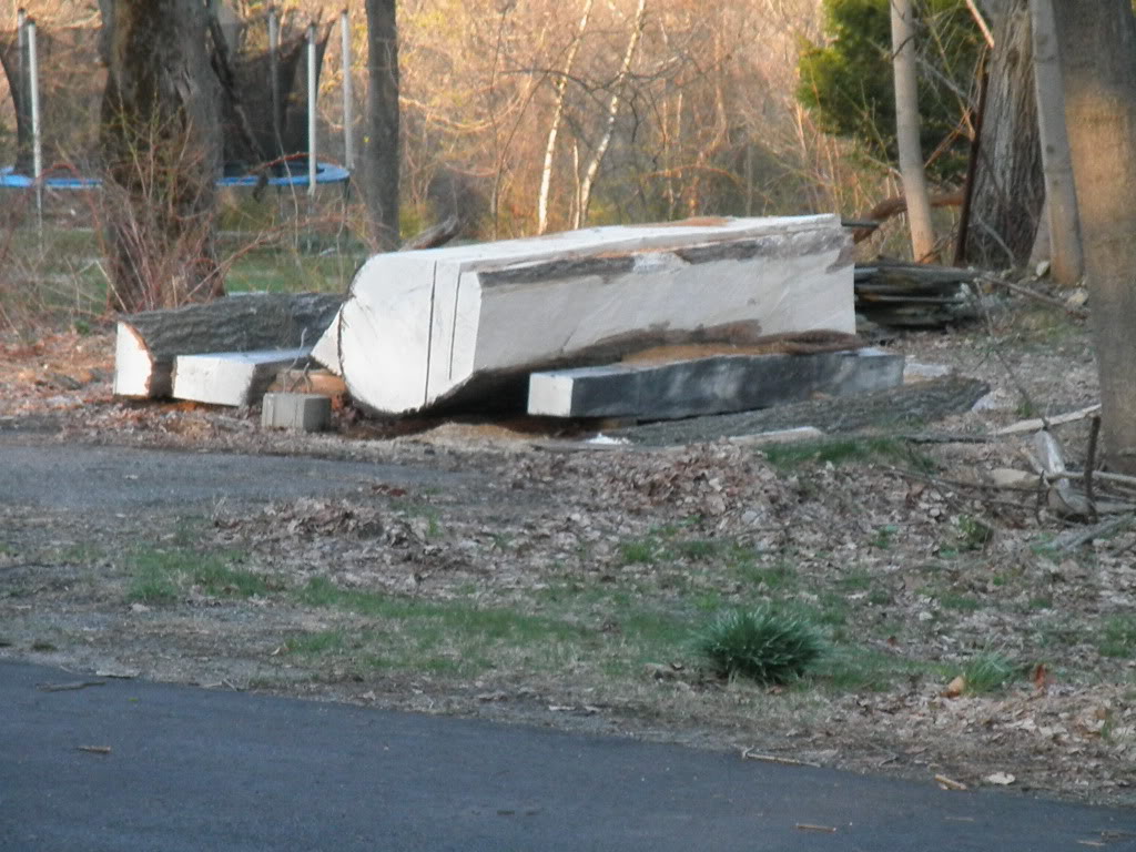

So this monster got felled. I've  taken half of it in already. It's better than two feet  diameter
maple-01.jpgHere is my little truck delivering a load
When the  job I did sawing the Cants is not so straight I attach this little frame to the bottom of the cant and drop my  band saw's fence to pick up on the frame and use that as my reference and guide.
After a couple passes I can usually forgo the frame.

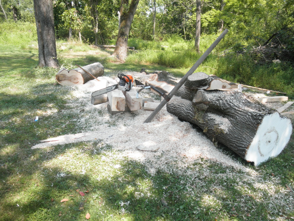

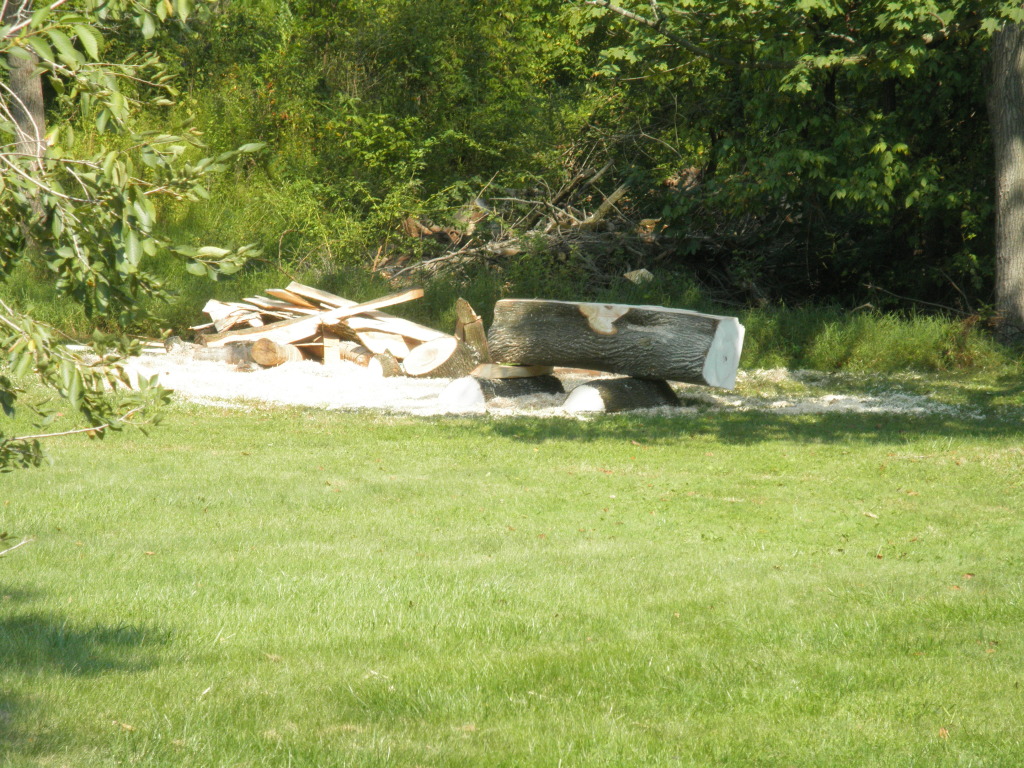

Here is my last log section.  It's about a ton and a half best guess.  I've slabbed  and squared three sides
How did I get it up there. No hoist, no machinery, no friends just me and a couple of sticks.

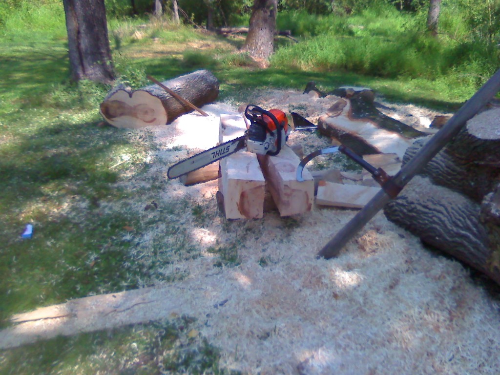

I cut 'em up like this barking and squaring 'em
makingcants-01-1.jpgHere is a pic showing my Peavy or log pole  or log  jack.  It's a   stick of wood this one is about 8 feet long.  I've wrapped it with  a piece of 3/16" steel to which I have an articulated hook. That muckles onto a log and I can roll it around with all that moment arm.

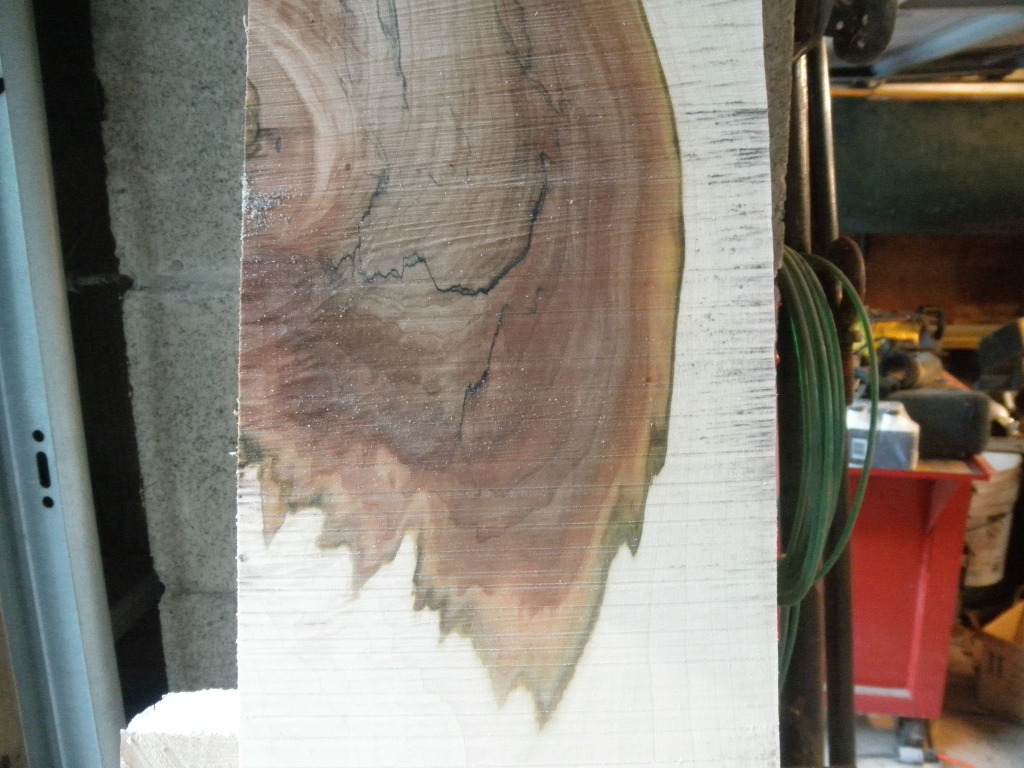

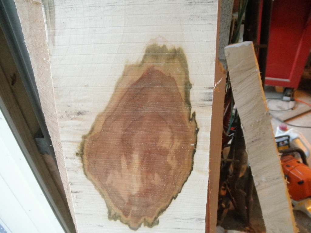

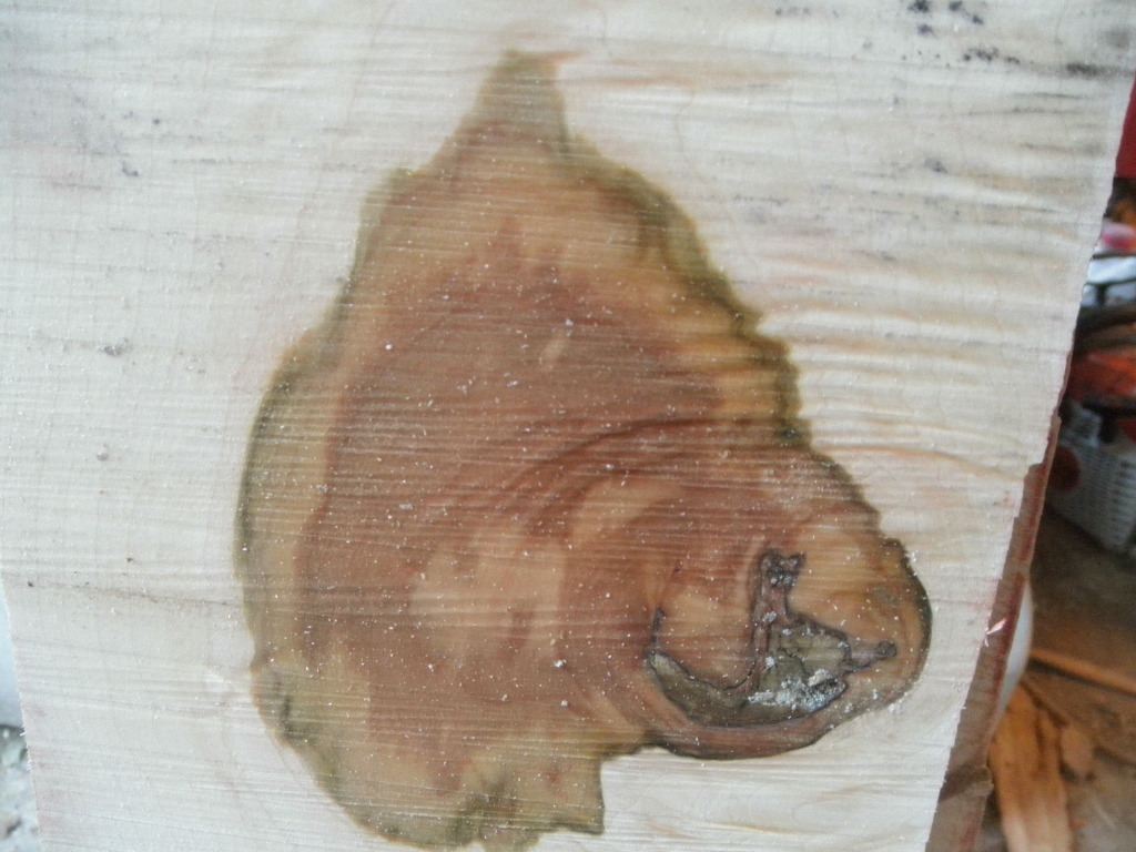

Here is some interesting color I found
